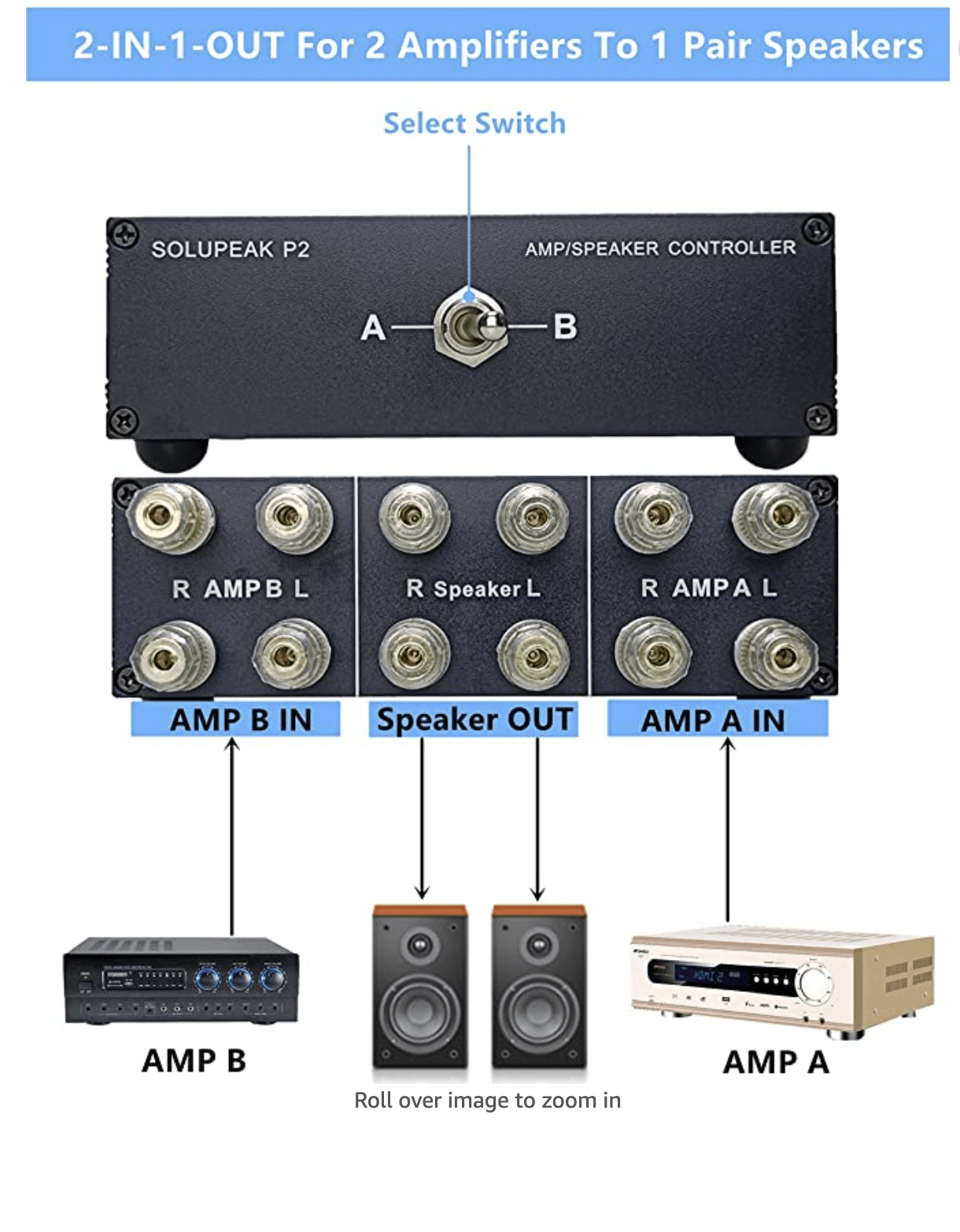

Apparently you have a speaker selector switch, and want to wire it backwards for use as an amplifier selector switch.
The switch can be even more of a problem. One mistake and one or both of the amplifiers will be shorted out,
and be severely damaged. I would not use the switch at all.
This is what I ordered. I would only use the switch with the amps turned off. You think the switch may short?
https://www.amazon.com/dp/B093GSS8P7?psc=1&ref=ppx_yo2ov_dt_b_product_details

And please, use dedicated speakers, switches can damage amps, that is expensive gear.
And if you must, add speaker protection circuits, or something similar to protect the amps.
My option is to have the stereo and the AVR system with separate speakers. Or to create a listening room in the basement. In either case would have to buy a new set of speakers. My wife is negative about this but at the end she accepts. She is quite happy with the Sonos speaker in the kitchen.
