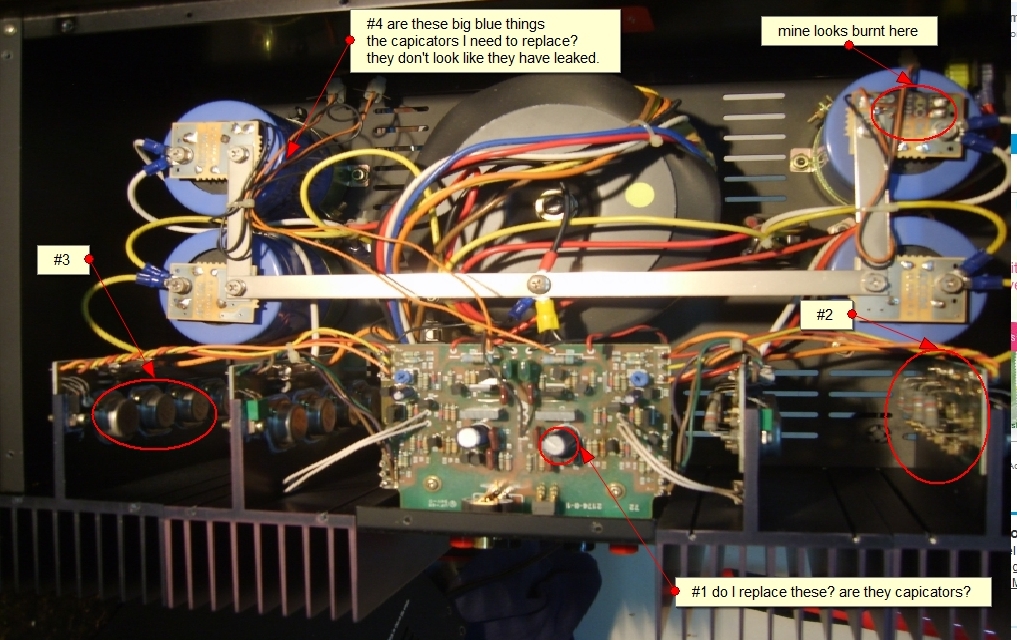

The big blue things( looking at your pictures) are the filter caps. They do not need to leaking anything or bulging to be bad. An easy check is to check the voltage across the caps. If its a 75 volt supply for example it will read +75 on one side and minus 75 on the other. Sometimes the caps will have the correct voltage on them until you try to pass program thru them and then the voltage goes down fast and this is a sure sign they are internally leaky.
If they do need replaced replace them with the correct size mfd wise instead of trying to go oversize thus causing more problems.
