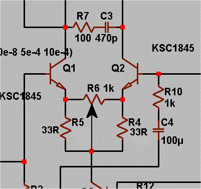

A very simple LIN amp , no beta enhancement on VAS. Someone drew the 33R on the pdf already .. ha 😀
(below 2) is the real solution (the trimmer-R6). The 555 , with heavy load of the one transistor VAS on the one "leg" of the differential has offset by design. The more advanced LIN amps (below 3) have both a current mirror and extra beta enhancement tranny at the VAS. Without the trimmer and without curve tracing - 1-2mv (or better) is the norm.

The original value selected by Nelson was 33.2 ohm for the long-tail pair degeneration resistors. I first set up a finely matched pair of the 2240’s in both channels (Q1-Q2) and thermally coupled them (Epoxies, Ect. PN# 50-3186RBK). There is already a position on the board for a second resistor (inverting leg) but a jumper is in place. I cut the jumper (right next to R3) and set up a decade box I had built with values ranging from 20 ohm to 60 ohms and measured the current going to the VAS and monitored the DC offset at the output terminals. I just happened to have some matched sets of the 33.1 ohm on hand to test and they worked very well. Further reduction of the DC offset could be achieved by hand selecting a value for R6 or set up a pot for adjustment as suggested by PB2. I know there are more sophisticated ways to deal with the front end of this amp. My approach was to keep it as simple as possible staying within the boundaries of the designer’s goal. There has been a much defined audible improvement in the amp and hopefully soon I can provide some real numbers to back that up. At present my HP 8903 is taking a sabbatical and hope to have it back up and running in a few weeks.

Q5's load is what adcom's "scheme" seems to be for LTP balance . Rather than denigrating any of the classic engineering 😀 , changing the collector load of Q5
(or degenerate the emitter - 33-150R)with a trimmer would allow for a fine tune of the load(s) on both "legs" of the differential pair. Remove the extra 33R if you want but I DO see this on my PDF of the 555 , the 33R may be a revision to the circuit.
