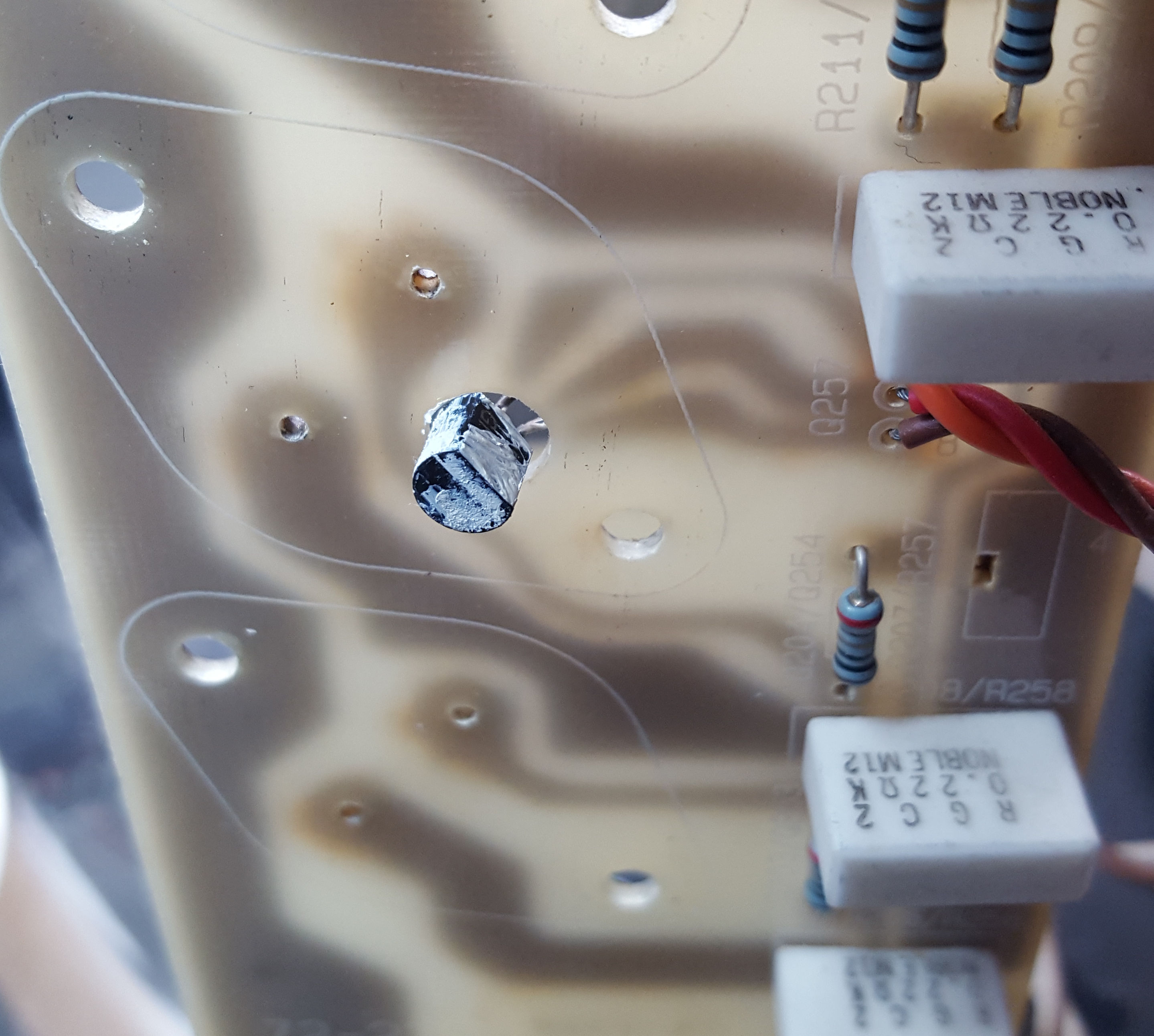

Hi. Got the parts, got some time and put the amp back together. Had real trouble with tired old traces on the bottom of the pre-driver board but finally got everything nice and tucked in. Checked all connections again. I had removed all power transistors on the right (bad side) and tested them and they were all fine. They were reinstalled with new sil-pads each.
I replaced Q106/156 and Q101/102 & Q151/152 (after using my new transistor tested to get matching units. I had previously replaced Q157 and Q107.
I put in on the variac and started bringing her up real slow and no noise/no hum and then when I got to about 60v something sparked down low on the right side power rails. I do not know what but I suspect that it was Q201 or Q202. It was late so I did not have the energy to take it all apart again. Damn! Could it be tightening them down too tight/too loose?
So, if it was Q201/202 I wonder if I messed them up when I removed them for testing? There is one bolt/nut that goes through the both holes and bolts it down to the heatsink. I made sure it had good sil-pad insulation under each. I am not looking forward to starting again.
I so want to get it running.

I've been reading this thread with interest as I just bought a GFA 555 II with a right channel problem. On my DBT I was unable to adjust bias on the right channel. At this point I didn't place a load on the amp but decided to find the bad components on the driver board.
I found Q158 2SC2912 was shorted B-E and replaced with KSC3503, and found R157 was dark in color was replaced with a 3.9KΩ 1/4W.
Powering up on DBT I was able to adjust bias on both sides now. I tested for sound on the DBT and got undistorted sound from a CD source on both sides, but have hum at zero volume.
My question is, where should I look from here?
I think I figured it out, the hum might've been caused by the rear bridging/stereo switch being in Bridge mode. I also attached some screws to the top cover that holds the driver board assembly and retested with another preamp, GTP-450, and have no hum. All is good, sound is clean after adjusting bias to 10mV.
