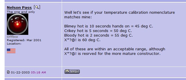

If amplifier is properly functional, besides temperature you don't need any other parameter ........ in fact , you need voltmeter to check on appropriate place, to ensure same Iq for both channels ......
Contrary to amplifiers working in B (AB) Class, where you need a scope and DVM to see/set to some prescribed more or less magical value, here you are asking about simple cranking of Iq ...... and looking at schematic and overall physical layout of amplifier itself, first boundary you're having is heatsinking capacity
so, conclusion is simple - temperature is your criteria

if you want simplest - no other change except increase Iq up to palm rule
if you want go further, change of mains xformer
but, accounting on needed output power, heatsinking capacity (W) and reasonable dissipation per output part
