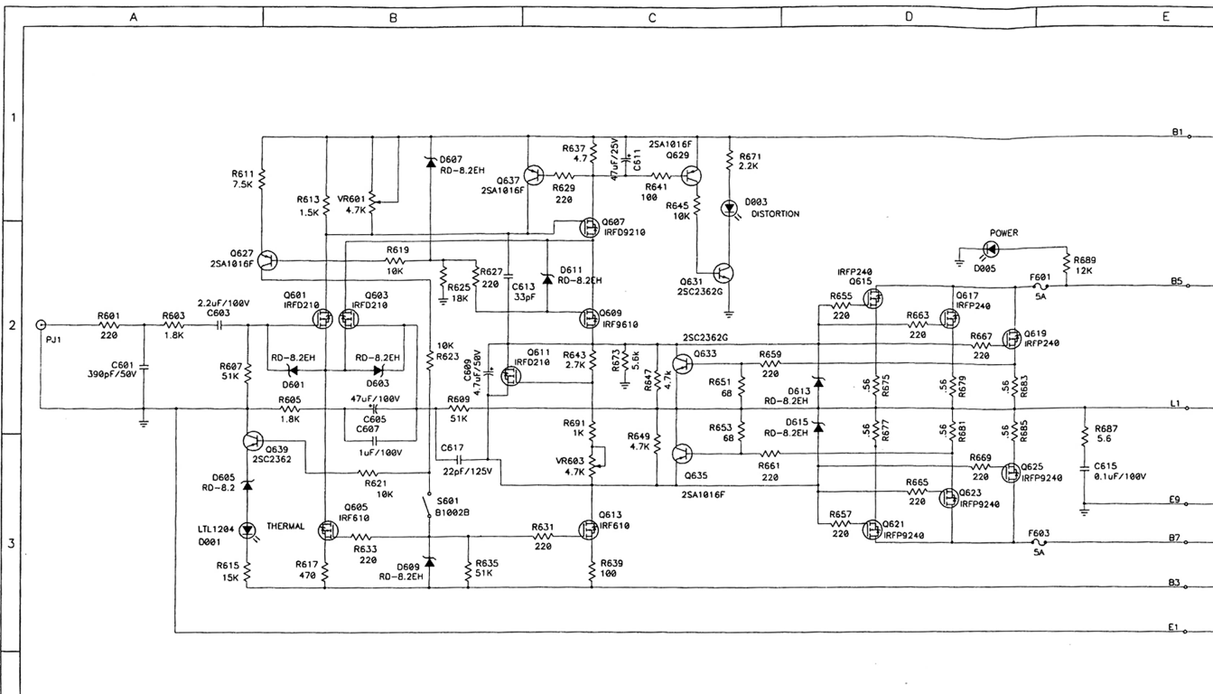

Luis, do you have an update?
Could it be a bad electrolytic cap on the L channel amp board (feedback cap C605 in particular)?

The GFA-5500 is known for issues with cold solder joints on the IRFD210 mosfets that make up the input LTP. It causes weird noises to come through the output. I guess the 5400 might have the same issue? These FETs get pretty darn hot and eventually the solder joints fracture.
The fix is to re-flow these solder joints. Then, attach a DIP heatsink across the two fets. This not only brings the heat down to a reasonable level, but it also keep the pair at the same temperature. Attach with thermal epoxy or JBWeld Original Slow-cure. Heatsink is Aavid 501200B00000G
