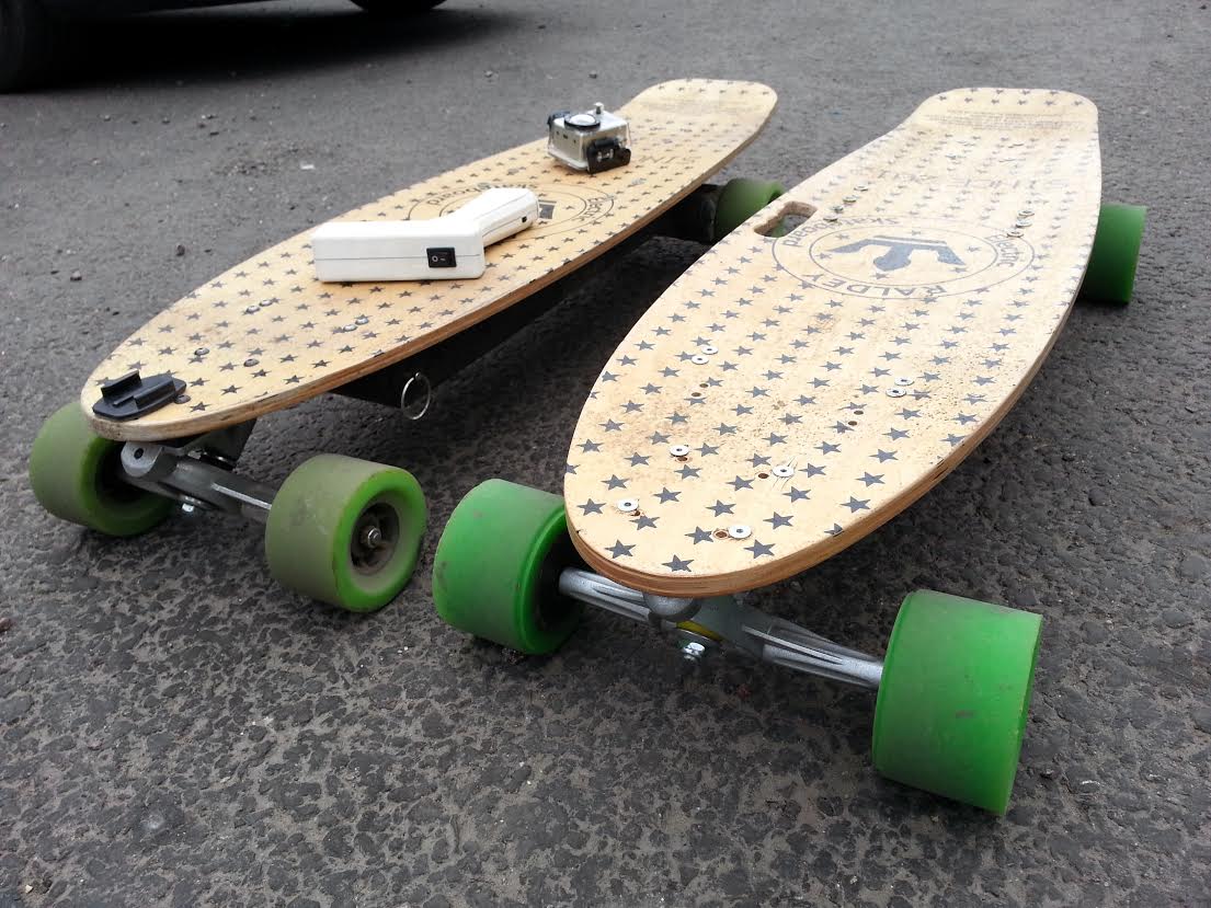

Example, not related to audio equipment, but very representative in my opinion.'
I've got an electric scateboard, designed and produced in China. It's a tough built board with top quality 500W brushless motor, Li-ion battery and electronic regulator with radio-channel for precise remote throttle control. It's the third year now I use it frequently in tough conditions practically without servicing, and it works perfectly - electrically and mechanically. Bravo China! 😉
Sorry for unwitting advertisement 😀

I get into way too much trouble on motorcycles. But that does look like a seriously fun toy. I was looking at hub motors from China to build a custom electric trike. Never got around to it, but very impressed with the quality and performance of their offerings.
