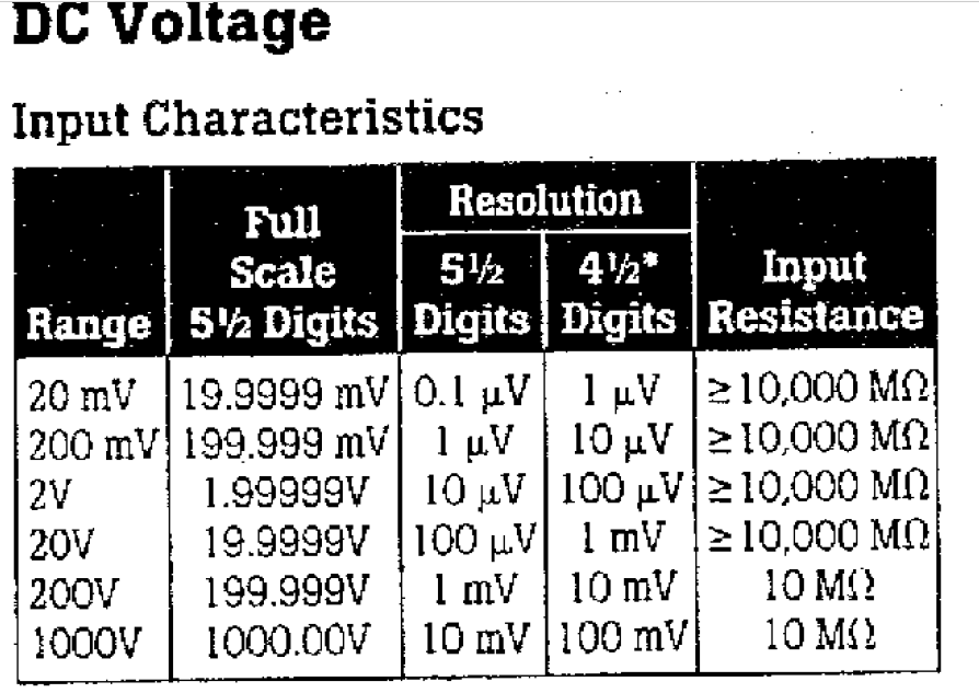

That said the Fluke 8840A meter I used to measure the voltage has the following specs.
So if I'm reading that right, it would have minimal loading.
Agreed, 10G ohm is negligible load, so I tend to believe your measurements. But you didn't say what voltage you observed, or if you measured between pin 2 and 3. Assuming your readings are consistent with the readings in post 3, the opamp sure looks suspicious.
