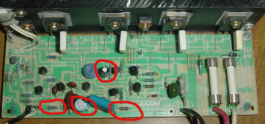

I just received a great Adcom 535 Power Amp as a gift. A friend bought it on ebay and had it sent to my door. Very cool gift and great friend.
Anyways, I'm wondering if this is stock. It looks like it's had a couple of caps added. I have no idea if they were original or a Mod of some sort. Curious on thoughts. This is one of my first Hi Fi amplifiers.
thanks!!
Nick

NOTE: the red Poly cap soldered in the same hole as the resistor at the edge of the board.

I don't have a schematic, but I've seen the innards of a few Adcom pre and power amps.
Some literally looked like an accident, or at least a prototype. So those two caps that seems like they've been put as a modification, could very well be from the factory.

If you look at schematic for the 555 you'll see two electrolytics, a large one in the F/B circuit and a smaller one in the bias circuit. The large one is bypassed by a .1uf film capacitor. Now look at the picture of the 535 board, if you check out the components around the large electrolytic all of the values are the same as the 555 and appears the film capacitor was added as the bypass after the board was made. Also there are many empty part locations, less outputs and associated components, probably the same board. Anyway that's WHAT it is, how,who, when, and why are still the questions. I wonder if the original 555 had the bypass?

wow, I just noticed the fuses on that thing!!!!!
if that thing blows, it takes everything with it
I would replace those fuses with correct ones if I were you

I had read here on this forum that the B+- fuses to the power transistors can limit the current to them resulting in poor sound quality. Especially with corrosion on the terminals. I read a few people saying that it sounded better with them jumpered. So, that part of the amp is definitely non stock. Good eye! I saw the two red caps and that was what I was wondering about mainly. I'll have to give it a good look over.
My thought on the fuses is what are the chances the power transistors are going to go bad. In the case they do the current will pop the main fuse (hopefully). Most audio amps I've seen don't fuse the power supply to the transistors. So I figured that since the point of this thing is to sound it's best, I'll change parts if something does go.
Those caps are on my unit as well (sorry, I'll have to check the schematic later). Those are stock as I bought mine brand new and never modified.

Hmmmm , The fuses might be there to prevent a fire hazard , or to keep the phenolic board from actually burning up. My screwdiver recently slipped and instead of having 8 burned OP devices and exploding screwdrivers
Or at least a slightly over-rated fuse would offer "dead- short"
fire /PCB protection.

I can tell you from experience that those fuses are there if the speakers are shorted!
One of my stepkids, that to this very day has not confessed, but they removed the cables from the speaker binding posts and put the + and - of one channel in contact with each other. I found the cable sitting on the floor. I immediately hooked everything up and the left channel was dead.
I opened up the amp and one of the fuses had blown. Got a replacement and I was back in biz. As you can imagine, I raised holy heck and nobody has touched my stereo since that time.
