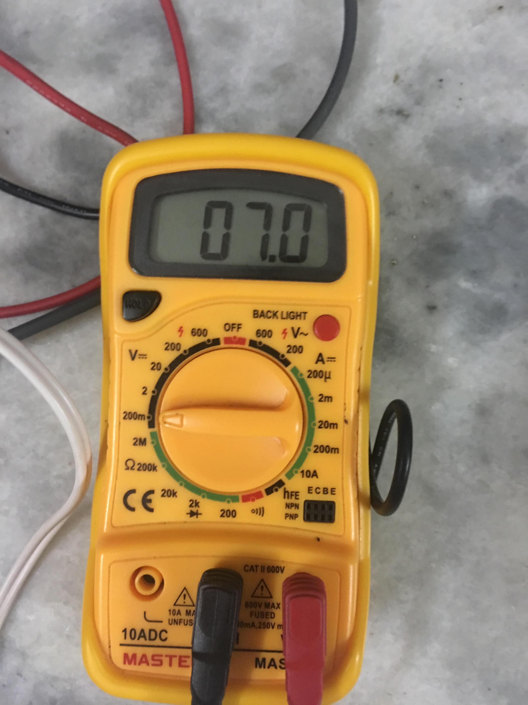

I do have a multimeter with me, i have managed to find the pin out digrams on the PCB, and have started to measure the DC Offset Voltage.

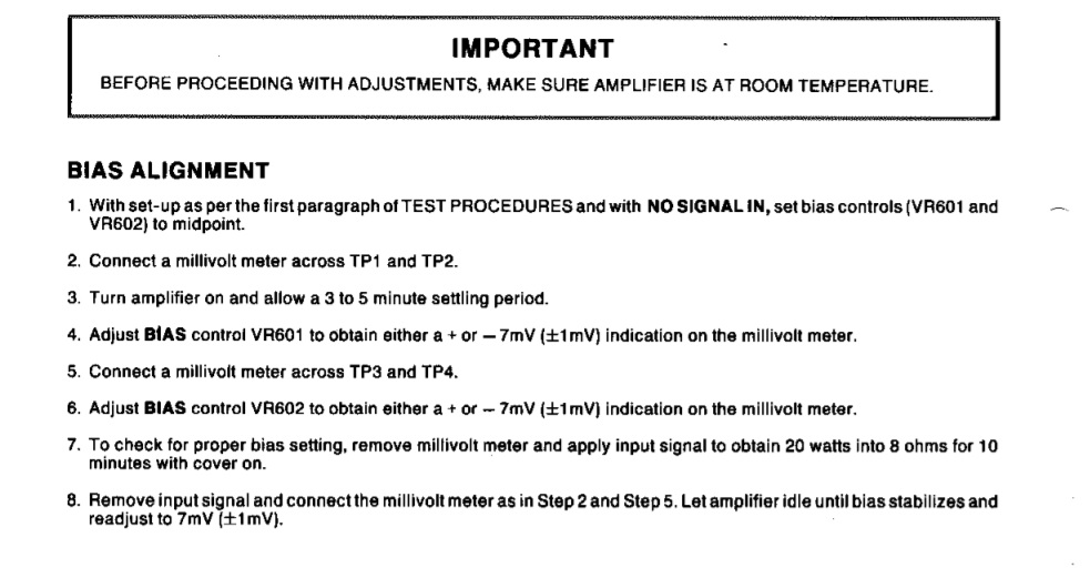

Please find the instructions for bias adjustment in the attached image.
I have have also attached my multi meter reading for you to verify.

Looks like you have it all squared away.
DC offset should technically be zero but it might be tough to get exactly that. Anything less than 25mV is more than fine but you probably won't be anywhere near that.

The official bias adjustment instructions for the Adcom 535 MkII have you warm up the amp by playing 20W for 20 minutes, with the cover on. Then you should remove cover and adjust the bias for 7 mv across the relevant test points as soon as the bias stabilizes. But what is stabilizing???
At the outset, my amp reads about 8mV quiescent after a couple minutes warmup and basically stays there with the cover off. But after I run the 20 minute warmup, and take the cover off (I had it turned upside down and then block the sides with large aluminum dummy loads) the bias now measures 3.66 mV and rising. In 2 minutes it has risen to 4.94, then in 5 minutes to 6.03. Some time around 20 minutes, it returns pretty much to the quiescent cover off level of 8 mV.
So is "stabilizing" what you measure pretty much as quick as you can get the test leads on it, or is stabilizing waiting 20 minutes for everything to cool back down again to quiescent level. If the latter, the warm-up procedure seems to make little sense.

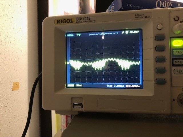

But it appears my low level THD+N is power supply related. The glitching appears at what appear to be 180 Hz intervals regardless of input frequency. So I'll guess it needs new power supply caps. (I had trouble reading my new Rigol scope at first or I would have seen that right off.)
The little frequency related harmonics in the analyzer may be quite small, just as at 10V output.
After about 90 minutes, with my simulated "cover on" (cover upside down with sides blocked), bias cranked all the way up has fallen to 14mv at the testpoint, heatsinks can be touched for no more than 10 seconds, my flaky IR measures 130F. My analyzer is overheated for today, anyway this is pointless until I fix the 120-180 Hz modulation. Showing the distortion output (can't remember the signal frequency, probably 1khz, but scale is 2ms/div, I think that's what Rigol means by "2 ms"). The photo was taken earlier when my analyzer was still sane, I think it was at roughly "8.5 mv" bias level, and 1v amplifier output. Can't retest now.
