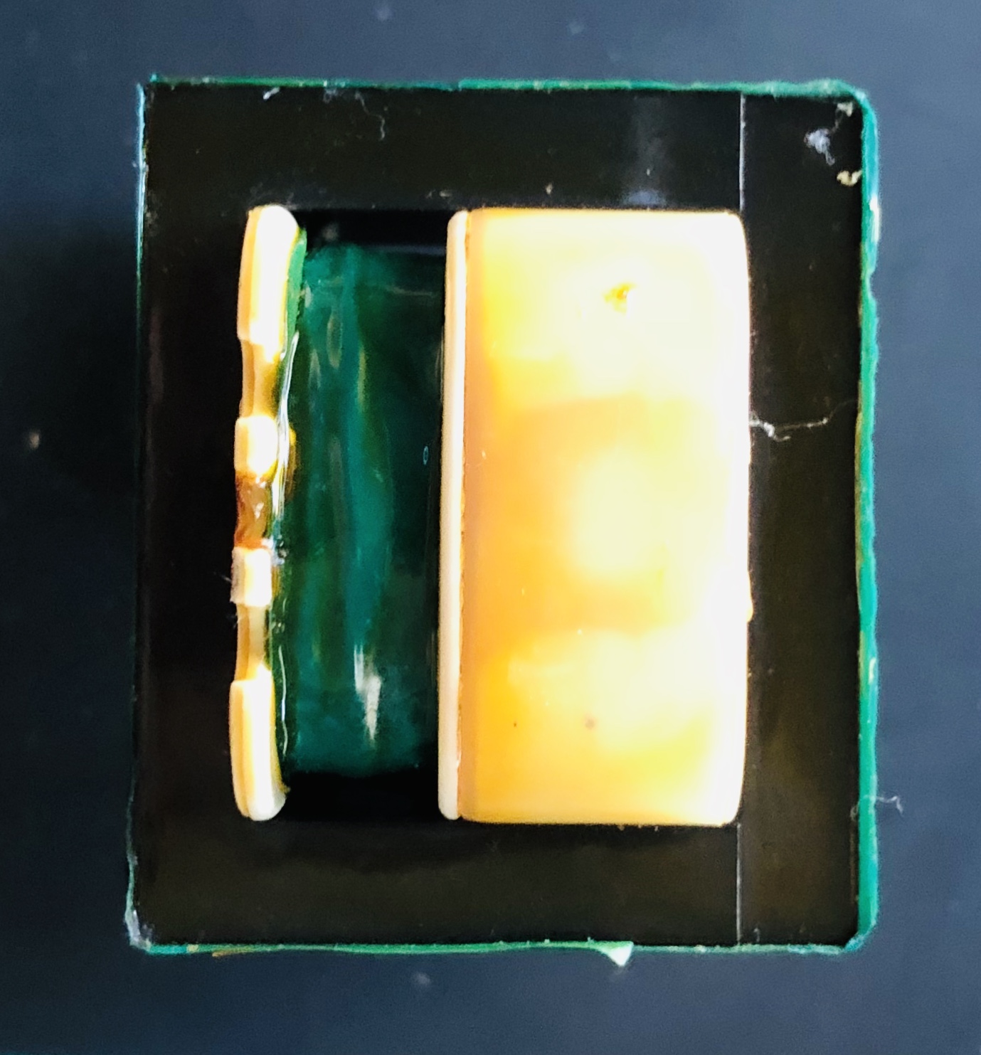

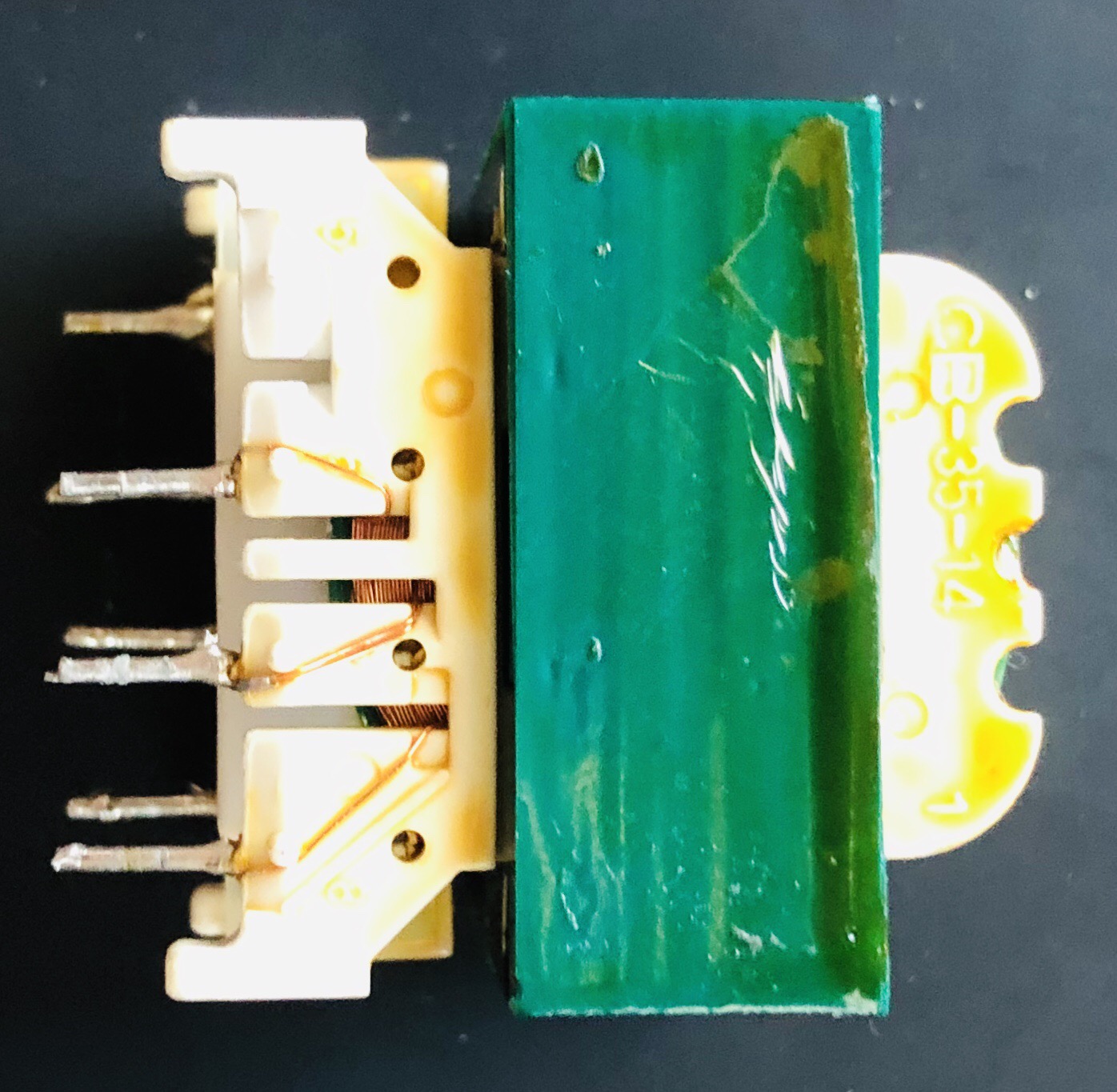

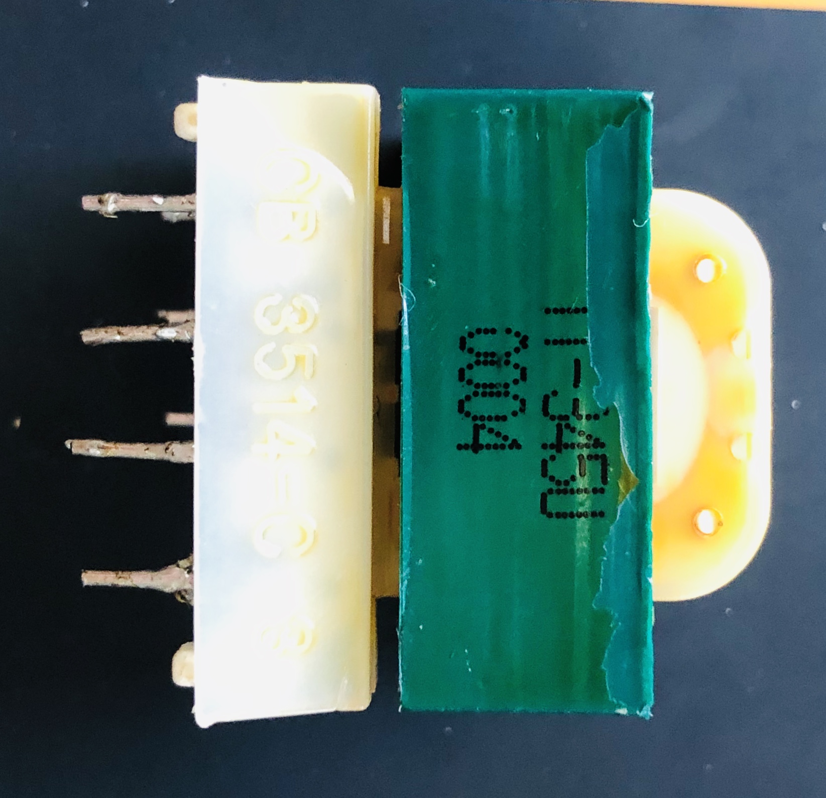

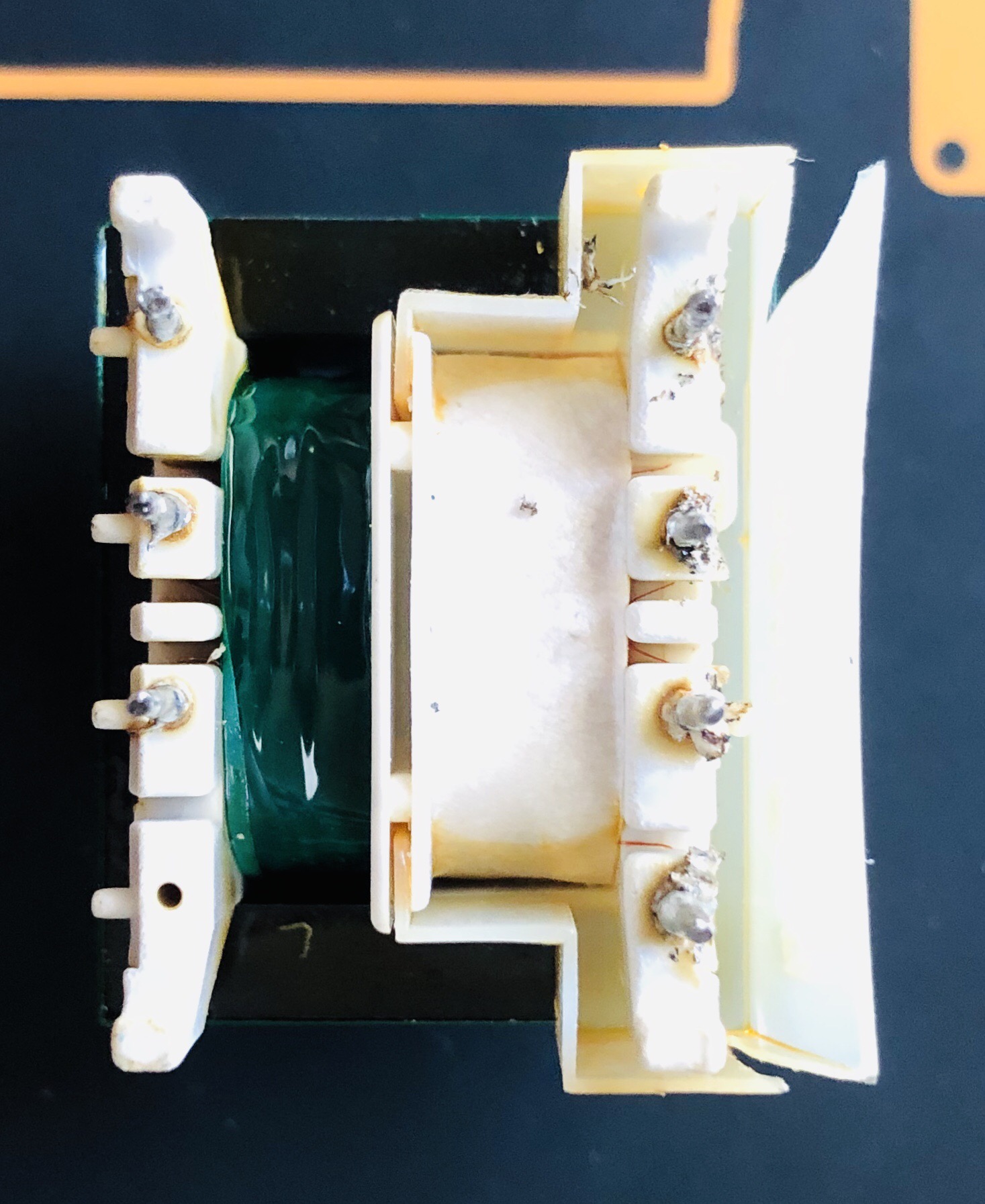

Thank You Everyone who chimed in, after contacting every ADCOM part source and being told that the part wasn't available I got myself an extra bucket of patience and I was able to fix the transformer.
Now this little amp is back to life.
