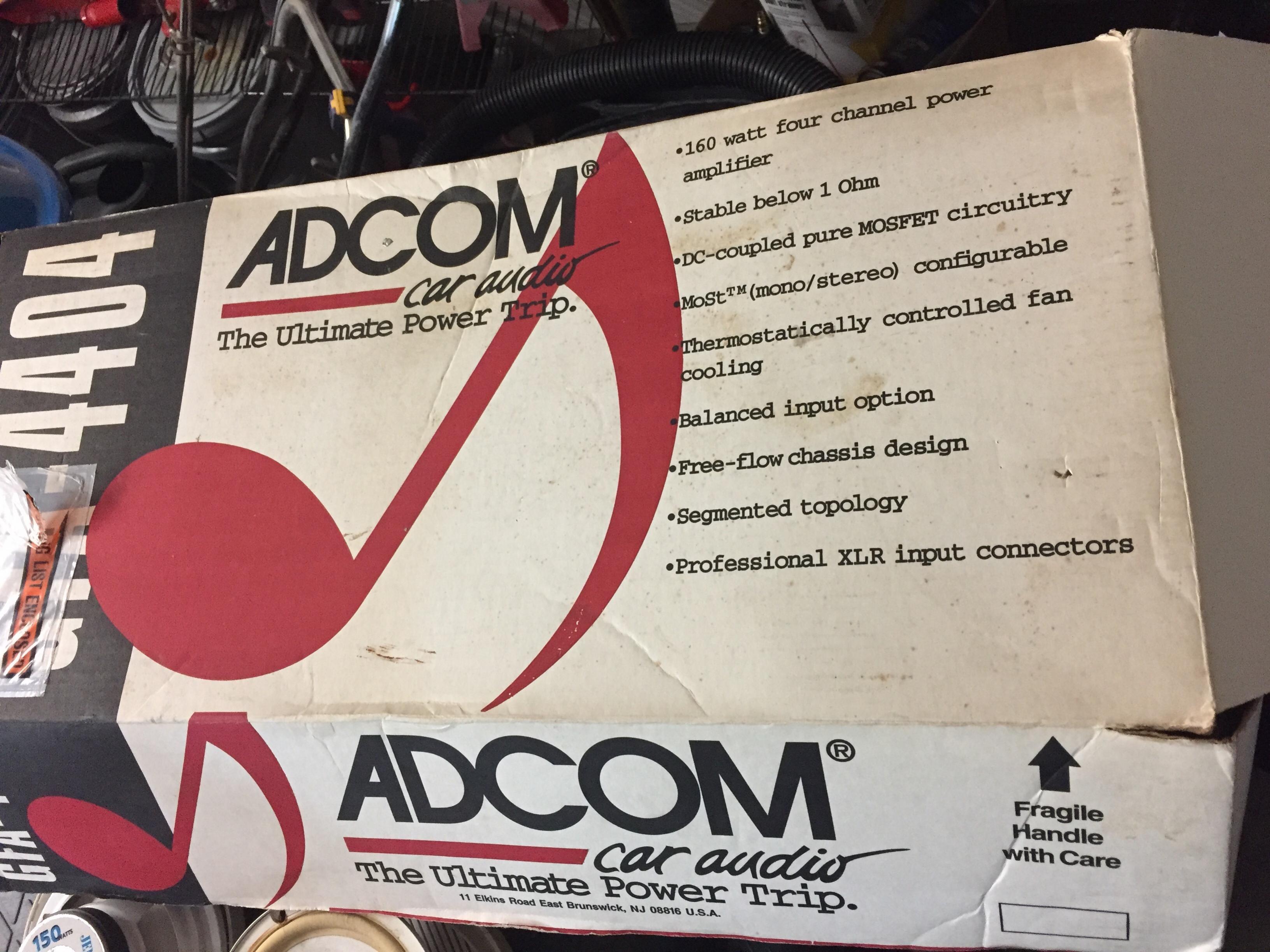

So I wired channels A and B to two pairs of door speakers - so thats Four x 6.5" door speakers paired in parallel per side. Each channel A and B is seeing about 2-ohms this way.
Channels C and D I bridged, and am running a single 12" woofer wired at 2-ohms (DVC in Parallel) - and the amp is seeing about 1-Ohm per channel on C & D.
With the sub not running, I can get the up to about 90% volume capacity on the head-unit and it sounds great. When I introduce the sub, I can only hit about 75% volume capacity before channel B clips. Channel A is not clipping. I don't know if the sub channels are clipping - its hard to tell and I don't have my equipment anymore. Why is channel B clipping?
Is there something wrong with this amp or has it just not the guts?

Are you sure it's 2 ohms stable as well as 2ohm stable bridged?
Sent from my iPhone using Tapatalk
Well, that's a thought. I actually have the box for this ancient thing which proclaims <1 ohm stable. Picture attached. The manual also seems to indicate it's stable down that low also.

As well as it outputs 40watts per channel is that enough for your power hungry bass speaker? As well as trying running the 6.5" speakers in parallel even tho that would mean the power would be cut to half and run the dvc in parallel
Yes, those amps were more about fidelity than pounding.
I have a Nakamichi system that is a keeper. Minimum 4R per channel and it sounds great. Pounding? Why would I do that? It was bought for sound quality. The McIntosh amplifiers are along those same lines.
I have yet to hear an amp designed for pounding that sounded good in a music quality way, so that is your choice. You're just asking it to do things it wasn't designed to do.
