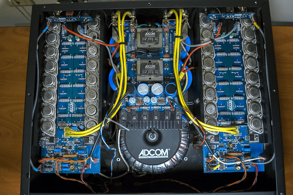

I was hoping I could get some opinions on this Adcom 5800 restoration kit. Cost is stated at 295.00 (make an offer).
https://www.ebay.com/itm/1656357443...jyrKVaT2T3usOX53luZLTpFOsQ==|tkp:BFBMpJL6v-pi
It does not seem a super far-fetched price for everything that is included, just in my opinion, and of course it would be a timesaver in-regards to having everything in one package instead of researching everything myself, and searching out all of the part numbers, parts, etc.
The one thing that I do question is the kit has 22000uF capacitors instead of the 24000uF is that came stock in the unit. I also inquired if the transistors are hand matched, and the seller stated they were not. I had looked up for a replacement 24000uF capacitor, and I could not find any around that appear that they would work and the seller said that is one of the reasons he dropped the capacitor, micro farad range down to the 22.
I have placed the description from the seller of the kit below in case people rather read it here than searching through the eBay ad itself.
Any opinions, thoughts, etc. on if this kit seems to be worthwhile would be greatly appreciated. Thank you very much for your time.

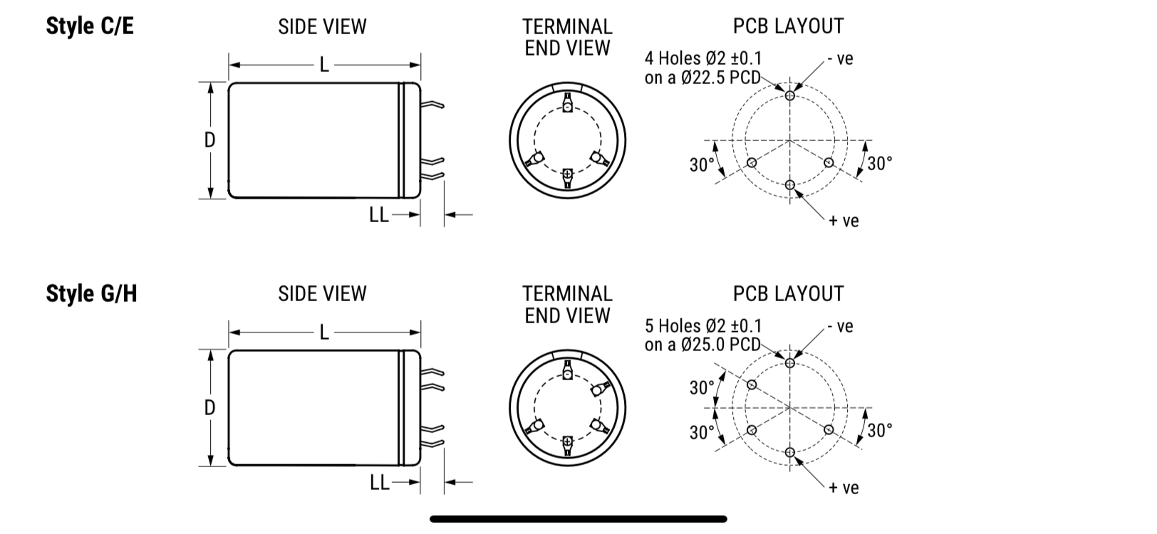

I was just looking at snap-in capacitors with multiple legs and was wondering if it’s feasible and/or actually doable to snip off the non-voltage carrying pins and solder the two that are remaining?
So, as an example from the attached photo. To snip off the two or three legs from the capacitors shown in the photo, and then get the capacitor inserted and solder the two legs that are needed.
The stubs could short to traces or planes in the board. Best to use parts with the correct footprint.
