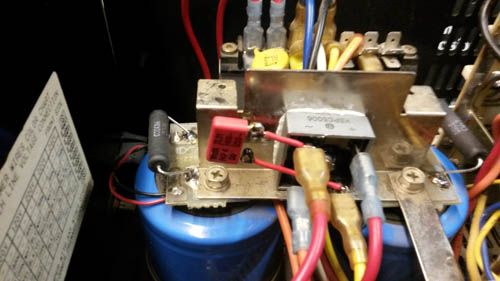

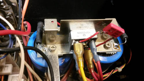

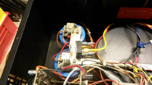

I picked up these two amps that are in excellent condition inside and out and it doesn't appear to have any cap problems yet so I decided to do it myself rather than go thru the pain of shipping them again.

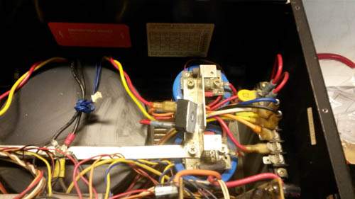

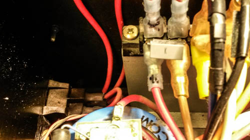

So far I have replaced C806,7,8 & 9. I have a 50a at 600v bridge for a replacement and some 4.7K ohm AT 7watt bleeders that I am waiting for. I need 4 .o1uf at 400v or so X2 long lead that are hard to find if anyone knows of a source let me know.

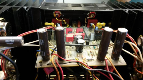

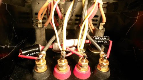

O.K. so across the secondary I don't need the X2 caps (thanks guys) so I put two .01 400V wimas across the AC lines. I will change the cap across the primary on Sat. It's a ceramic now and I want to replace it. I put the amp together and fired it up and dead quiet I let it sit for a while and will proceed to the 4 output boards next. I am trying to organize this so I don't have to disassemble it any more than I have to and I am going to run it after every stage so if something happens I can narrow it down. Due to my limited knowledge I have to be a careful as possible. I have gone over the mods time after time and I believe I have everything down except for the four bypass electrolytics that go on the input board, I can hookup the two end ones but don't know which traces are for the two center ones. All four go across the inside edge of the board.

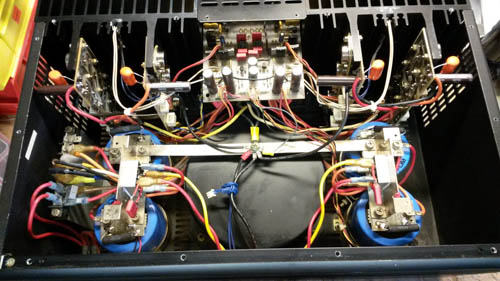

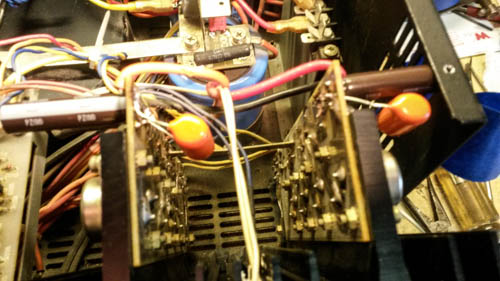

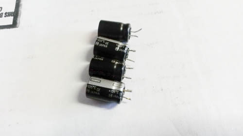

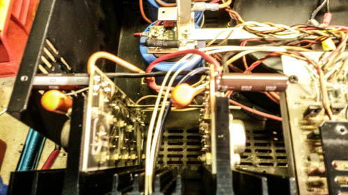

Here we are today. The X2 caps I tried to get with the long leads actually came with them, not as described at all. I replaced the little caps you see that are 47uf at 160V with 120uf at 200V and bypassed them with 22uf at 600V orange drops. I also replaced the Ceramic bypass cap on the mains with one of the X2 caps. I am debating if I need to get to the bottom of those 4 boards to replace the 68pf at 500V film that are there with the same thing.

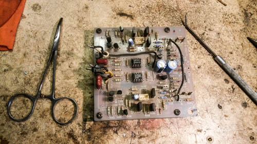

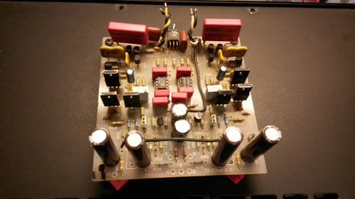

I got to the bottom and replaced those caps and have moved on to the input board. At first I thought I might be able to work on it without removing it but no chance. I numbered every wire going into the board and the board is also numbered, a little labor intensive but not too bad. No way I can work on this without a board holder. I finally mounted the board on my bench and got my fly tying magnifying glass and light hooked up and can see what is happening. I pulled 90% of the caps and the two trimmers and employed my solder sucker to good use. Nice clean board now.

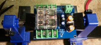

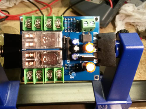

Still waiting on the final stuff from Mouser but these came in the mail today. Little DIY speaker protection boards from China, about 3x2 in. fit nicly in the bottom of the amp and ea. one controls 2 speakers.
