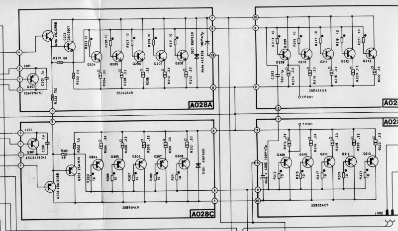

KaLok said:4 pairs toshiba TO-3 per channel
Must different amp then, because schematic shows 5 pairs.🙂
Hi Peter,
Is your circuit is 585? It is 5 pairs per channel and 250W each.
I only count 4 pair each channel????😕

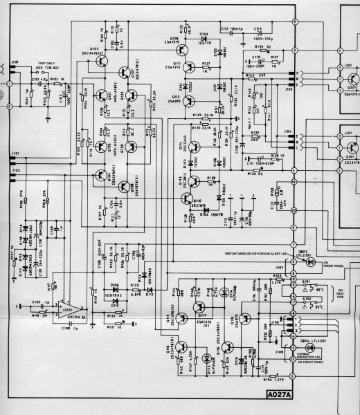

Adcom 2A
This is the only marking it has in manual. But I wouldn't worry too much about it and use any other op amp that fits there. BTW, transformer an PS caps are also marked with Adcom code.

The GFA585 looks just like the 565, just half the number of outputs.

Just for the record, I don't recognize the schematics
posted. I surmise that the circuits were developed
in-house at Adcom.
