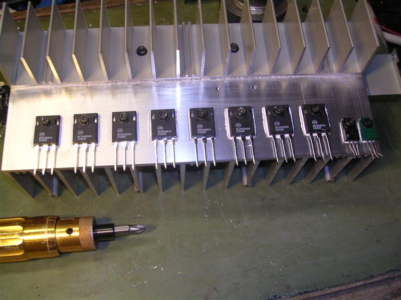

hi all i have my adcom 555 up and running and i thank you all for your help.but i have another question i;m greatfull for your input.do you think i should replace all the transistors in the driver board if so what band do you suggest nte-on-fairchild ????.also if i put disc capacitors on the power caps would this give me better bass what size.if so what values would you suggest to use thank you

Hi changsecho,
NTE? What is it really? Date code? Batch number? PRICE!!!!!!!!!
Fairchild? Please, tell me why you would install devices that the circuit was not designed for, or completely unknown parts? I am kinda shocked here. No good audio tech uses NTE or anything but original parts or suitable substitutes. Only TV techs and industrial maintenance guys use NTE because they do not understand how linear circuits work.
You can check the matching of the input pair and replace with a matched pair if you understand how to match those devices. If not, you had better leave well enough alone. Output transistors require matching. This isn't a "would be nice if" thing, this is a "must be done this way" thing. If you don't know how, same advice as above. Even applying heat sink grease seems to be an art (not really) because of the number of units I see with this improperly done. Hmmm, that means they were serviced and they failed again. There must be a connection here.
I normally don't do this, but I recently repaired a Citation 22 that came up from the 'States. Not working. It failed very quickly. So here is a picture of the channel as I removed it from the unit.
-Chris
Edit: Notice the obvious fake part, it had the right number. 🙄
