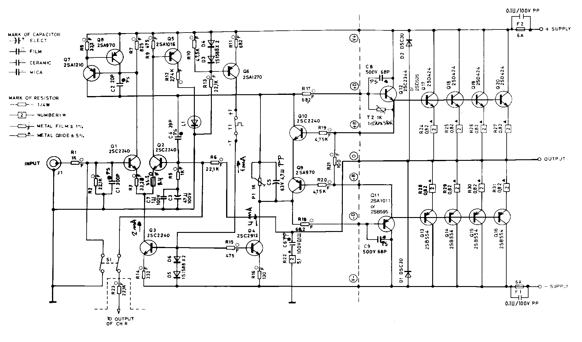

What are the voltages on the bases of Q101 & 102? Is the op amp pulled? If not, what's the voltage at pin 6?

Thanks for the schematic AHT, but the one you posted is for the
555. My problem is with the 555 II which is slightly different.
I do have a schematic for it.

Hi Barry,
Right on! Match the diff pairs while the unit is apart. Your base readings are something I am looking at. The rise to 0.138V tells me that something is drifting. We don't want it to come back to play. The op amp output reading confirm this. If the diff pair looks like it's matched (both come to the cal mark with little or no beta cal change) then I'd be testing the other transistors in that channel.

Hi Barry,
Sounds like the current source (Q105). An intermittent thermal switch (S101) would do it too, but then the thermal LED should be on.
Test points are :
Q101/102 emitter should be -0.6 V ish (collector Q103).
Q108 should be biased on, collector voltage -1.8V ish.
Voltage drop across R114 / R115 - both approx 0.6V **watch out, neg. supply potential.
Voltage drop across R110 around 0.6V ** watch out, pos. supply potential.
Let me know what you find. If you think it's fixed, run it for a few days with 10R resistors across the output. 1/4W as these are "witness" resistors. We want them to burn if the offset appears. Inputs shorted.
