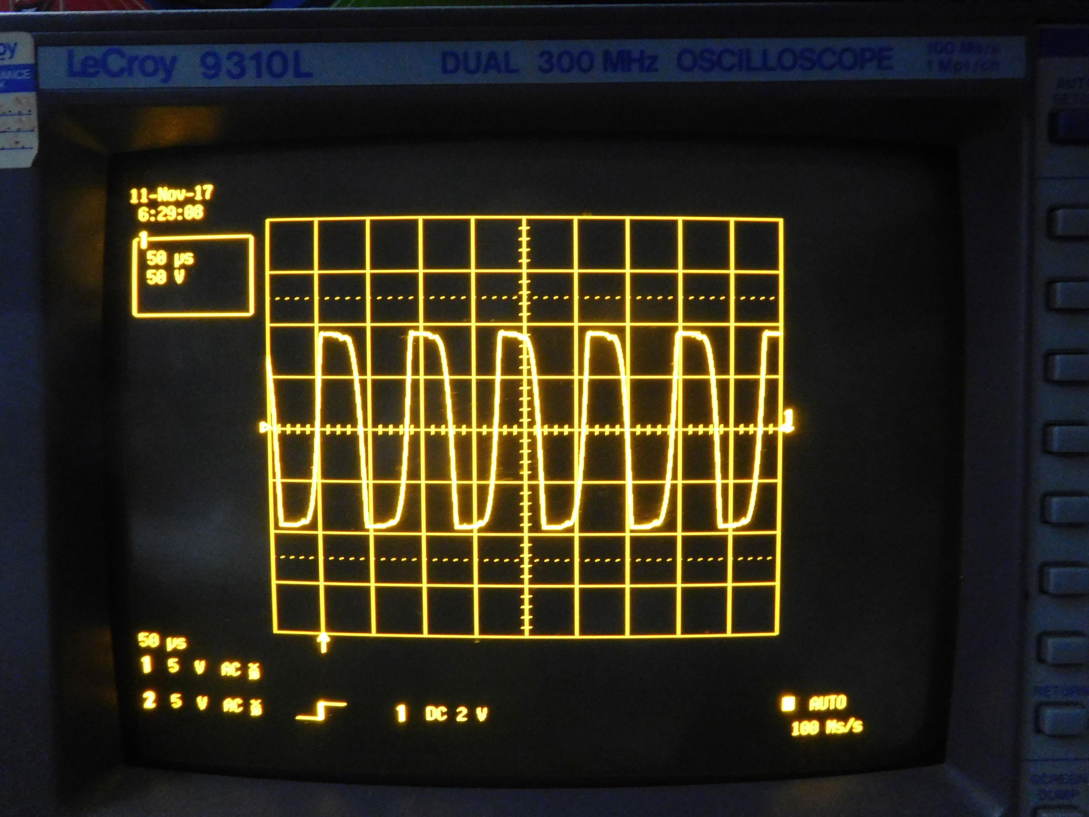

It's oscillating.
If you aren't a technician (nice 'scope by the way), I don't recommend you try to fix the amplifier yourself. It also will suffer from leaky capacitors that makes an invisible film on the board and components that eats the leads, eats the copper traces and is conductive. There are two things you can do. There are some new driver boards that were designed, just replace the old boards with these. The other path is to remove all the electrolytic capacitors and components in those areas and begin cleaning the board. The last one I did required 5 cleaning cycles and if those new boards had been available, I would have used them.

Thank you for your answer .. the technician isn't my work, but I repair from 30 years, more for passion, for friends. The capacitors are changed, and board it is cleaning, but I understand and I clean it other time.

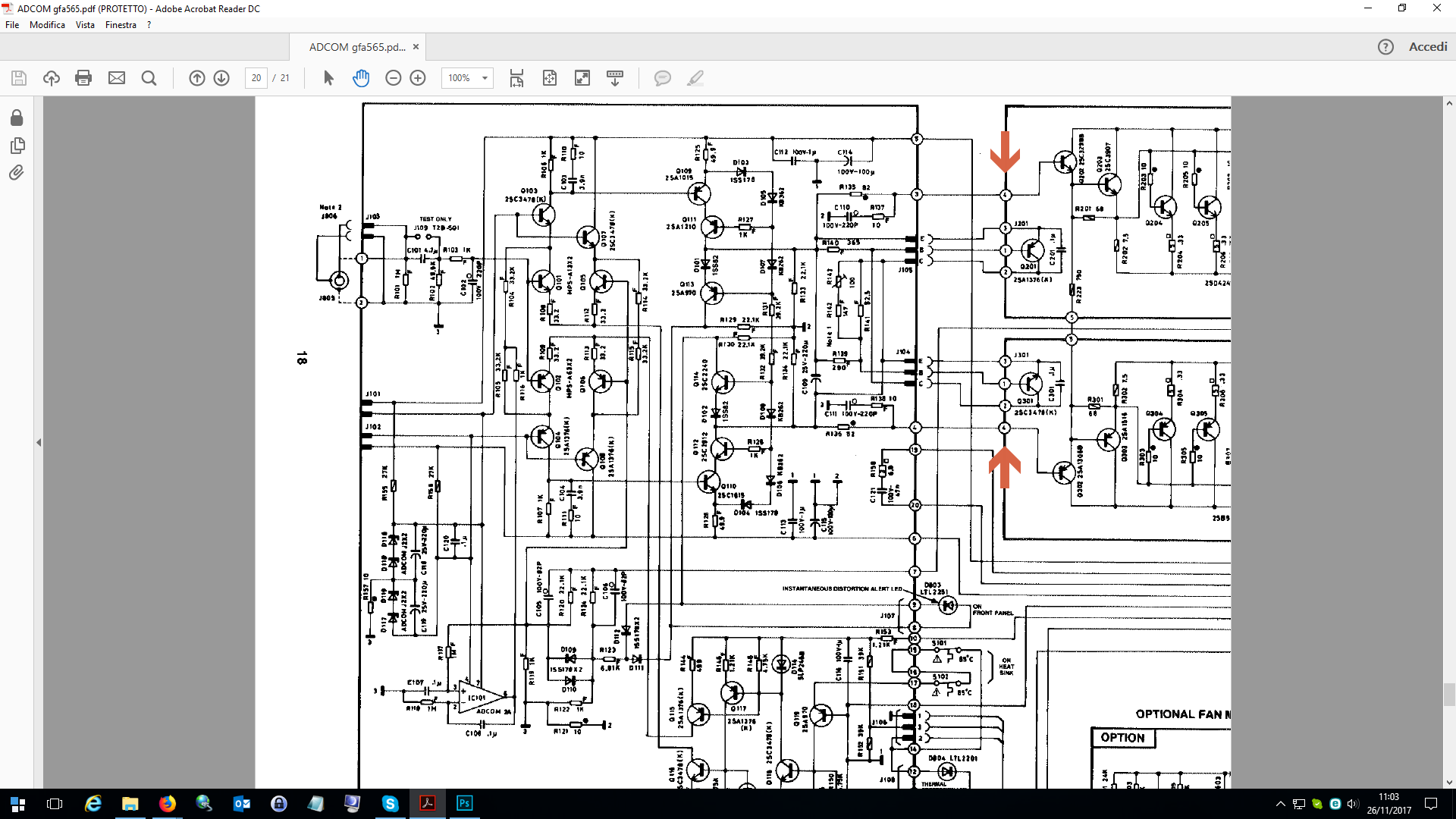

Hi.. after some work now the amplifier work good without final transistor.. From input to the pilot working fine.. I have a question. I have mount ONLY ONE PAIR final transistor.. to try it, with 3 amps fuse and without signal and without load.
I use in series to mains a 200 W lamps, when I turn on the mains switch, the voltage on power cable of the amplifier go on until 140 V and then you can listen the click of the bypass relays (power resistor in series to mains), and then the voltage go down until 90 V. Considered 200 W lamps, and the voltage on a load, 90V on 240 V total, the result is 150 V on the lamp and 90 V on a load and considered the power comsumption of the lamp 200 W 150 V, is how the amplifier to have a 300 W of comsumpion.. WITH OLNY ONE PAIR OF FINAL ??? It is possible ?????

Yes it is possible to only use one pair of o/p's to test out the amp but do not load the amp very much.
Thank you for your answer Rsavas, but have you saw my link you tube ? There is a hard load in a mains, the voltage go down.. have you read all my post ?
In the final... after changed the broken transistor with other new, when I going in power, some transistor going to broken, and then, after replace all final transistor with MJ21194G and MJ21193G now work fine !!
