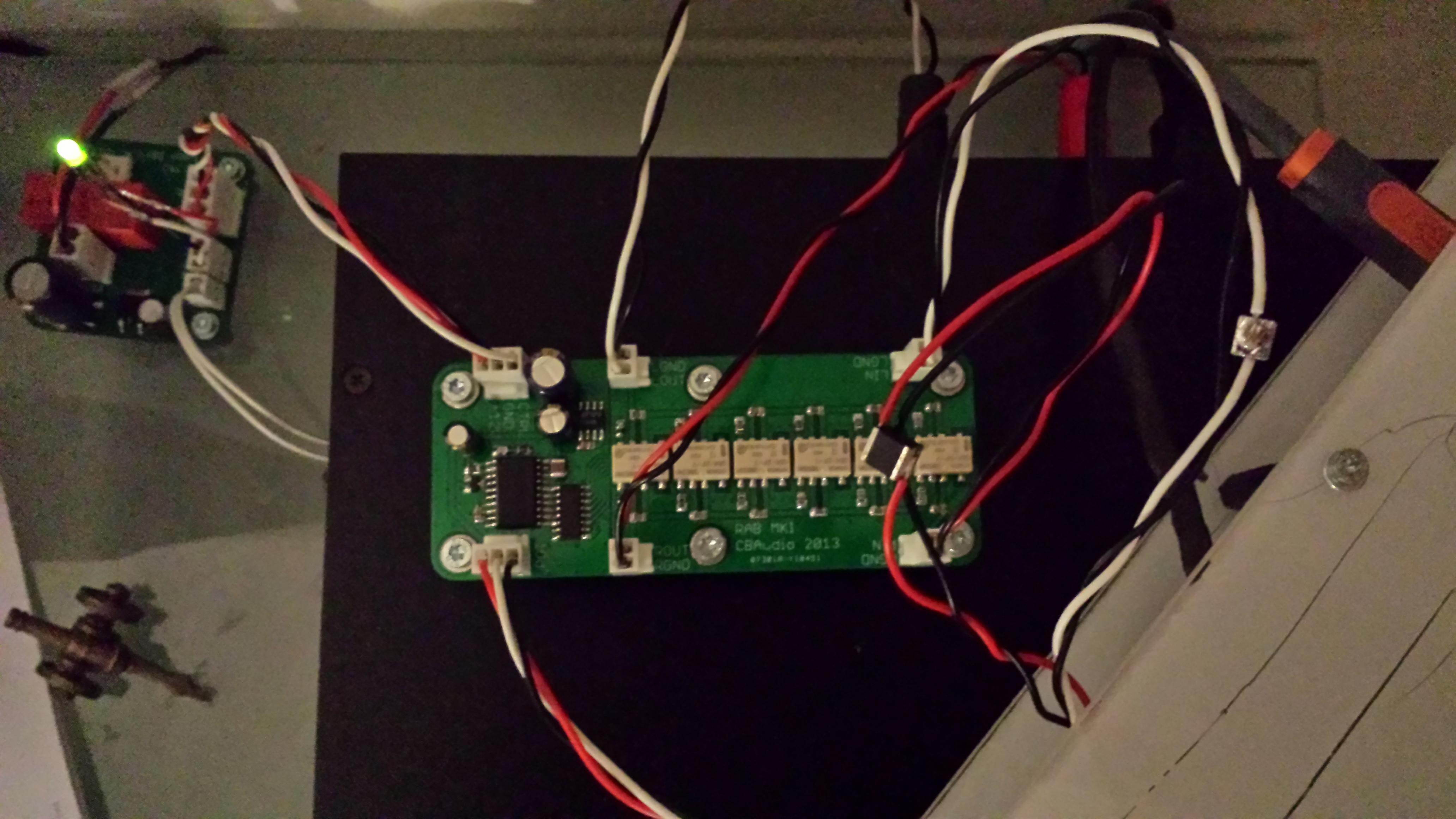

Would it be in some way possible to delay a signal?
Like if I go from LOW to HIGH it does it pretty much instantly but if I go from HIGH to LOW there is an added delay?
Could it be possible to do that in hardware?

I measured the "switching glitch" duration to around 500uS with 5VDC through the attenuator.
So it is there for a really short time but long enough for it to be clearly noticable.
None of my ideas to get rid of the "pops" seem to be any good after I have thought about it some more.
I am open for suggestions.

I think I got a brilliant idea. 😱
The problem here is most likely that the relays do not get to go fully on before they are turned off, which means that the magnetic fields aren't fully formed before turn off, this would result in the release time is faster that it would be if the relay were to go fully ON before being turned OFF. That is my theory anyway, don't know if it 's valid or not? It is just a thought and it might only apply in case of very fast rotation of the POT.
But what if we put all the output bits through a D Flip-Flop, driven by a 100 Hz clock, made by dividing down the 640kHz clock from the ADC0804.
Then every 10mS, the outputs from the D Flip-Flop would change according to whatever the inputs are fed with from the ADC0804 and then the relays would only change every 10mS, giving enough time for the realys to go fully ON with a fully formed magnetic field, before they are turned OFF.
Starts with all relays ON(full attenuation), 10mS - Some stay ON, others go OFF, 20mS - Some stay ON, some go ON(fast), some go OFF(slower than ON, due to flyback diode), repeat every 10mS.

Perhaps try a simple RC filter or better an integrator with break frequency of around 1Hz, to ramp the volume slowly, even when the dial is turned rapidly. Rapid volume changes become impossible but all changes are smooth.
It sounds like this has been an educational project and you've experienced first hand some of the limitations of this type of attenuator. It probably sounds quite clean once set anyway and as you've noted maintains perfect channel balance 🙂

Did some testing today.
I sent 5VDC through the attenuator and looked at the output with my oscilloscope and their indeed are short switching glitches which explains why I get a few "pops" when adjusting the volume.
The diodes included in the ULN2004 relay driver have a typical vF of 1.7V@350mA, more than regulaor diodes and this should give me a faster release time than if I had used regular diodes.
So I removed the ULN2004 common diode connection from +12V and let it float.
Instead I added external "normal" diodes with a vF of 0.850V@350mA. Again looking at the switching glitches on my scope this does seem to increase the release time of the relays since the switching glitches have been reduced in time.
Listening to the attenuator in my system with audio playing and adjusting the volume I still get "pops", which is as expected, however it does sound like what I saw on my scope carreid over to a real world usage scenario, the "pops" aren't as annoying as before. Great. 😎
On their way to me is a bunch of Schottky diodes with a vF of 0.38V@350mA, which hopefully should increase the relay release times even more and result in a further reduction of the "pops" I get.
If that works out, bringing me almost close to home, I might implement what was suggested in post #3 and see if that could make me reach my goal of "pop" free operation.
