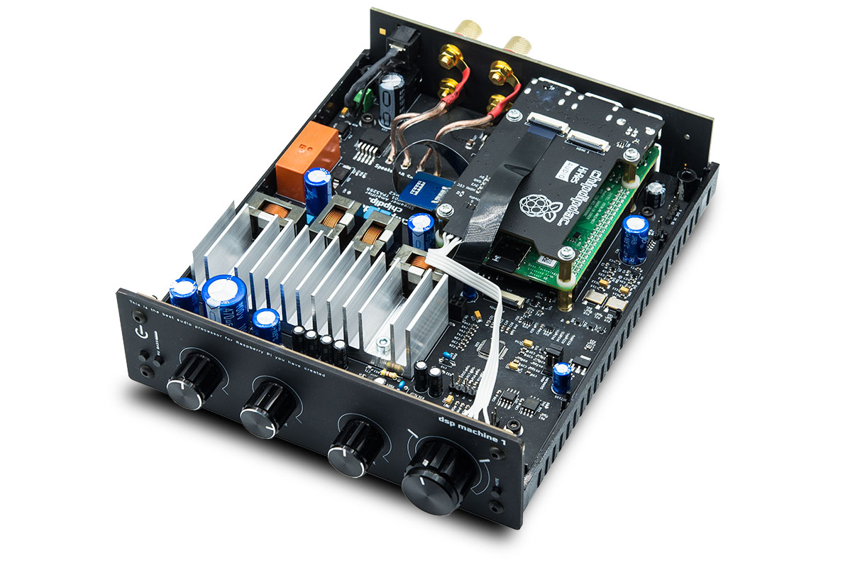

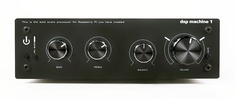

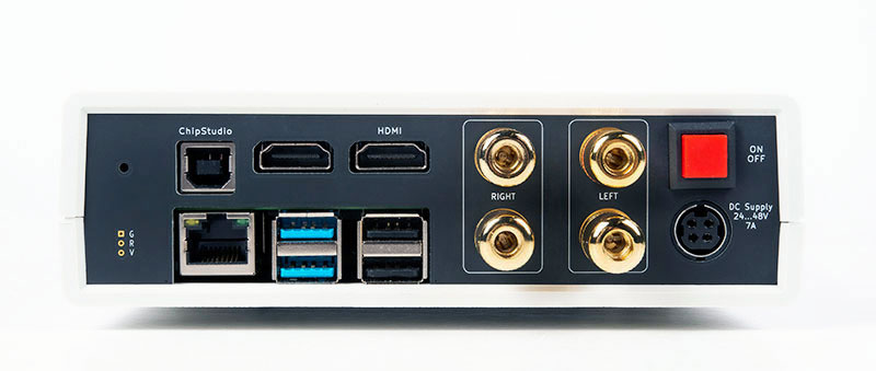

The first project is DSP Machines 1.
DAC, audio processor, amplifier for all Raspberry Pi. ADAU1701 + TPA3255.
PCBway.
- Compatible with all Raspberry Pi
- Compatible with SigmaStudio and ChipStudio software for audio processor rebuild
- Official support for RaspberryPi OS / Volumio3 / rAudio1 / Album Player / OpenELEC / Manjaro OS / MoOde and more
- DSP ADAU1701, TPA3255 amplifier chip for best sound quality.
- Output Power 2х120 W
- Audio output connectors: two pairs of screw terminals (left and right)
- Built-in EEPROM for automatic OS configuration (with write protection).
- Automatic frequency switching according to I2S input signals.
- Sample rate and bit depth range from 44.1kHz/16bit to 192kHz/32bit

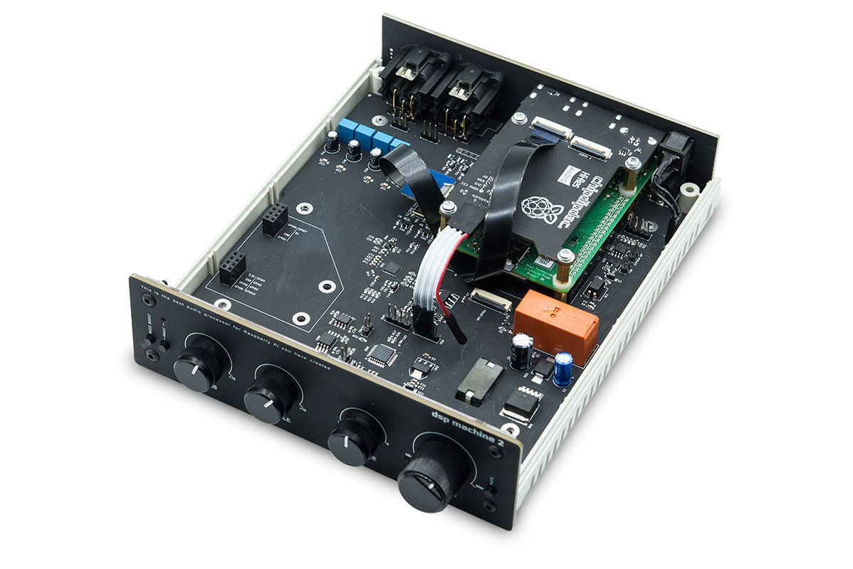

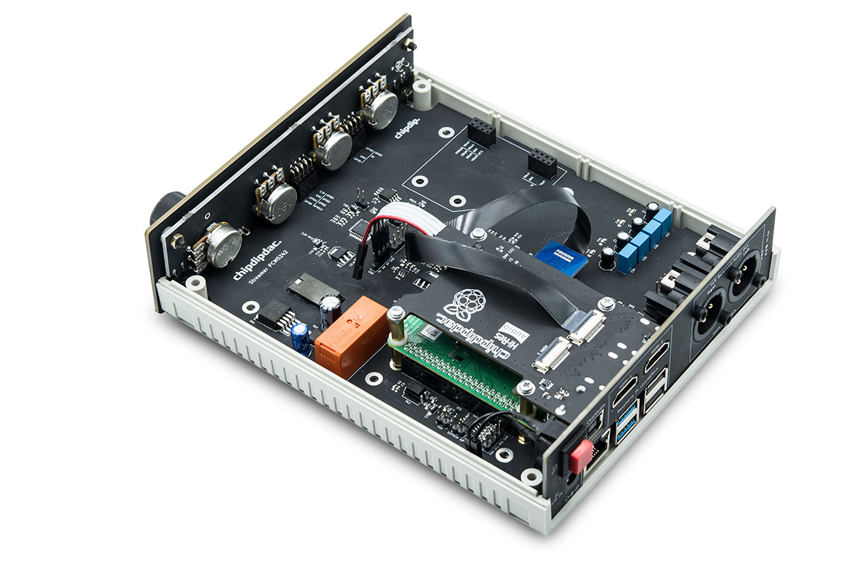

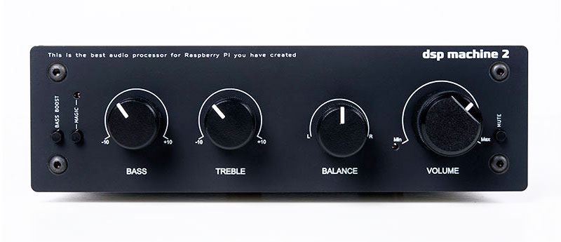

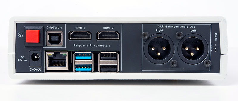

The second project is DSP Machines 2.
DAC, audio processor, for all Raspberry Pi. PCM5242.
PCBway.
- Compatible with all 40-pins Raspberry Pi
- Compatible with PurePathStudio and ChipStudio for audio processor rebuild
- Official support for RaspberryPi OS / Volumio3 / rAudio1 / Album Player / OpenELEC / Manjaro OS / MoOde and more.
- High quality PCM5242 DAC for the best sound quality.
- Audio output connectors: 2 x XLR (left and right)

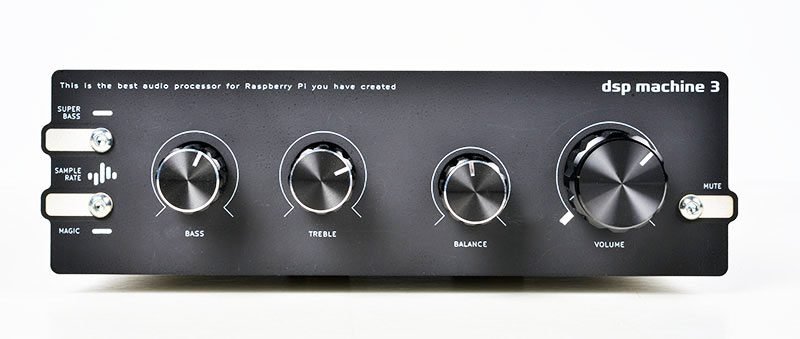

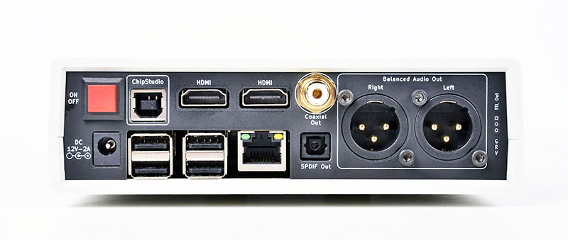

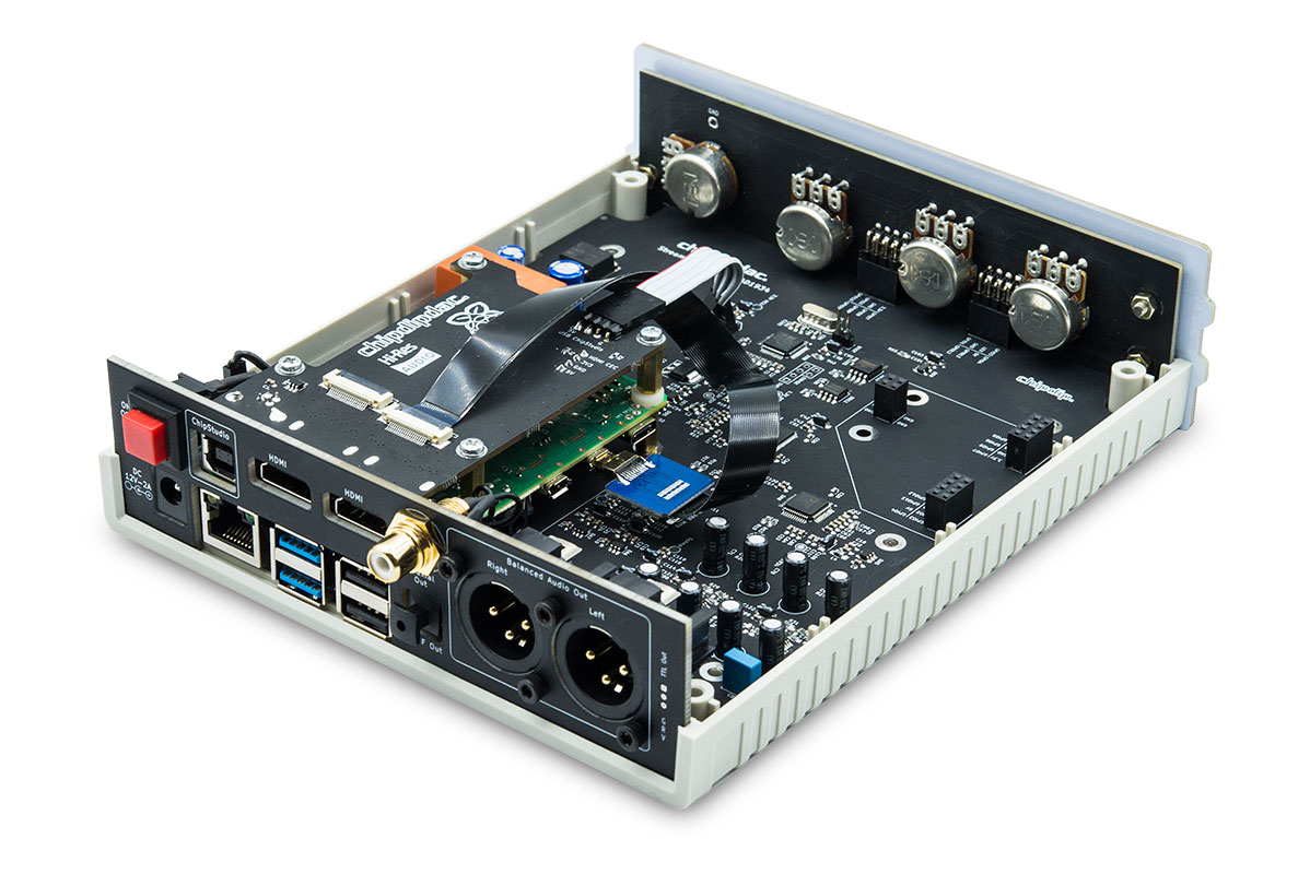

The third project is DSP Machines 3.
DAC, audio processor, for all Raspberry Pi. ADAU1452 audio processor and AD1934 DAC.
PCBway.
- High quality ADAU1452 audio processor and AD1934 DAC.
- Audio output connectors: 2 x XLR (left and right), SPDIF, Coaxial
- Color indication of sampling rates
ChipStudio
SigmaStudio & ChipStudio projects DSP Machine3

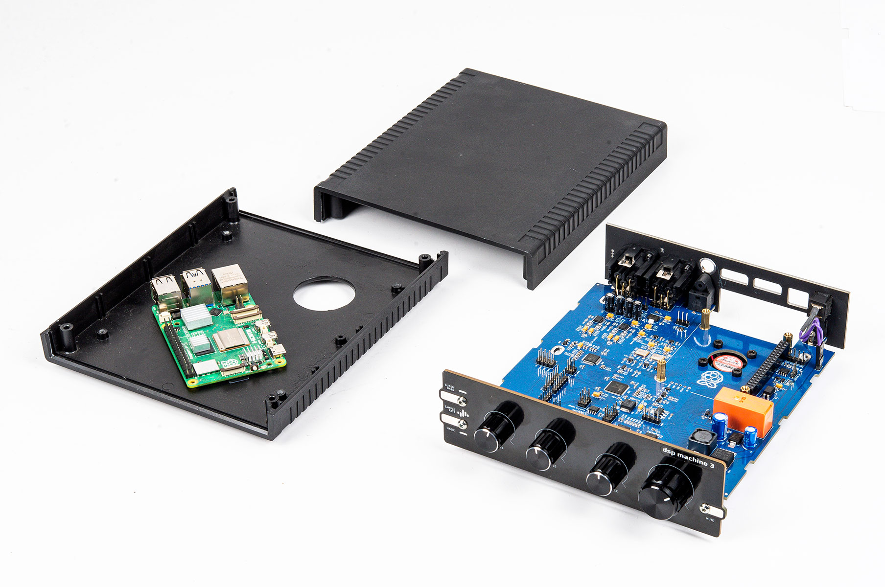

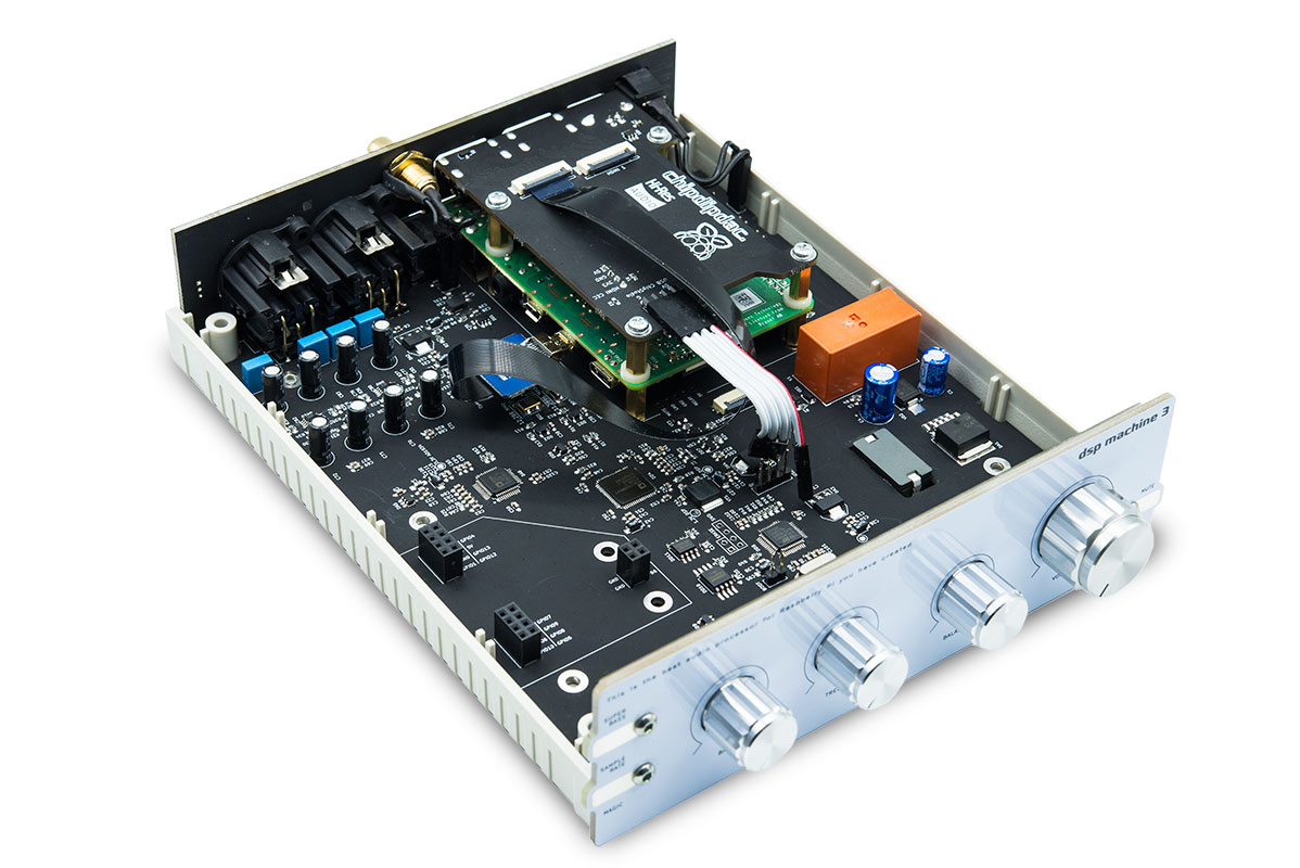

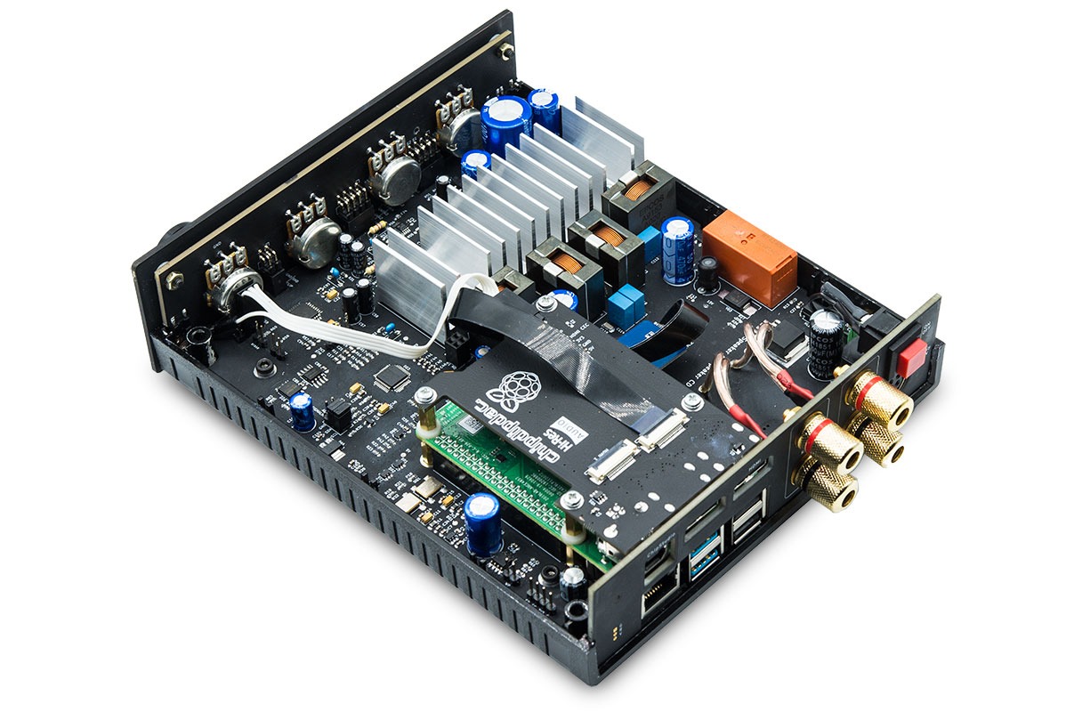

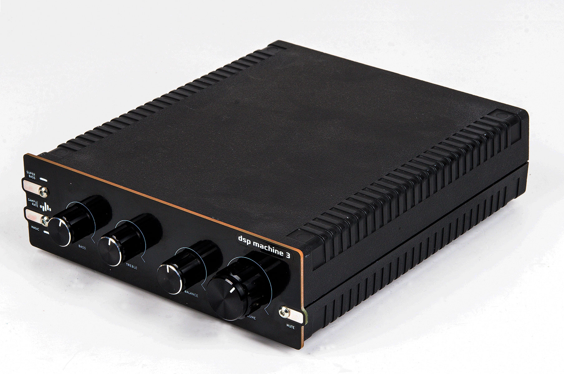

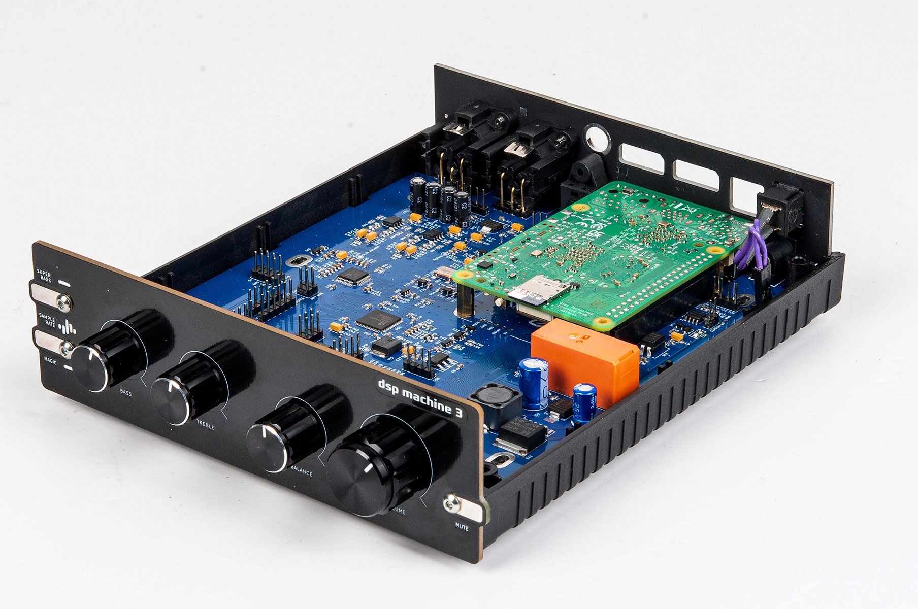

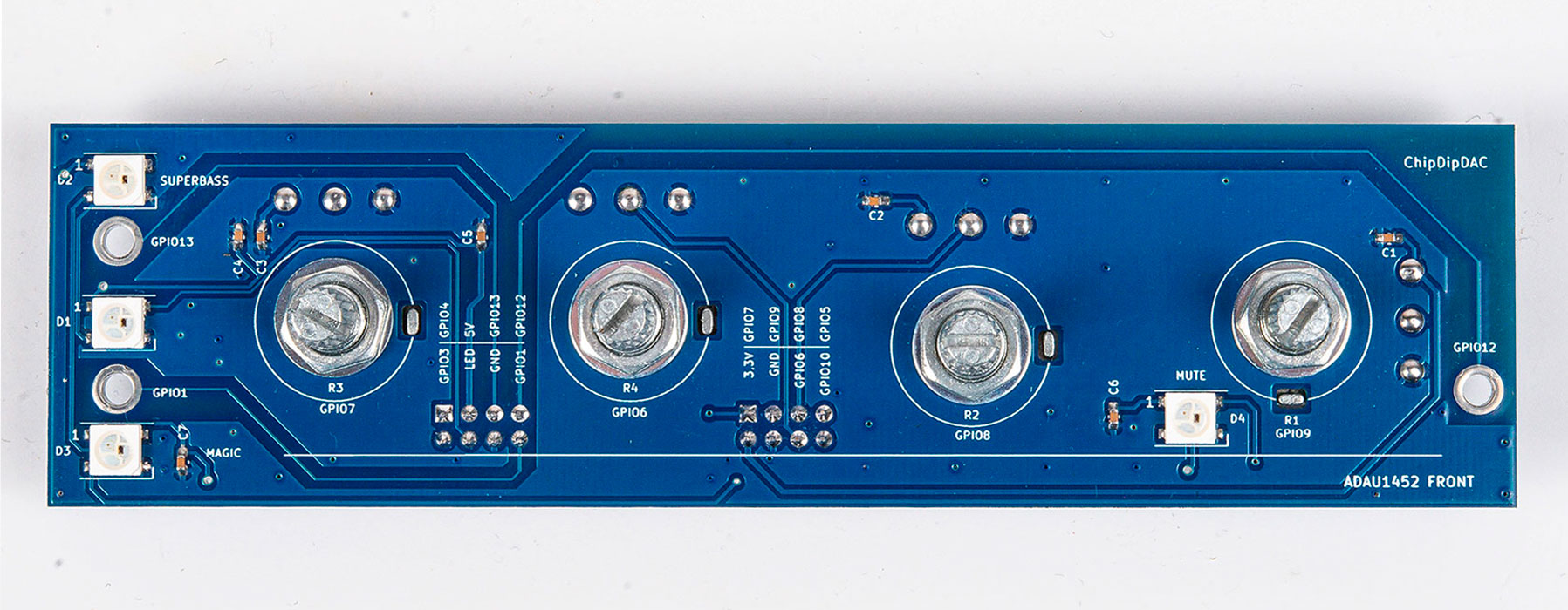

Updated of DSP Machine 3
Changes:
1. At the AD1934 output, two OPA1656 are installed instead of two OPA1632.
2. On the control panel, all LEDs are addressable - Neopixel type
3. All Raspberry Pi GPIO on the motherboard with a pitch of 2.54 mm
4. Improved motherboard design

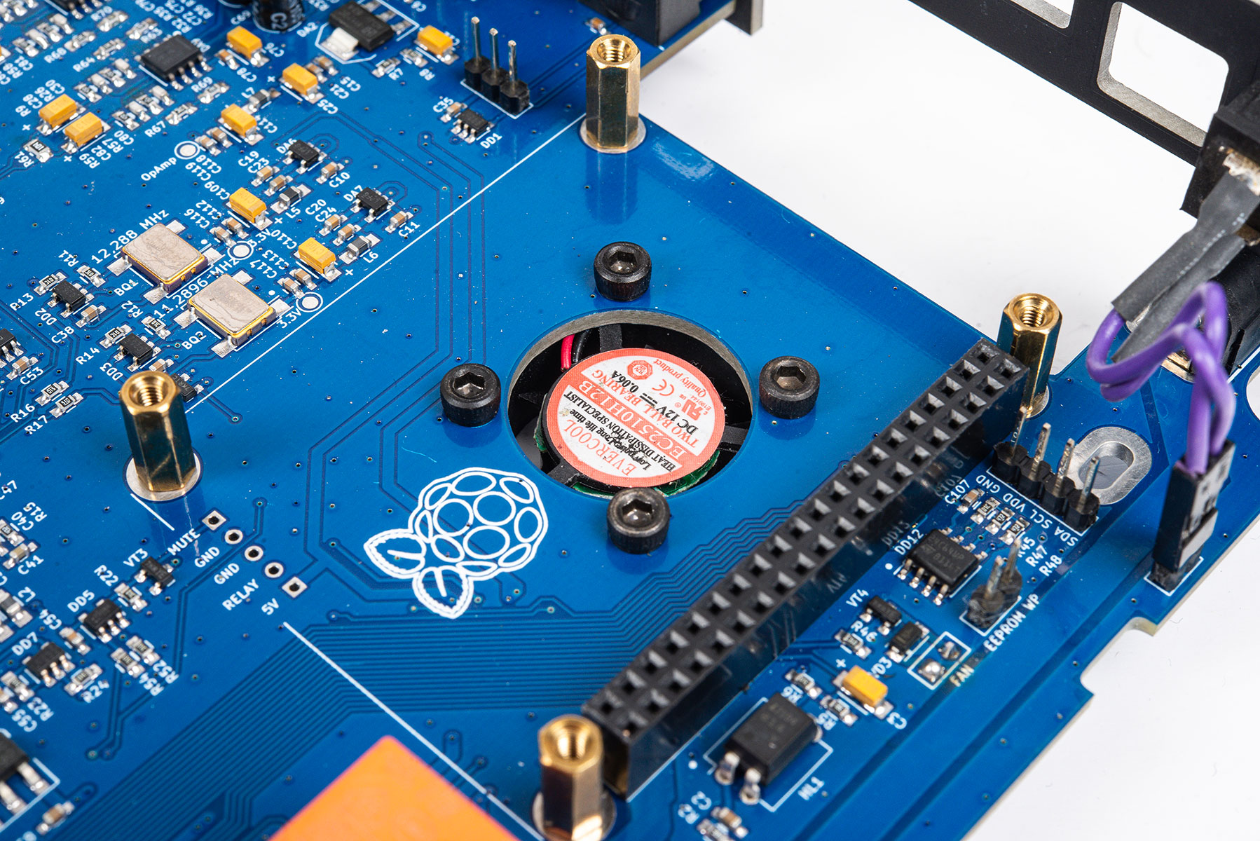

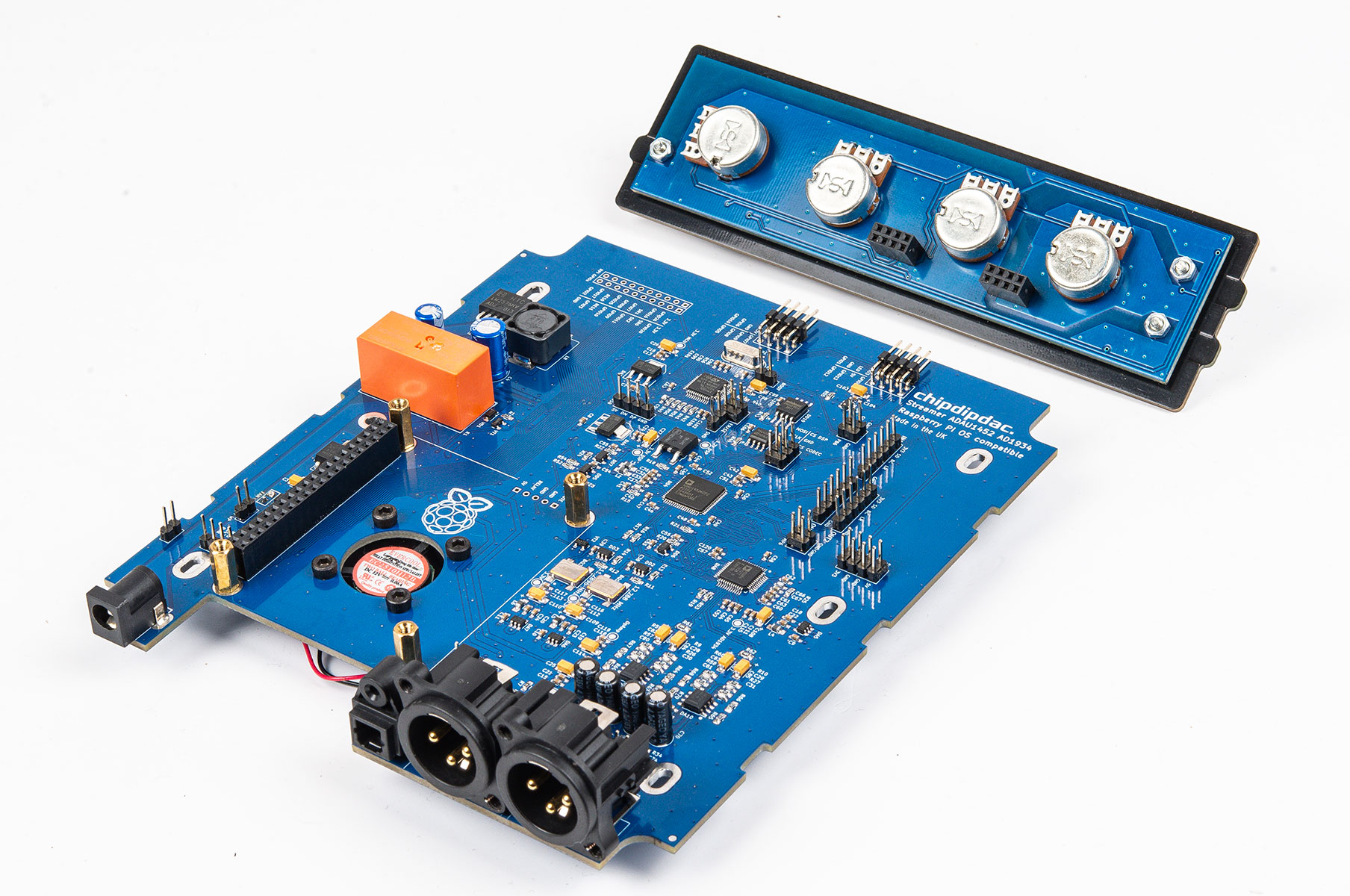

External view in the G764 Gainta Industries case. Painted black.
External view with open case.

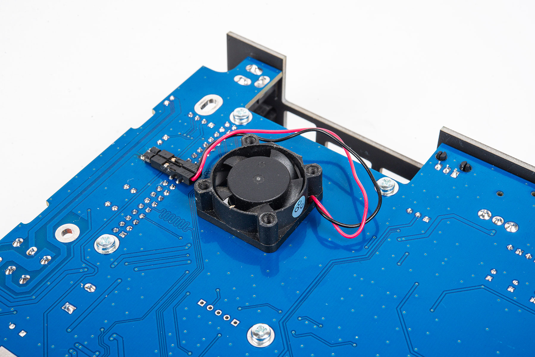

A fan is attached underneath the Raspberry Pi.
dtoverlay=gpio-fan,gpiopin=23,temp=65000

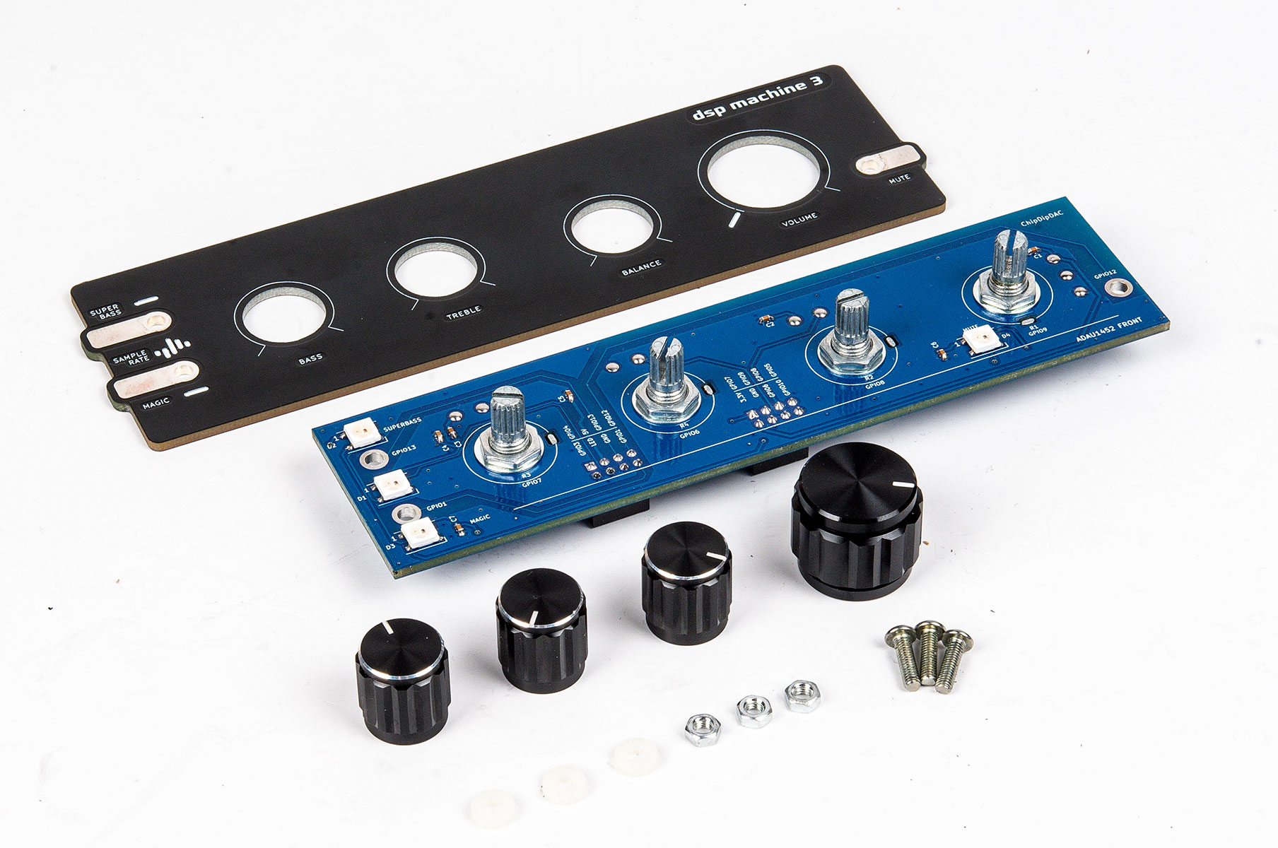

The control panel is attached to the motherboard.
Three sensors: SuperBass, Magic, Mute
Potentiometers: Low frequency tone, High frequency tone, Balance, Volume
Four LEDs: SuperBass, On, Magic, Mute

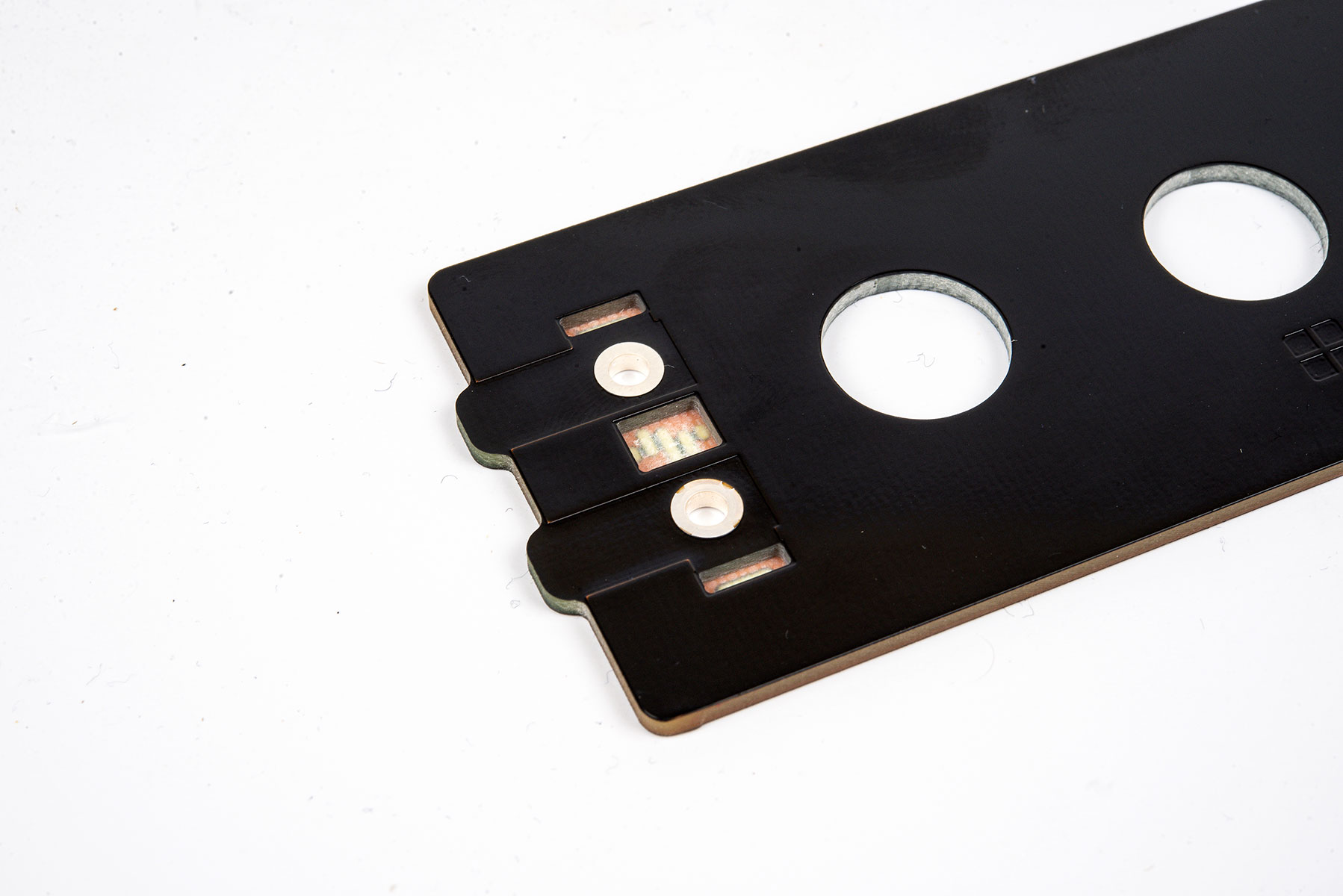

The sensor contacts are connected to the pads on the outer panel via mounting screws.
The outer panel is made of 3mm textolite. On the inside there is a 2mm deep milling for LEDs.

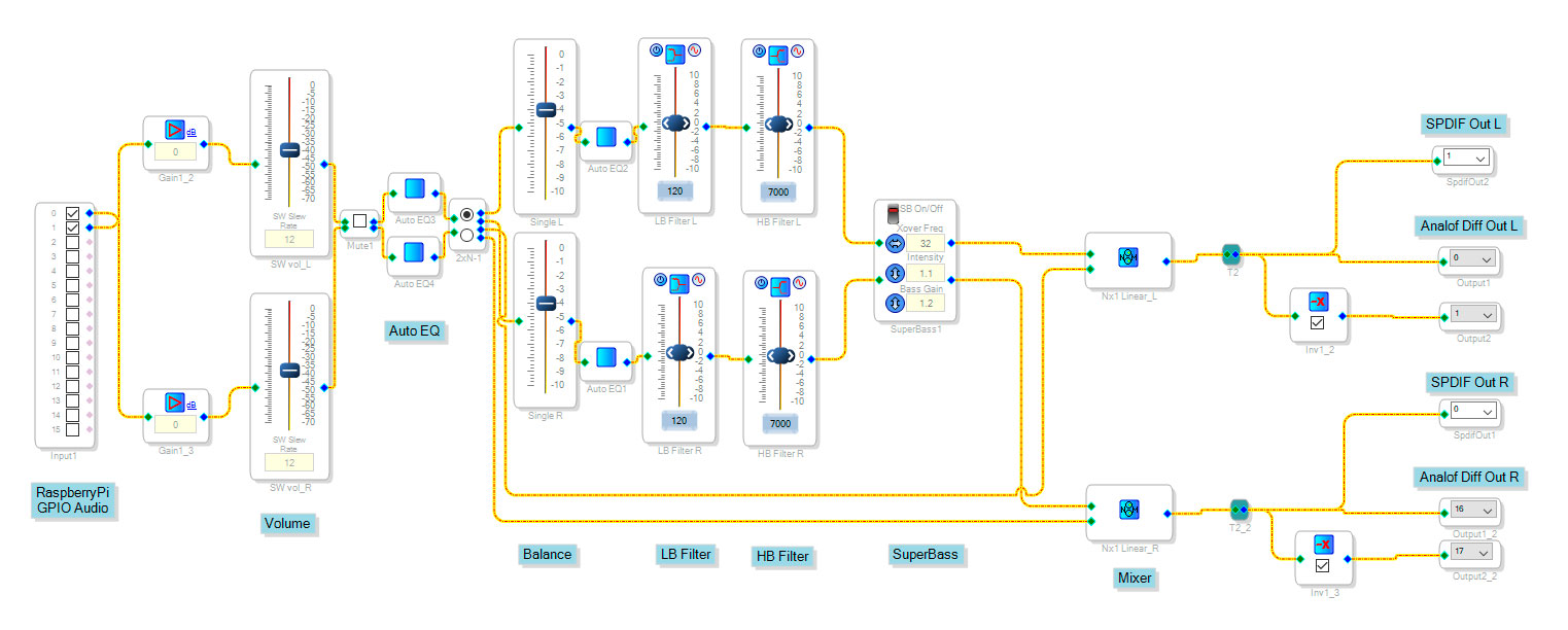

SigmaStudio
The project is not complicated, but pay attention! Automatic EQ is installed for possible room correction.
The ChipStudio project is a repeat of the SigmaStudio project.
