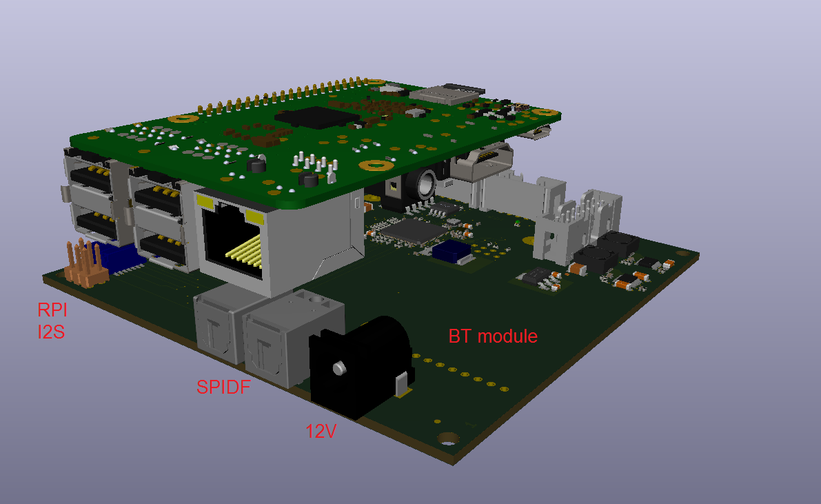

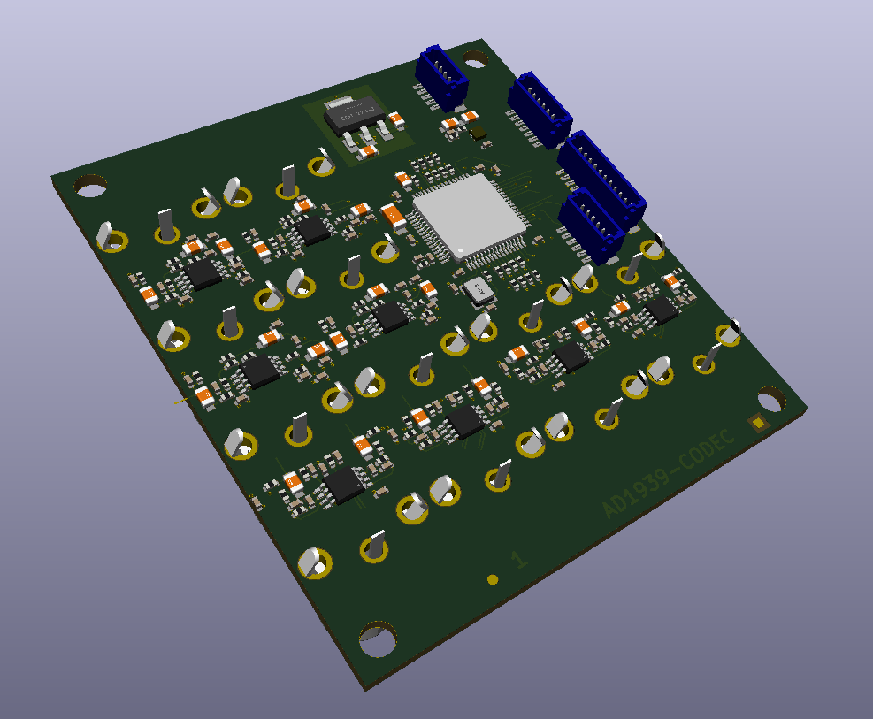

I removed the 2pcs AD1939 codecs from main board and made a separeta I/O board.
So I can put them vertical to the back of the cabinet.
Enables me to populate as many as i want and use different I/O combinations.

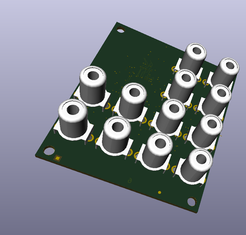

made a vertical pcb with 1 pcs AD1939
4 inputs at the "top"
8 outputs at the "bottom"

I really like the look of that! So clean and tidy.
Only missing volume control now, but that is not so important.

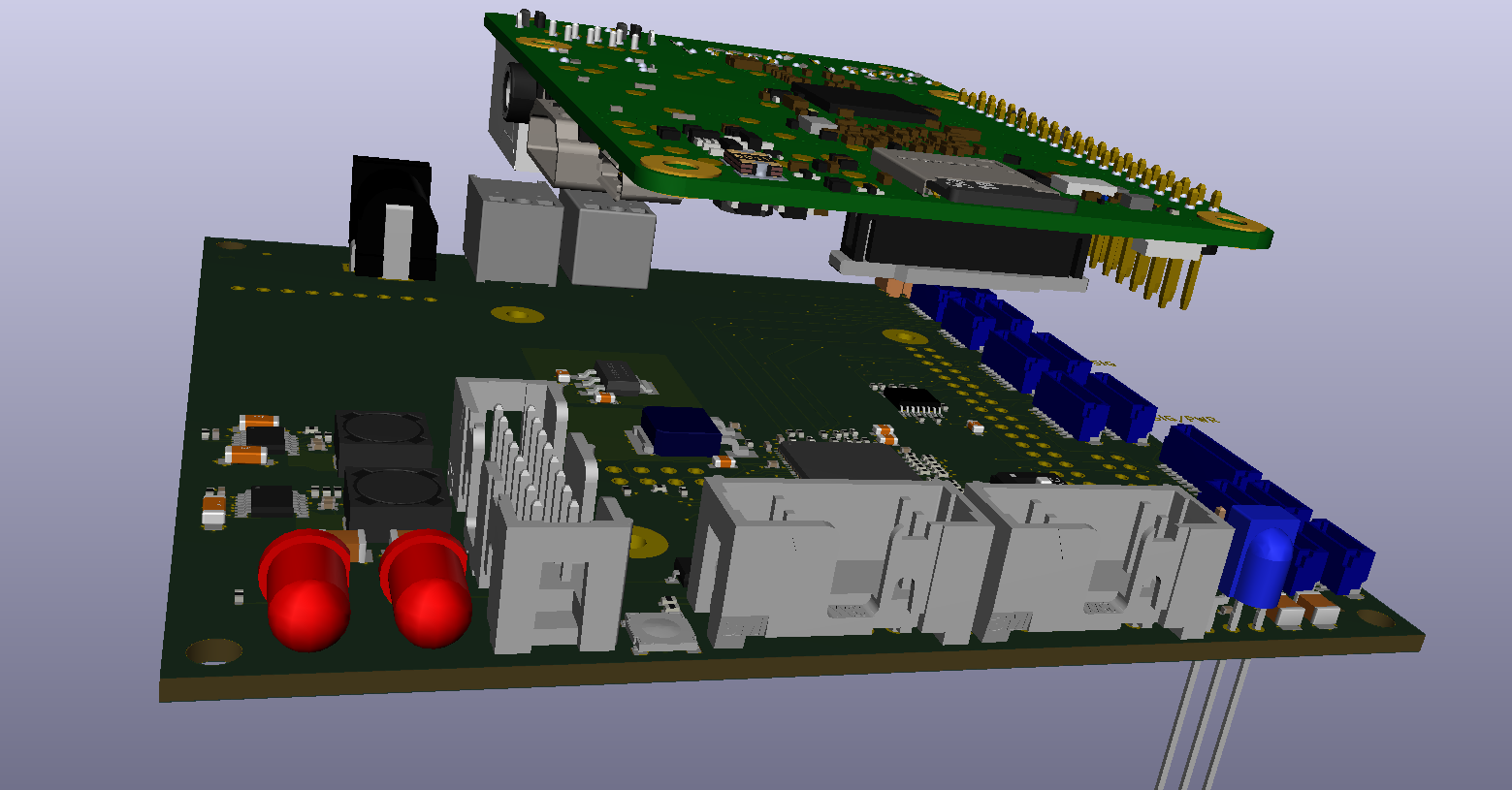

Hi
the HMI has been moved/postponed to a universal remote.
need to get this HW produced into v1.0 as the major task will be the software.
also there is a bunch of interface cards to be made.

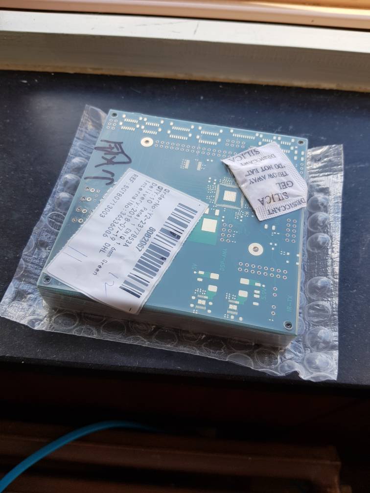

But I have the solder paste screen so I realize I need to focus on getting them assembled.
Next week of to China but final parts are under procurement.

Mounting the big problematic chip will be no problem for me and solder it for you.
I don't need money I just need some time.
Will fix it on return from China.

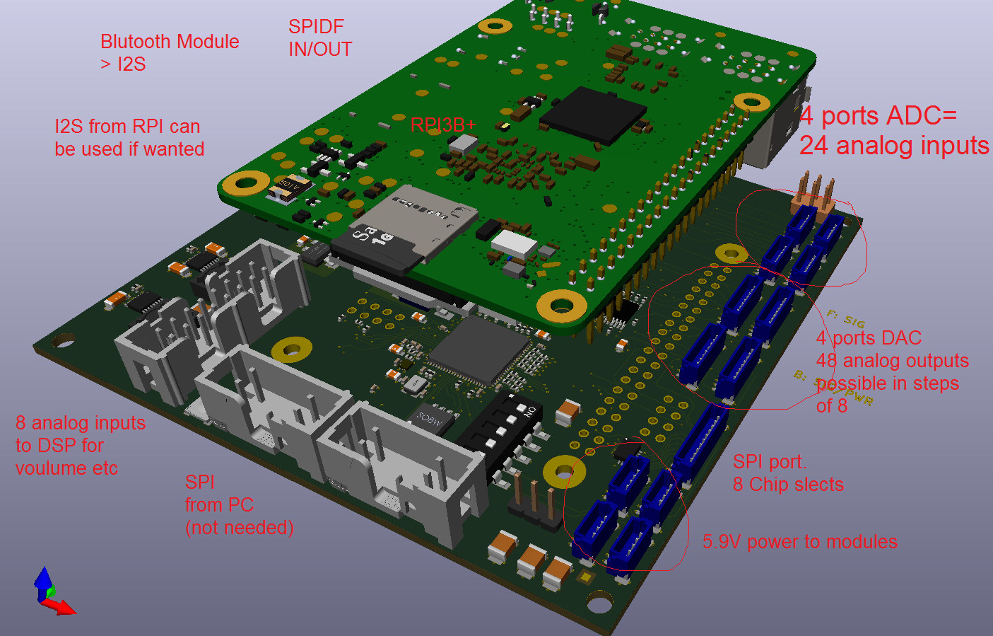

So what PCB's do you have? One for IO and one for the ADAU1467? Is there spdif conenctivity?
Is there an option to connect things to AUX ADC on the ADAU board?
