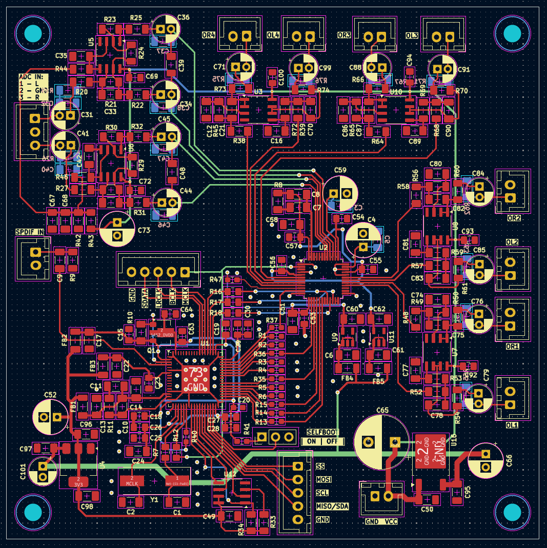

I'm building an ADAU1452 based DSP crossover with the AD1938 codec. The features I need are:
It's largely based on the datasheet and EVM. Though I want to keep it simple and compact, so no ADC or GPIO stuff, no digital output etc.
What I am unsure about is how to program the thing. There's not much info on this apart from using the official USBi programmer, but I read that a FX2LP programmer should work? Also I don't want to use a 1Mb eeprom, is 256k enough for a simple program?
Anyway, here is the schematic:

It will be if you configure it as USBi.but I read that a FX2LP programmer should work?
Use W25Q80DV they are cheap and available.Also I don't want to use a 1Mb eeprom, is 256k enough for a simple program?
Like this?It will be if you configure it as USBi.
https://oscarmcnulty.com/2020/07/09/programming-adau1701.html

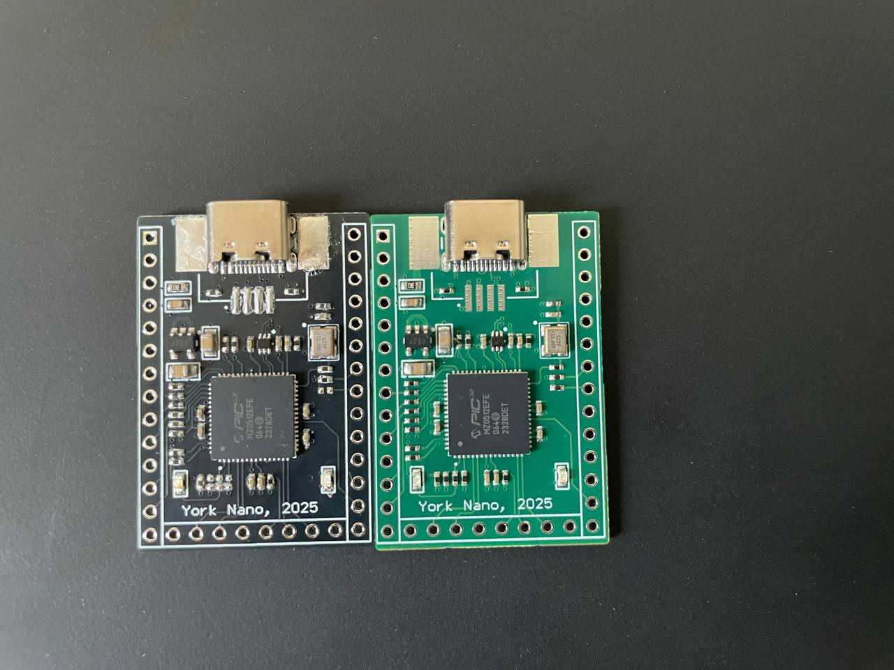

How about using York nano?What I am unsure about is how to program the thing. There's not much info on this apart from using the official USBi programmer
It would allow to program the DSP from SigmaStudio and stream (multichannel) audio at the same time, using one USB:

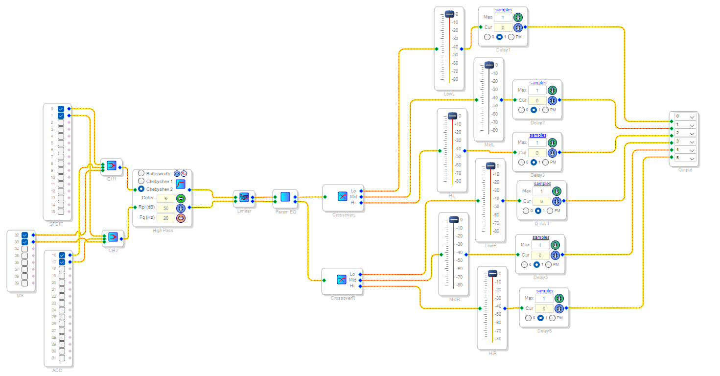

a) Installed SigmaStudio 4.7, opened one of the startup-files "R 3Way subtractive 48kHz", pressed "link-compile-connect" and get a message from the compiler output saying :
Obsolete algorithm code encountered in this project:
http://wiki.analog.com/resources/to...astudio/buildingschematics/obsoletealgorithms
1. Cell: Lookup Table1_2, Algorithm: LUT w/Min and Max (8.24)
- Seems this is the look-up table for the volume control, does this function have to be updated?
b) When I look at...

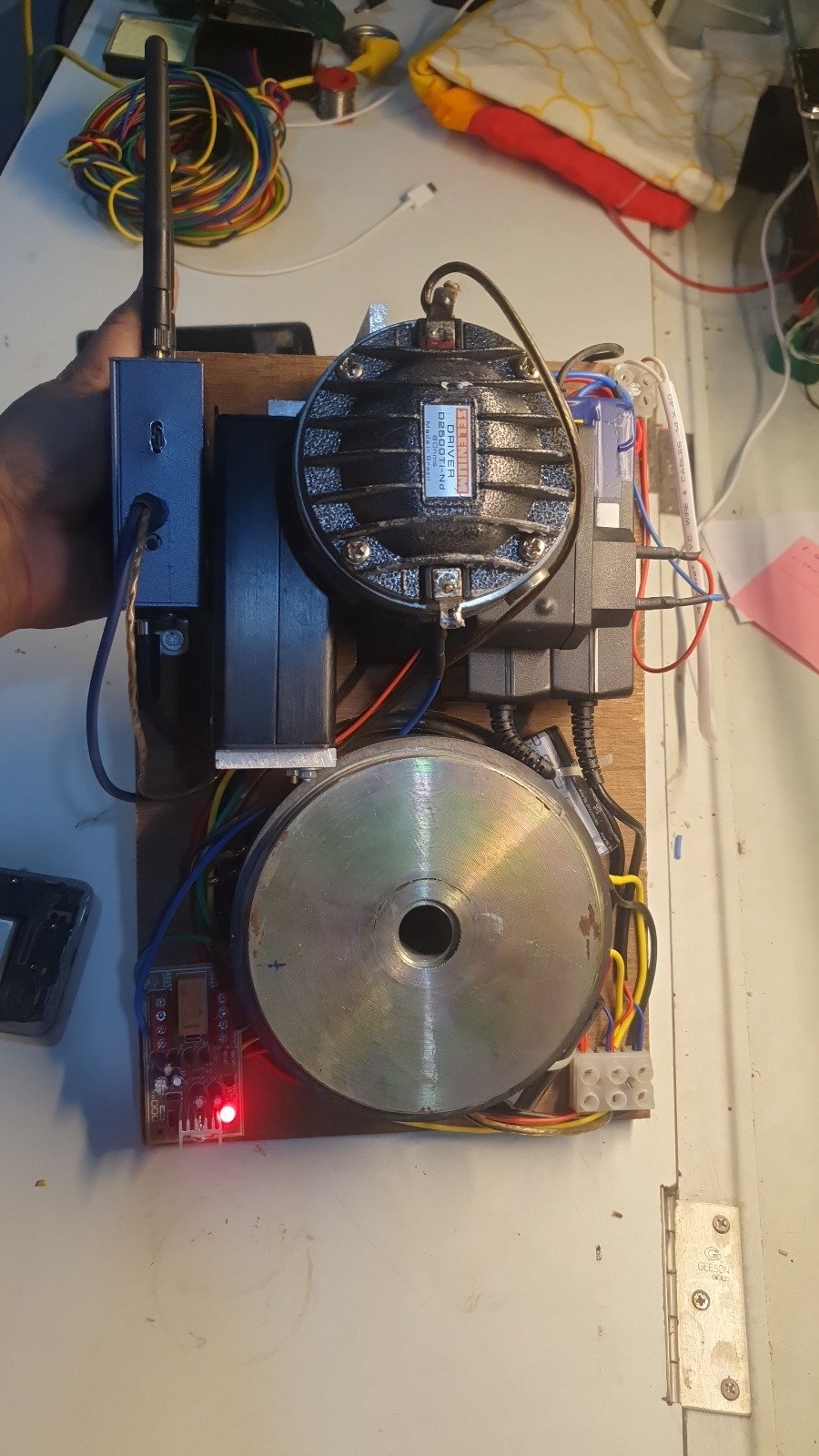

Yes , below are 2 pictures of a work in progress , 6" OB pictures from back and 8" OB (8' also has an Arylic DAC added later - not in the picture) , the DSP is stock Arylic motherboard BP1064L2 , once the DSP is set as per user requirements most of the time an user will be selecting source - volume - mute - equalization , and all of these are in the 4 stream App, the system is fully quiet when there is no signal - and i did not once have to use the infrared volume etc that is also built into the Arylic motherboard. I just leave everything on - all the time, For music open App select Spotify - play, system fully wireless without disconncting from wifi etc during power outages - connects automatically. BP 1064L2 is not the greatest of DSPs and the other features of the Aryic motherboard like BT, Remote volume etc is left unused when the Linkplay environment is being used, therefore your project will be a far better replacement for the BP 104L2 / arylic motherboard.

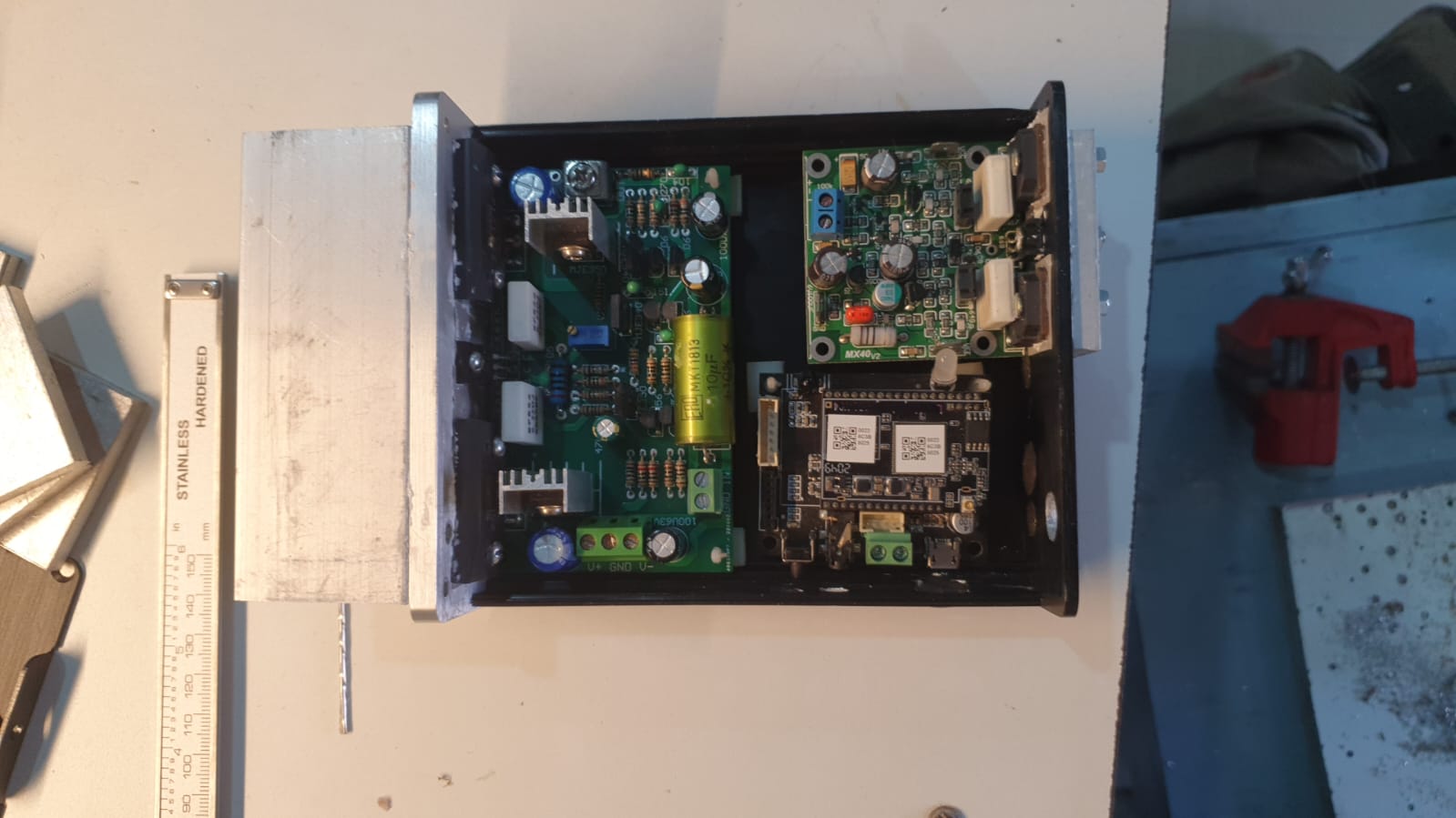

Picture of the Mid + Hi amp and Arylic mini is attached here.

I assembled the first revision of the board and I had the wrong footprint for Q1 (C and E reversed). I can't get the 1452 to start, not even by injecting 1.2V into DVDD and grounding VDRIVE. Without any transistor I get 3.3V out of VDRIVE. Is the chip damaged?
I did a new board revision and got the DSP working, however the AD1938 does not output any signal, only 1.5VDC. Clocks are valid, PLL is locked, reset is high. The codec is run in standalone mode and I grounded the SPI pins, so I can't modify it to read the configuration from it. Any ideas?
