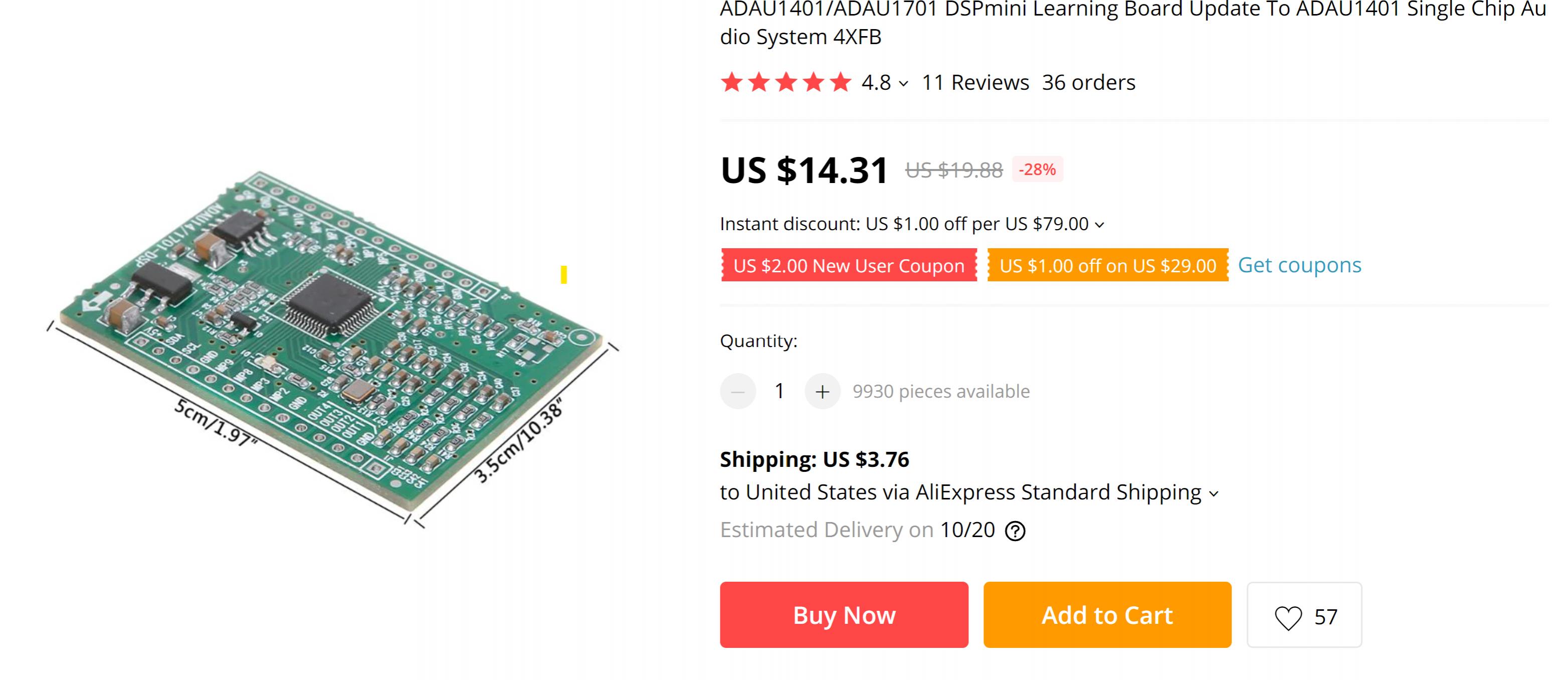

Hi, I found this on Aliexpress and was wondering if it is a board that can be used to make active crossover speakers. If so, that would be pretty great rather than buying a MiniDSP for each speaker.

People have used similar low cost DSP chips to make speaker crossovers. Probably doable with the one you mention. However, a DSP chip is only one part of a digital crossover system. There also needs to be a source of digital audio to input into the DSP chip and a dac channel output to drive the power amp for each speaker driver. Those digital audio source and destination devices have to be able to communicate with the DSP chip, which typically occurs at the I2S bus level. Making a whole digital speaker crossover system built around a particular DSP chip can be a fairly complicated undertaking for a beginner.
Adau1452 is better but it's not an easy road to get everything working but very fun!
SPDIF in and I2S output working good.
Agreed, it's not easy. I've been reading up on the hardware and software. But I'd rather invest my time learning these tools than learning passive crossovers. The stuff you can do with these chips is pretty amazing.
I haven't learned enough yet to understand why Adau1452 is better than adau1401. Or how to identify if a chip is good enough for my intended application.

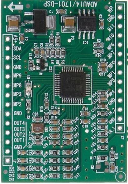

Hi, bumping this thread bacause i am trying to get info on the ADAU1701/1401 learning boards. What would be the easiest way to implement basic external volume, bass, and treble potentiometers to these boards? Any help would be much appreciated.

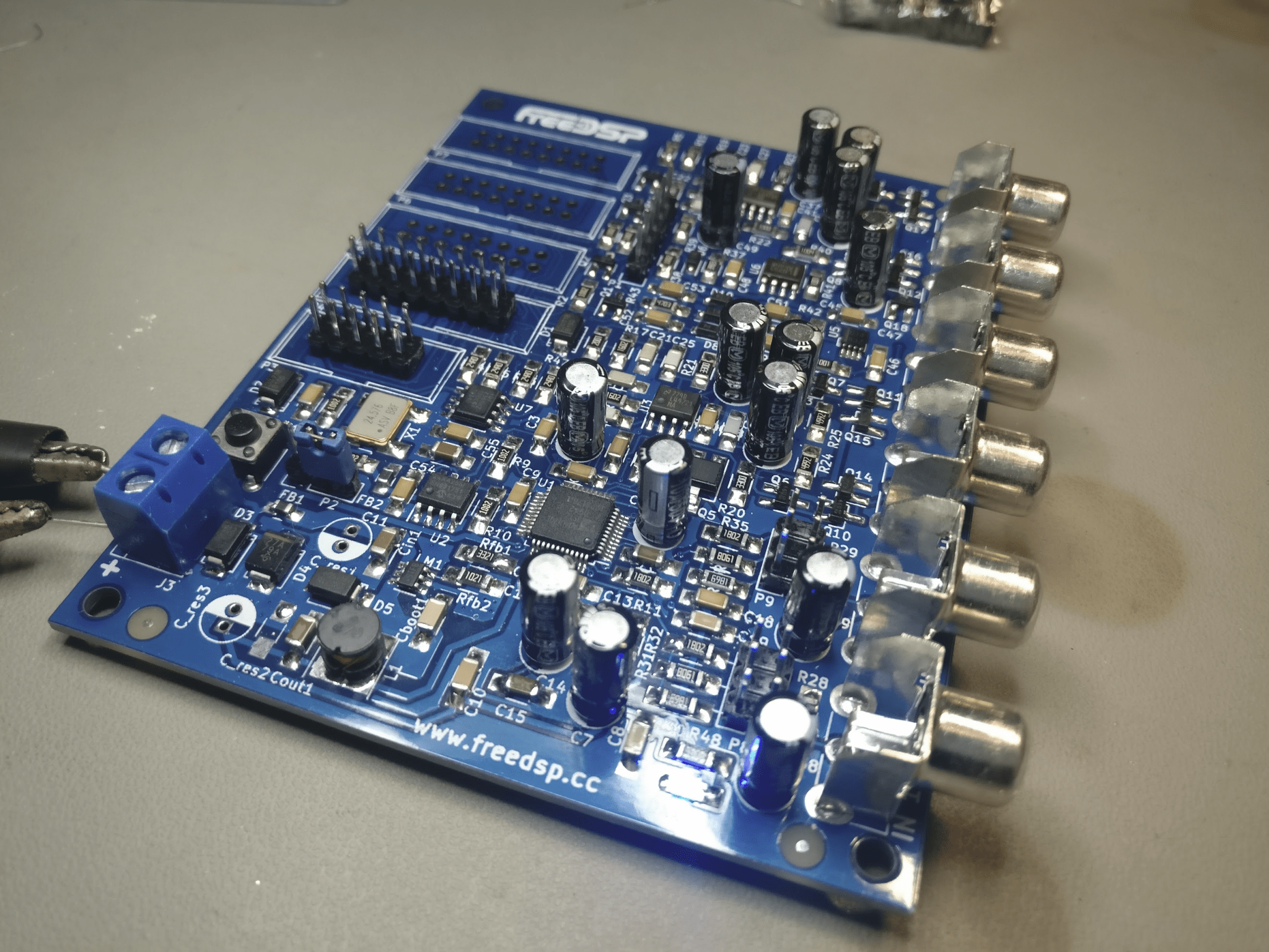

Since you are looking to work on an audio application, I would use one of these boards: https://freedsp.github.io/index.html
I built a freeDSP Classic SMD a few years back, when I needed a low cost DSP to do some crossover simulation and development. It worked like a charm.
The Sigma Studio software is relatively easy to learn and IIRC it is relatively easy to use it to implement what you are looking for.

I however have these learning boards already and would like to use them in a powered bookshelf speaker project. Possibly tri/bi-amping and using x-over, eq, and time alignment features on the chip through SigmaStudios. I am familiar with SigmaStudios software using the Wondom boards in the past, and had programmed the 4 pots for specific functions. I am not sure how to connect external pots to the learning boards and get similar functionality to the Wondoms'.
Hi, glide 1-San,
If you build two (Stereo) 3-way powered speakers, you can try FreeDSP Catamaran boards.
It was designed in dual mono architecture with embedded four pots. Especially extreme high-performance differential ADC will be suitable for your case.
Additionally, you need ADI USBi, FreeUSBi, or Connection Conversion adaptor for DB-DP11219 Wondom Programmer.

Actually these boards are analogue in and analogue out so ideal for active cross overs.Info is a bit scant on them other than drag and drop setup via AD's software. An eprom is programmed and that's that. ;) It looks like it's stand alone then. Doing it though???? Elector have an article but it assumes their programmer and end result is not that cross over related.
You can get an idea of the performance of the boards the op linked too via this, first rew lines
https://www.analog.com/media/en/technical-documentation/data-sheets/ADAU1701.pdf
;) However best buy one and evaluate it as per the how to link but it looks to be fairly high fhi.These chips sell in bucket loads and are cheap in products. Buy an AD evaluation board and things are a bit different. Also one off chips.

If you haven't found the answer yet, have a look at Analog's AN-951, Using Hardware Controls with SigmaDSP GPIO Pins https://www.analog.com/media/en/technical-documentation/application-notes/AN-951.pdf or web search for Controlling DSP (volume) in software, external hardware and with an MCU by Daumemo. You can use the pad at C4 as a source of 3.3v for the potentiometers.
