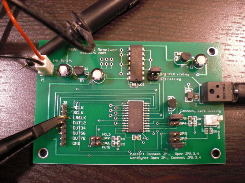

I made ADAT receiver board, based on AL1402G to output 4 channel I2S.
It looks like working now.
board was made by ExpressPCB, costs $91 for 3 mini boards.

here is schematic.
major parts are below, very simple.
U1 DS1812-5 DS1812-5+CT-ND
U2 LP2950-5 LP2950ACZ-5.0NS-ND
U3 LP2950-5 LP2950ACZ-5.0NS-ND
U4 TORX177 TORX177PLFT-ND
U5 AL1402G AL1402G
U6 74HC04
most expensive one is of course AL1402G, it costs about $24/chip.
bought from http://www.profusionplc.com/

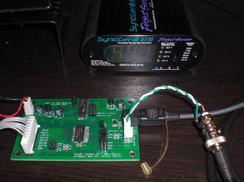

Also I bought http://www.zzounds.com/item--ARTSYNCGEN masterclock generator. I will test 44.1kHz sync-mode when I get cable (ordered to Amphenol)

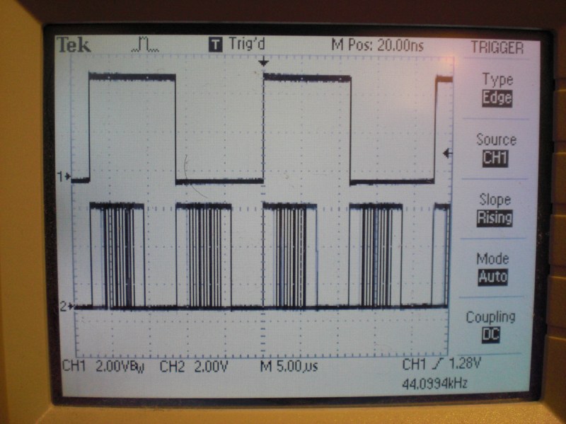

Photo for LRCK, and SDATA5/6.

Q: Jitter?
A: Yes I purchased ARTGEN WORD SYNC clock generator, it's spec says < 100ps.
ADAT itself will be some thousands ps. if 1/30 improvement make sound quality, I can try more expensive clock generator.
TAS5518 re-sample signal and make it's own PCM data to convert PWM.
So I'm not expecting ARTGEN can make some change.
especially for PWM, jitter is paramount. You need 20 ps for 16bit PCM equivalent perfomance.

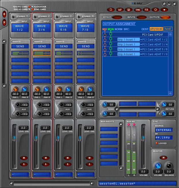

E-MU 1010 can work as Windows Directsound multi channel output, so it looks like I don't have to work with ASIO.
any player -> Viatual Audio cable IN
Virtual Audio Cable OUT-> CUDA FIR channel-divider
CUDA FIR channel-divider -> E-MU multi channel WAVE strips
E-MU multi channel WAVE strips -> ADAT output

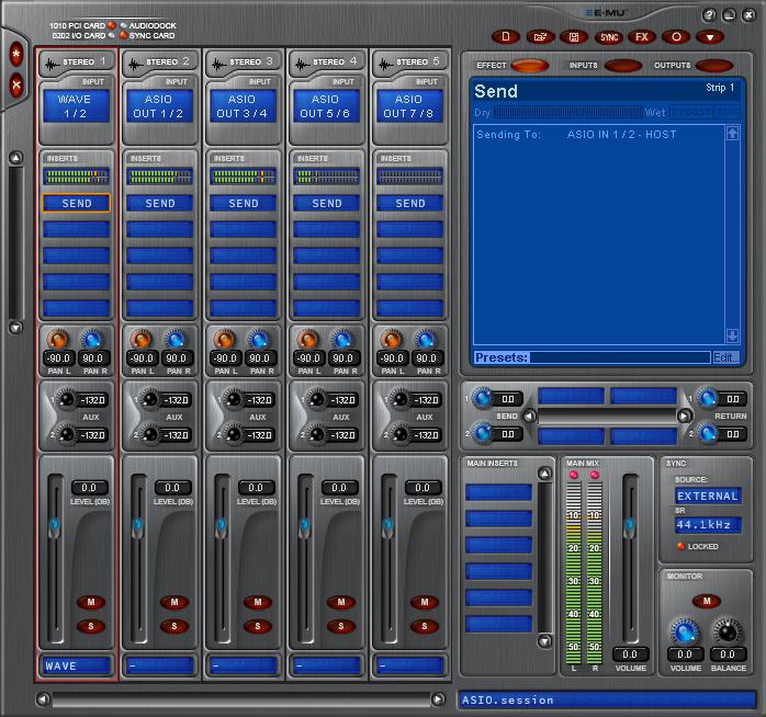

Attached is current source code, to get stereo from Host ASIO in 1/2, then process GPU_FIR and 4 way output to Host ASIO out 1/2 - 7/8.
(VEEERY rough and dirty)
E-MU is making routes from WAVE in to ASIO in, ASIO out to ADAT out.

From E-MU 1010 manual, page 115.
When PatchMix and the WDM audio content (.WAV file format,
playback and record settings in WaveLab. etc.) are both running
at the same sample rate, and when a Wave strip or send is
present in the PatchMix mixer configuration, WDM audio will
be played or recorded �gbit accurate�h without sample rate
conversion or bit truncation.
with VirtualAudioCable and E-MU wave output, VirtualAudioCable
is not running "in" PatchMix. I have 8192x4 frame FIFO buffer,
but I can't feel accuracy.
but now everything is running with 44.1kHz external clock sync.
very comfortable :)
