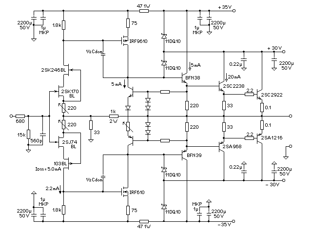

Gentlemen;
here is my contribution to the topic.
I have mine self-adaptive bias. Plus, it protects output transistors against overload, and when overdriven it sounds like a vacuum tube.
The idea is, playing with feedbacks. In "normal" mode the feedback is 100% global over both transistors of the shoulder and feedback diodes that also bias and thermo-stabilize the amp, when overdriven it slowly becomes a feedback by current in the 1'st (driver) stage, when the 2'nd stage amplifiers the current limiting it on the level of I*B, where I is the current through the 1'st transistor, B is HFE of the second one.
Errors on the schematic: pots to the ground (max output current) are connected to the ground, top right pot (bias) is R3, bottom right is R4.
The values for the resistors are for A+B class. For C class pots R3,R4 may be omitted together with series resistors.
For A class pots R1, R2 and associated Shottky diodes may be eliminated, for more bias current R3, R4 and resistors in series must be decreased.
Feedback diodes (silicone fast diodes) need to be thermally coupled with driver transistors. Theoretically, there may be the same transistors as used for drivers, with B-C junction used as a diode, B-E shorted, but I did not try such a version.
this is a Dimond Buffer topology so looking at the upper half D1 moves the emiter of Q23 about 700 mV away from the b of Q24 Giving an added 700mV of VCE for Q23 D3 moves Q24's emiter up the other driection away from the Base of Q23 giving another 700 mV since the emiter of Q24 would normaly have only 20 mV from the output and the out put and input should both be the same this gives about 1.4 volts VCE for Q23. CRD1 is a constant current source keeping Q24 from compleatly turning off at the Zero crossover point.
