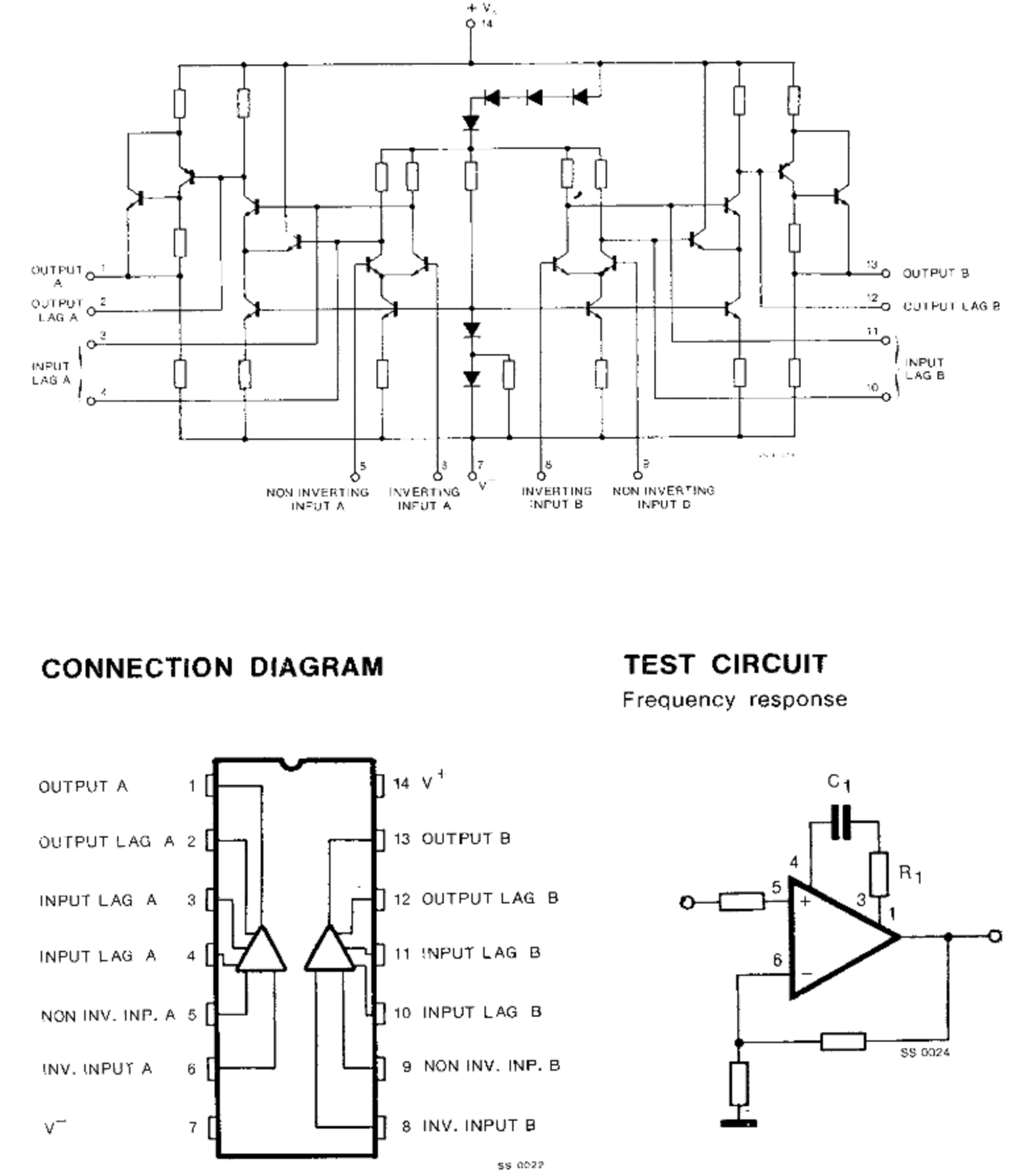

TBA231:
View attachment TBA231.pdf
It will depend on how your circuit uses pins 2, 3, 4, and 10, 11, 12 of the TBA231.
This probably won't be an easy swap ...

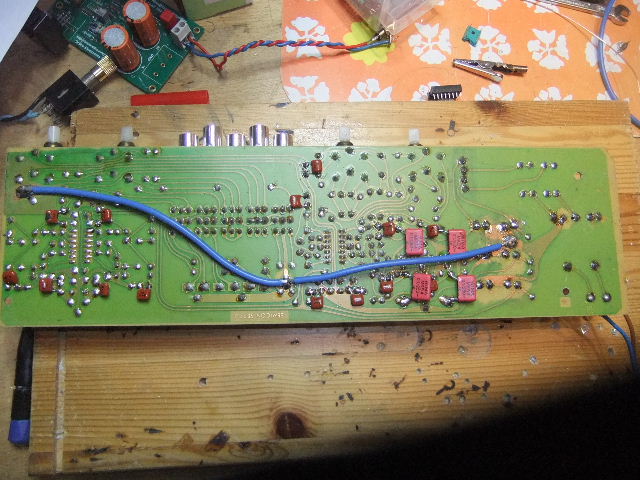

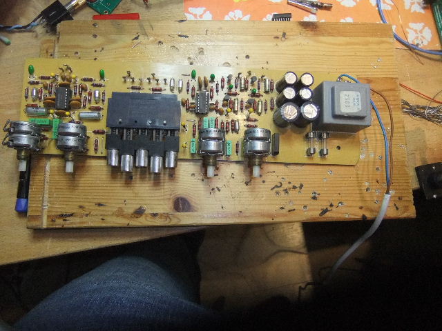

Back in the 70's I built a Sentec SE77 preamplifier (Swedish). This was one of my very first DIY projects. Since then, there have been many more. This preamplifier had as many others, to give way to new and more interesting projects later on, and has since been stored in my garage. As part of a larger “clearing projects” in older DIY projects, I brushed the dust of this preamplifier. To update SE77, I have been inspired by this: www.svalander.se/tips_fakta/hifi-tips/elektronik/modifiering_sentec/
Sorry that this is only written in Swedish, which is a easy thing for us Norwegians to understand.

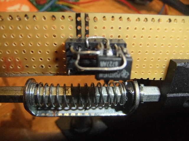

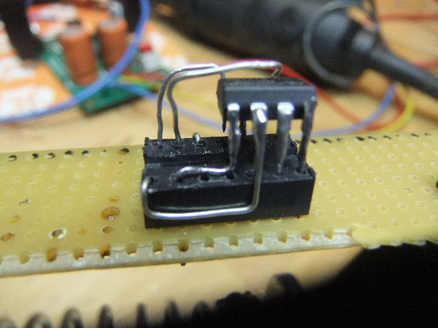

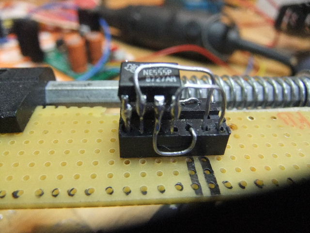

I have, after I asked my question on this site, sat down for to maybe find a workable solution. See attached photo where I have made a "test" on a veroboard and with a NE555.
Since there is no more modern subsitutes for a 14 pin TDA231, I want to go for OPA 2134
Comments are welcome.

To be honest, the 'test' looks a bit crude to me 😉
I think I wouldn't solder directly to the pins of the replacement opamp, but use a socket for it instead. Use a 14pin socket adapter as shown above, reroute the needed pins on a small piece of veroboard and put a 7pin socket adapter on it for the new chip.
More difficult, but probably will look nicer and work more reliable in the end.

A better solution was found: I took away the 14 pins IC holder. Blank wires to OPA 2134 from both sides of SE77 PCB. More "elegant" then my first attempt.
This works very, well and with a much better sound then TDA 231.
