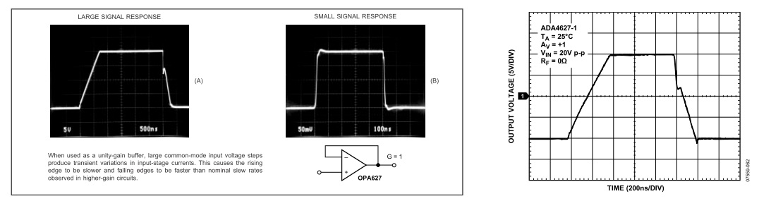

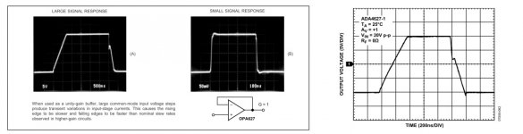

I just recently ran over the ADA4627/37 again for a different purpose than Audio (optoelectronics frontend), but when I saw the large signal step response of the ADA4627 I had a deja vu.
I know that only a very few OPAs do this very strong "snap" during negative slew. One of the very few types with this behavior is the .... OPA627 ! See apended picture. With the very similar performance characteristics on top of that, I would think, that the ADA4627 was planned as a 100% drop-in replacement, otherwise ADIs engineers certainly had eliminated this old fashioned misbehaviour.
From the engineering point of view, really good drop-in replacements use the same circuit as the "original", so I would expect that the ADA4627 is based on the same basic circuit as the OPA627, with some minor improvements, which don't influence drop in compatibility, like better clipping response etc.
Hopefully they didn't introduce additional substrate diodes into the inputs. In this case the OPA4627 could be as "perfect" in common mode distortion with high source impedances as the "original" (See Samuel Groner's OPA paper on this), with some very nice niche applications like buffer for high impedance volume pots etc.
This beast is certainly worthwhile a little bit of measurements to find out, what it's real strengths are (Not alone listening, because ears are often an inappropriate means to differentiate the subtle differences of modern OPAs).
