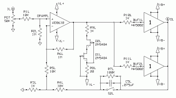

Peranders (or anyone else),
On your schematic of your headphone amp (very nice looking headamp, BTW), I noticed the CCS after the input opamp and before the BUF634. In reading over various threads, such as the Best Opamp, the concensus is for a 2mA CCS at this point, and this is what you designed.
While this would seem like a good option for you to have, I'd a little confused as to why anything is different at these CCS settings. My confusion concerns two items: the opamp idle current and the opamp output current.
The idle current of most opamps is over 3mA (the AD8610 is about 3mA; the AD845 is 10mA; and most are somewhere in between). I've read that you want the CCS to be about 20% of the maximum output. In the case of the AD8610, it's maximum is 50mA, so 10mA would be a good goal. For the AD845, its output is also 50mA, so it's output is probably already close to 20%.
Does this mean that the AD845 won't be improved since it is possibly already in class A mode? Does it also mean that the AD8610 should be run closer to 10mA rather than 2mA?
Finally, if the idle for the AD8610 is 3 mA, with probably most of this in the output stage, than it would seem to already being running at about 2mA on the output stage. So what would providing a 2mA CCS add? (If the answer, is the AD8610 should have a CCS of 20% of its output, or 10mA, then a CCS on the output starts to make sense.)

rljones said:Finally, if the idle for the AD8610 is 3 mA, with probably most of this in the output stage
But you can't know this. E.g. the LM6171 also runs at 3-4mA, and yet the output stage is a class B with almost zero idle current.
AD845 is a big fat class AB, though.

Have you compared the CCS load approach against operating the o/p stage unloaded?
Many op-amps work much better sonically when they are unloaded at the o/p. The o/p stage is a very real source of distortion. Some series R to decouple any subsequent capacitive load makes a lot of diffference.
Andy.
Yes I have I use a JFET cascode Current source with a small value resistor in series between the Op amp output and the Current source output. I install IC socket Pins so as to be able to remove the resistor while at the same time listening to the effect. Since removing the resistor is quicker and easier I first start out with it Installed then remove it while playing music and note the difference if any. I repeat this several times on different days so as to see if my notse for that day's listening reflect what my Previous notes include. I noticed that most Precision op-amps like the OPA-627/637, AD-825, AD-8065/66, AD-8610/20, OPA-132/134, LT-1122, are improved a lot in the high frequencies with the current source installed. I also found that currents above about 5mA will degrade the Dynamics of these devices. I found 0.5 to 2 mA to be the Ideal range for most of these Op-Amps with the actual value being about 0.7 to 1.5 mA for the AD-8610/20 AD-8065/66. and about 2-3 mA for the OPA-627/637, OPA 134/132. Op-amps like the AD-845 and AD-843 do not improve with a current source however thay do not get degraded ether so I use the current source by default and set it for about 1 mA. These are all referenced to the Negitive supply rail so the results may be different if referenced to the Positive rail.
