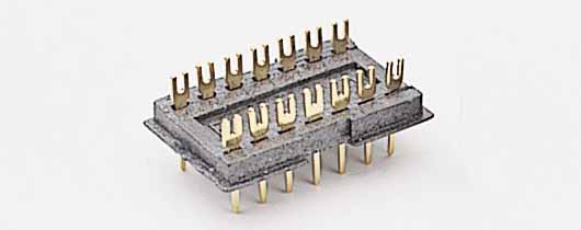

ashok said:
Hi Peranders,
I do have the AD8620 but I do not have a DIP adapter for it.
It's not very hard to attach a SOIC into a ordinary DIL socket.
Start to solder 8 wires in the socket, then bend them and cut them. The last thing is to solder the SOIC chip.
The best socket here is a component adapter, socket for resistors, caps etc.
