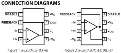

BTW layout will be very critical with a 550 MHz opamp like AD8099, ADI did not change the pinout for nothing. There is a chance that the preamp will be a RF transmitter ...
However if you like listening to music instead of more or less noise there are some other choices that maybe are less in specs but sound a lot better.

I am a subsciber to ADI Solutions Bulletin and I was intrigued by AD8099 too. A pity that it is not made in DIL form but I guess in DIL it would not have the specs it has now. It seems that its specs are somewhat over the top for audio-purposes though 🙂
