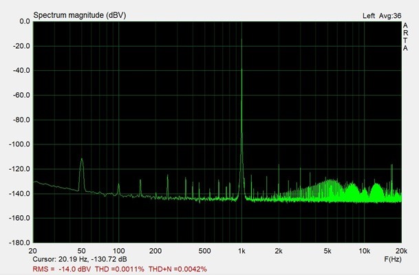

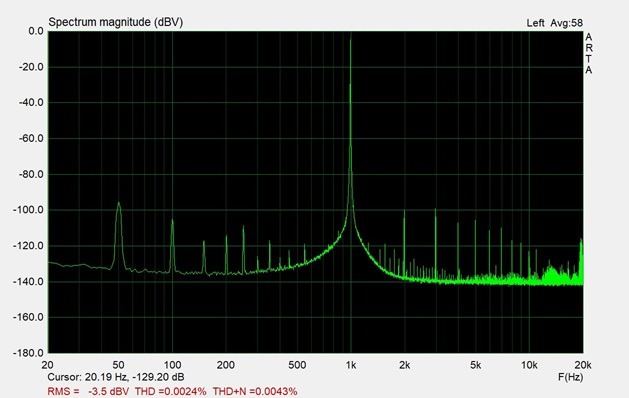

Today I have performed some quick measurements, just to see what I have, and its not that bad. I have used Arta with Xonar U7 MKII sound card which has some limitations. The real results should be even better: I should have used a better signal generator and better wiring, but anyway.
Measurement results are presented on two screenshots shown below.
The first snapshot presents FFT measurements at at 500mVRMS (1.41 mvp-p). The resulting THD+N is 0.0015%
The first snapshot presents FFT measurements at at 900mVRMS (2.54 mvp-p). The resulting THD+N is 0.0054%

Hi ! thanks a lot for the very interesting results Do you have a spectrum of the test signal as well maybe ?
i guess it would be important to check the signal generator contribute to THD and noise ?

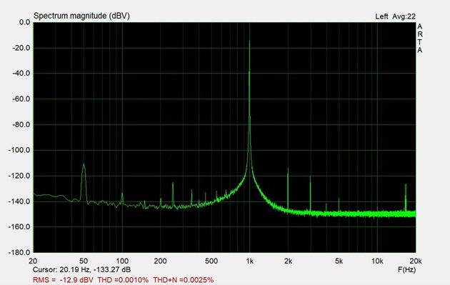

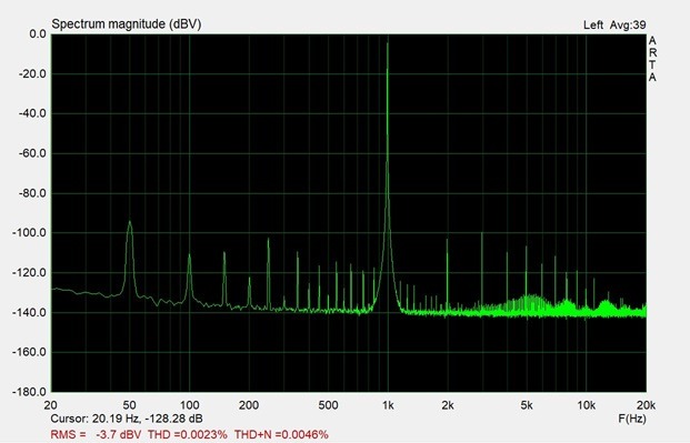

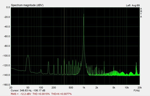

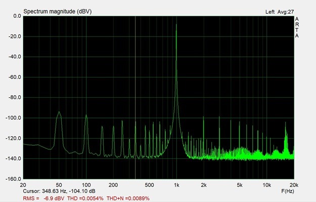

I have got today new batteries for the sine wave generator and made several measurements. Here are several results, all at 900 mVRMS output (2.54V p-p). Results at lower output voltage are better but I wanted to show the worst case, which isn't that bad at all!
I have also much better sinewave source, a great DAC based on Xingcore digital interface, but it appears that the soundcard is limiting further measurement improvement. But I'm happy with the presented results.
First, sound card loopback, output 300 mVRMS, alone:
Now, Akitika sinewave generator at 300 mVRMS output, alone:
Now, Akitika (300mVRMS) into 6010D, output 900 mVRMS
Finally, Xonar U7 MKII (300 mVRMS) into 6010D, output 900 mVRMS:
