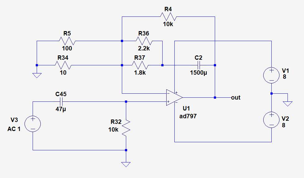

What you propose is to modify the circuit as in the following figure. Is that correct?

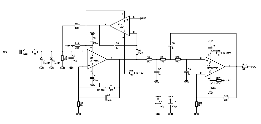

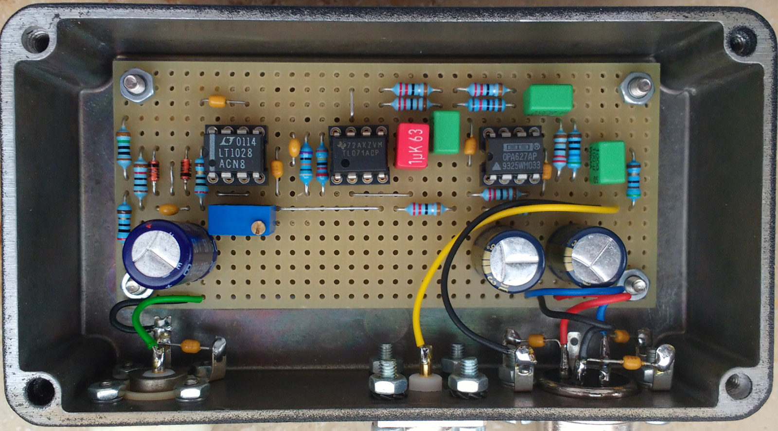

Here's what I built a few years ago for more or less the same purpose. Input noise voltage density is ~ 1.5nV/sqrt(Hz). By the way: For low frequency noise the LT1028 (~1nV/sqrt(Hz) @ 10Hz) is much better than the AD797 (~1.8nV/sqrt(Hz) @ 10Hz).
This is my third (and last) attempt to post this message including the images …
Correct, with R5 = 113R or 110R (or no R5 and R34 = 9.20R, but that's an E192 (!) value). 100 ohms still isn't too bad though, that's 40.08 dB as-is and you might be perfectly happy with that. 110 ohms: 40.015 dB, 113 ohms: 39.9960 dB. The distinction between the last two may be pretty much moot unless you've got serious precision resistors (0.25% or 0.1%)...
Your circuit is nice, close to what I am doing.
Yes, the LT1028 has lower noise than the AD797 below 100 Hz. I had not noticed that. Also the LT1028 is cheaper.
Thanks for this. I will order a LT1028 to make some measurements.

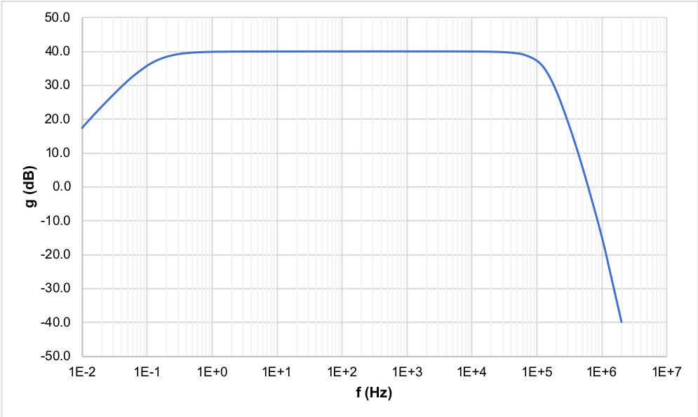

LTspice simulation shows that with R5=100, the gain is 40.007 dB.
With R5=113, the gain is 39.917 dB.
Also the output offset voltage of this circuit, again according to LTspice, is -3.24 Vdc (worst case).
