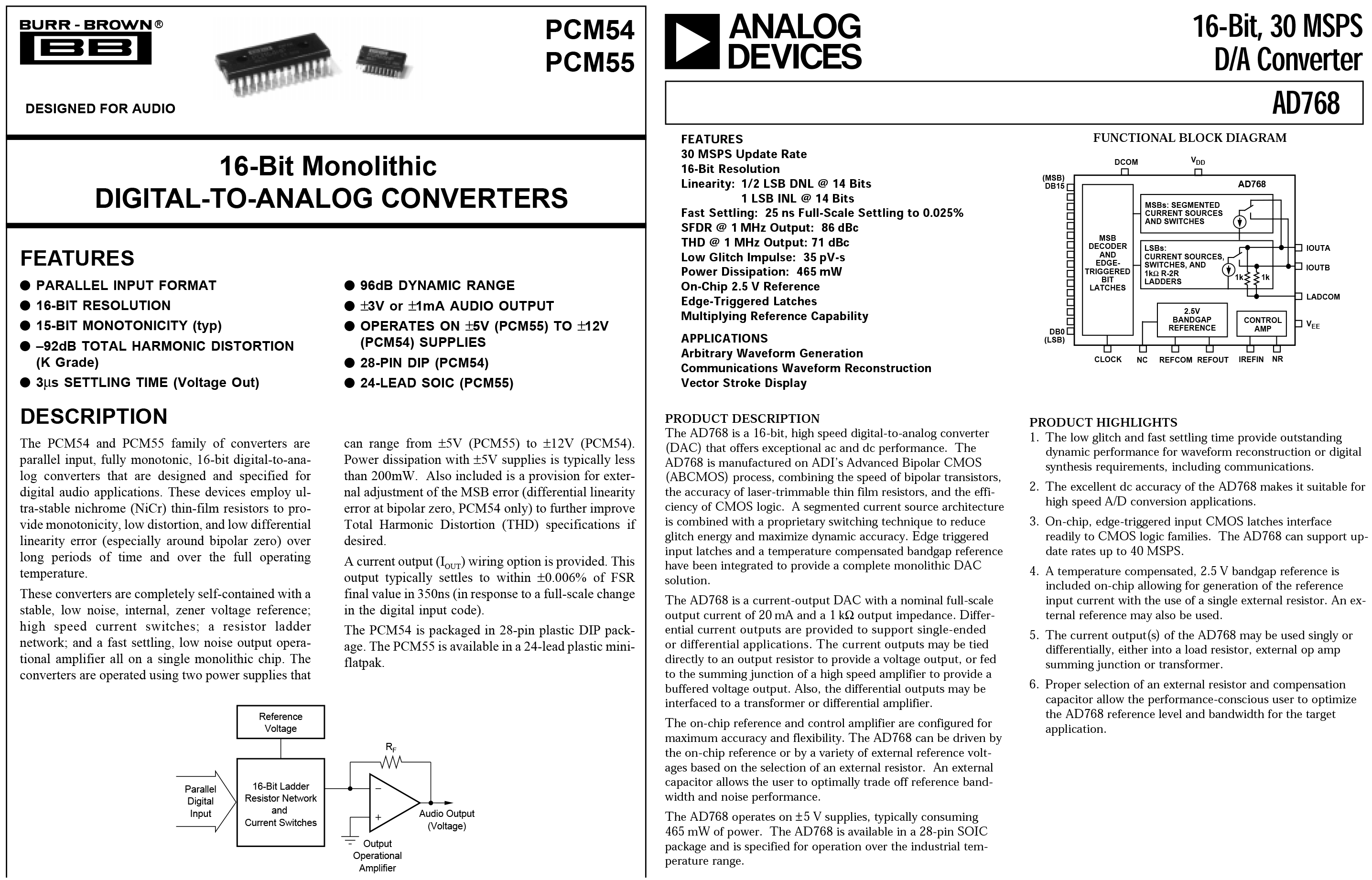

In a moment of bored inactivity awaiting arrival of components for other projects I got to thinking about using the AD768 DAC for audio. It's 16-bit and uses parallel input, which, it occurs to me, is what the early Burr-Brown audio DACs like the PCM54 & PCM55 used.

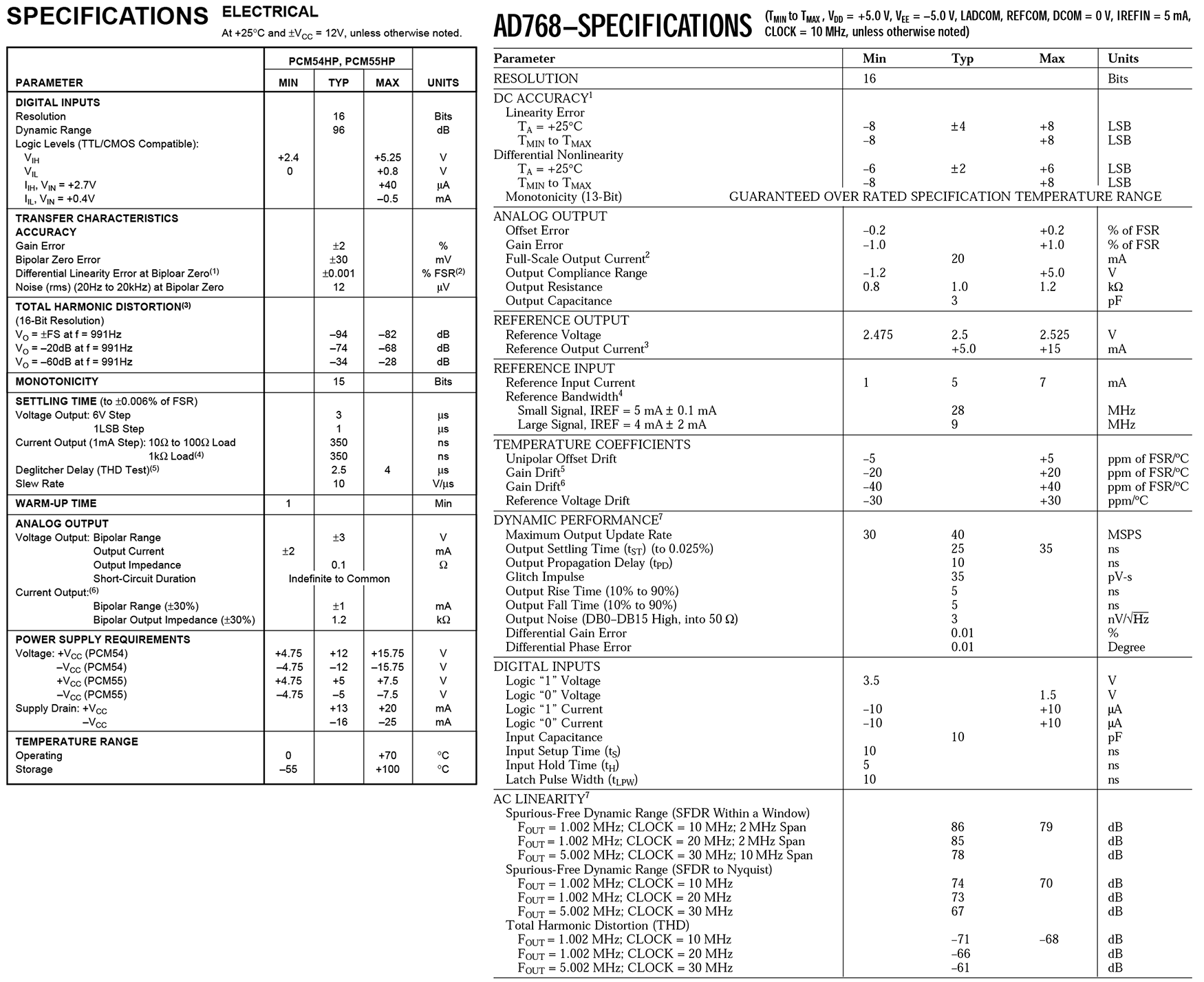

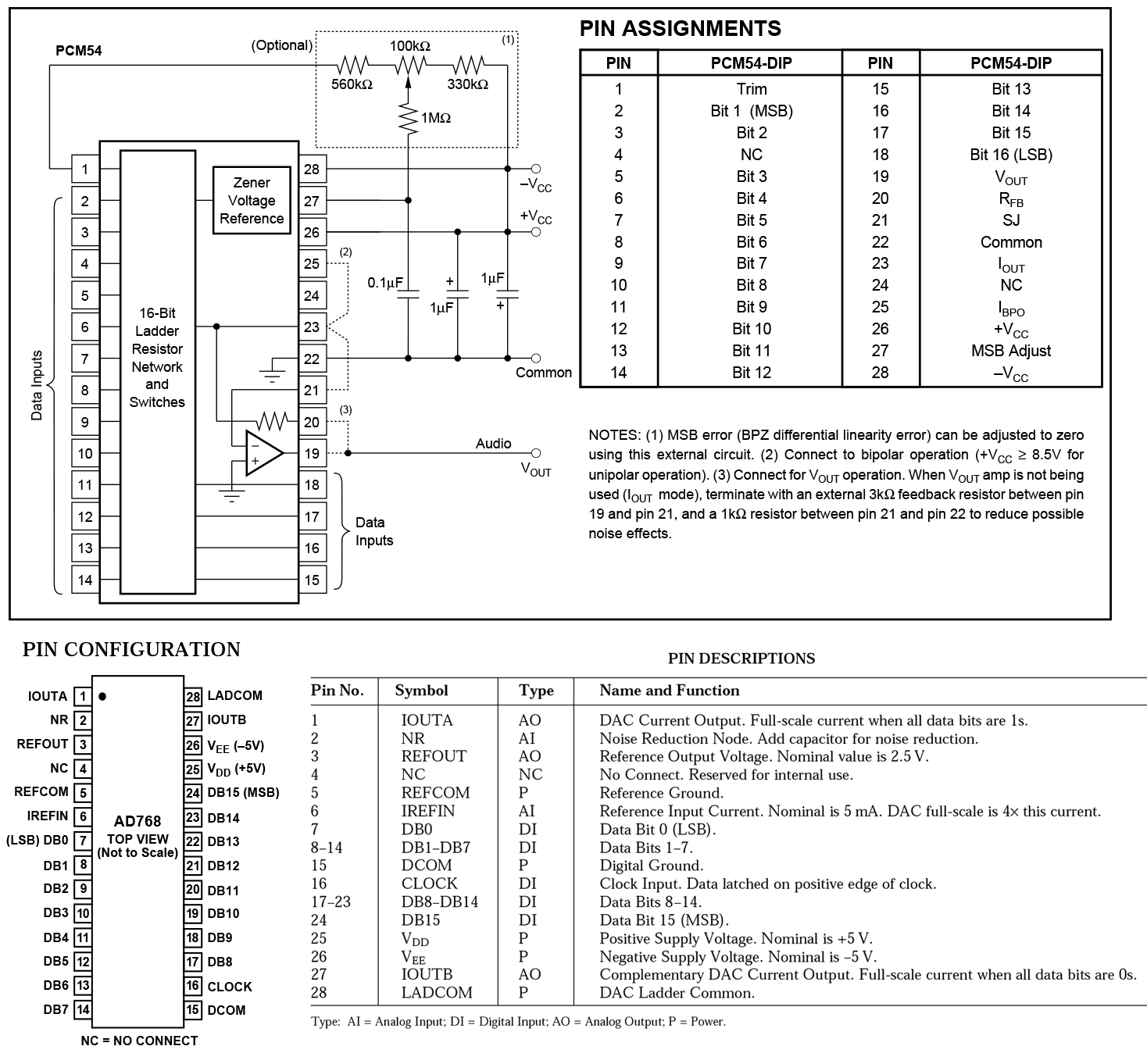

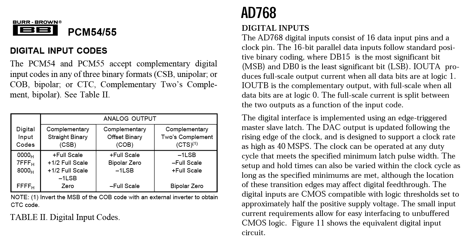

Here's some extracts from the datasheets comparing the AD768 to the PCM54. I'm not sure how to compare many of the specs but I do not that the AD768 has 10x the output current of the PCM54.

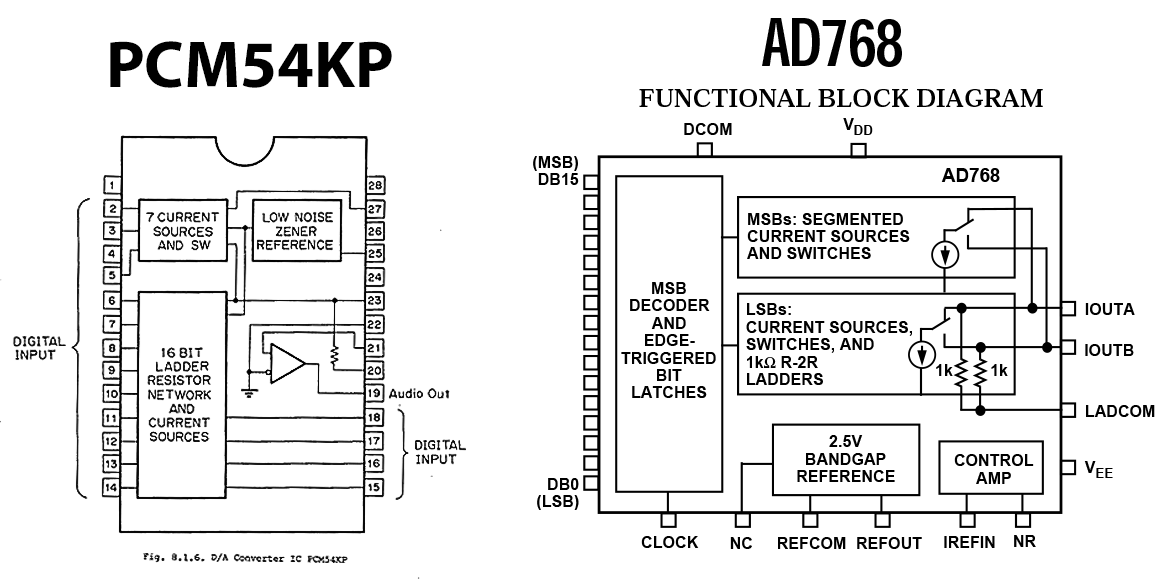

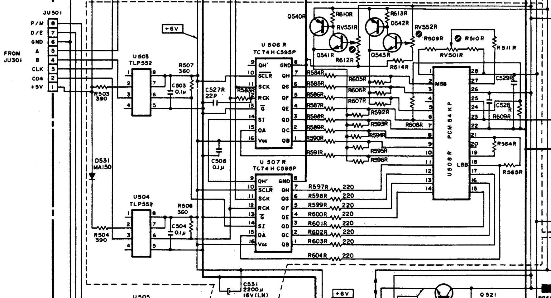

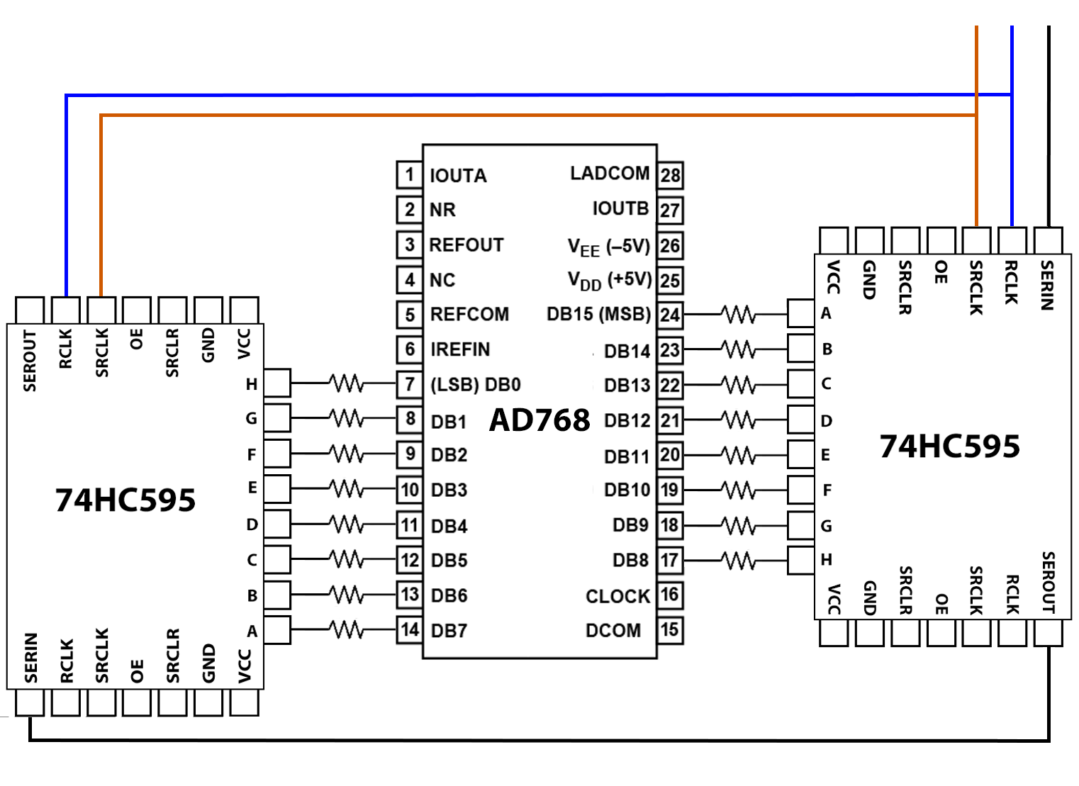

I had a look at how manufacturers implemented the PCM54 in CD players, the Nakamichi OMS-7 mkII is a typical example, it uses a pair of 8-bit shift registers to turn the serial data into parallel inputs to the DAC chip.

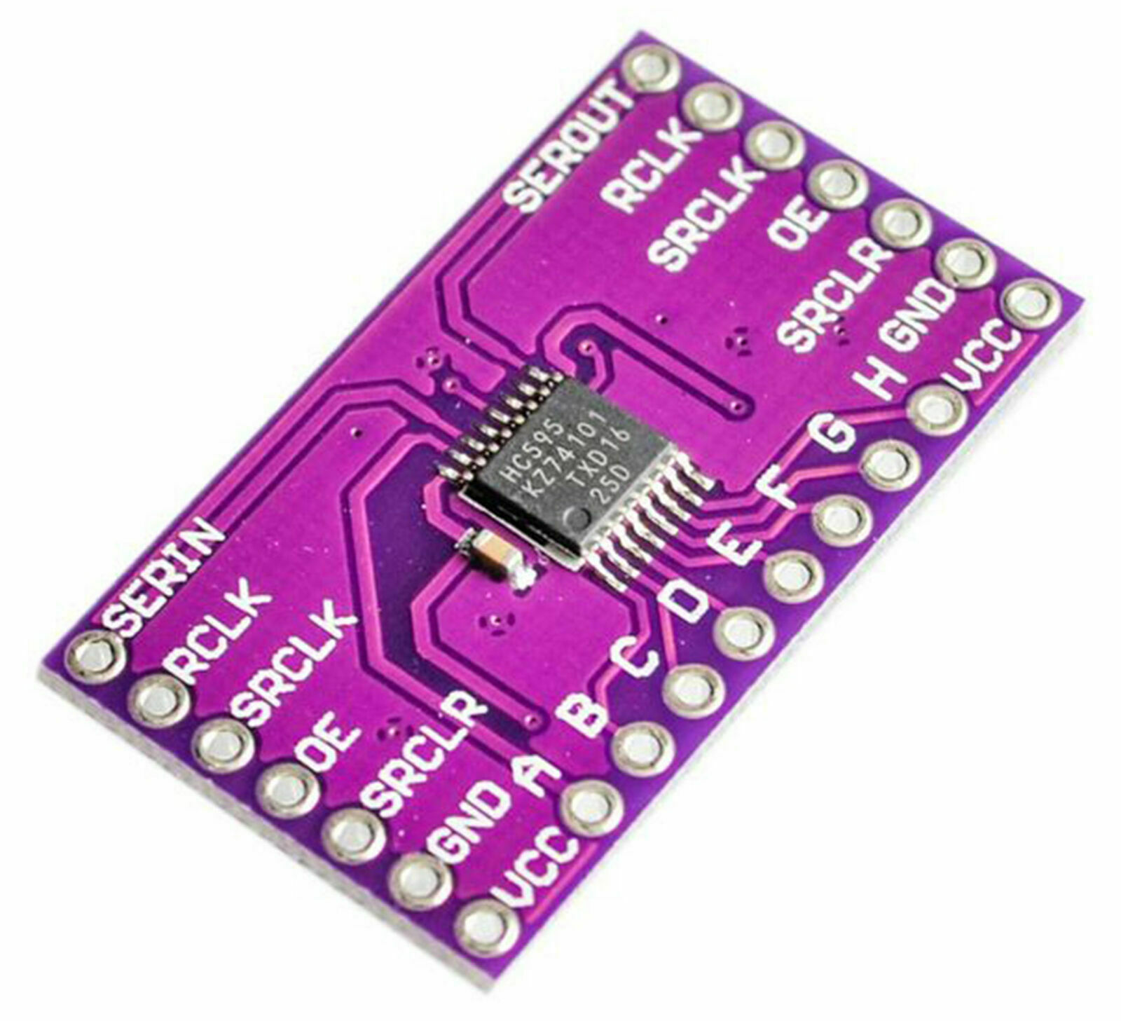

So I thought, surely you could do the same thing with a couple of 74HC595 modules to feed the AD768.
It seems pretty straightforward how to split the serial data into parallel, but what about the other two signals of the 12S stream? How would they be passed from the 74HC595s to the AD768?

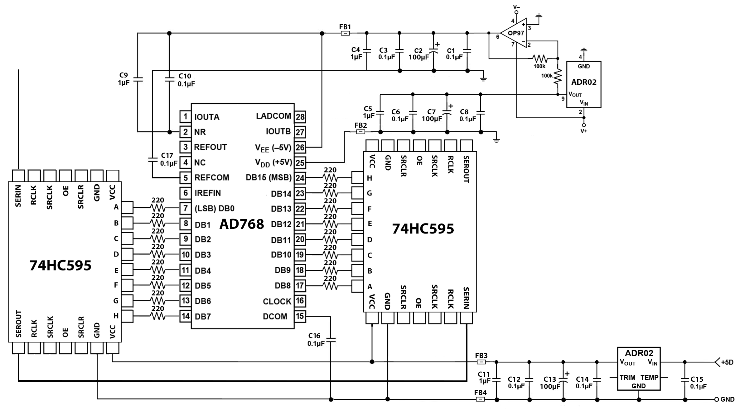

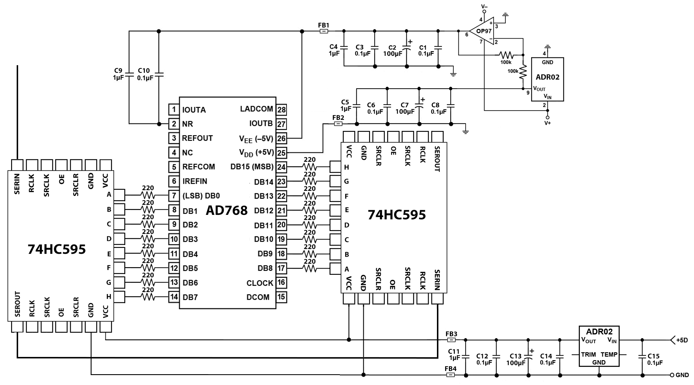

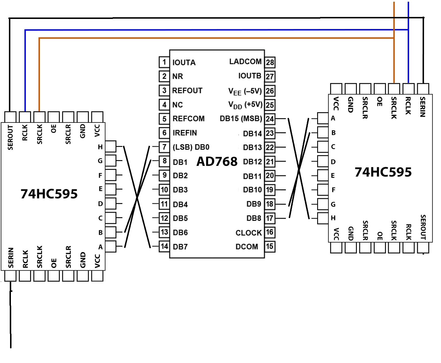

Here's a rough schematic I drew up, this is as far as I've got in thinking about how to feed I2S to an AD768:

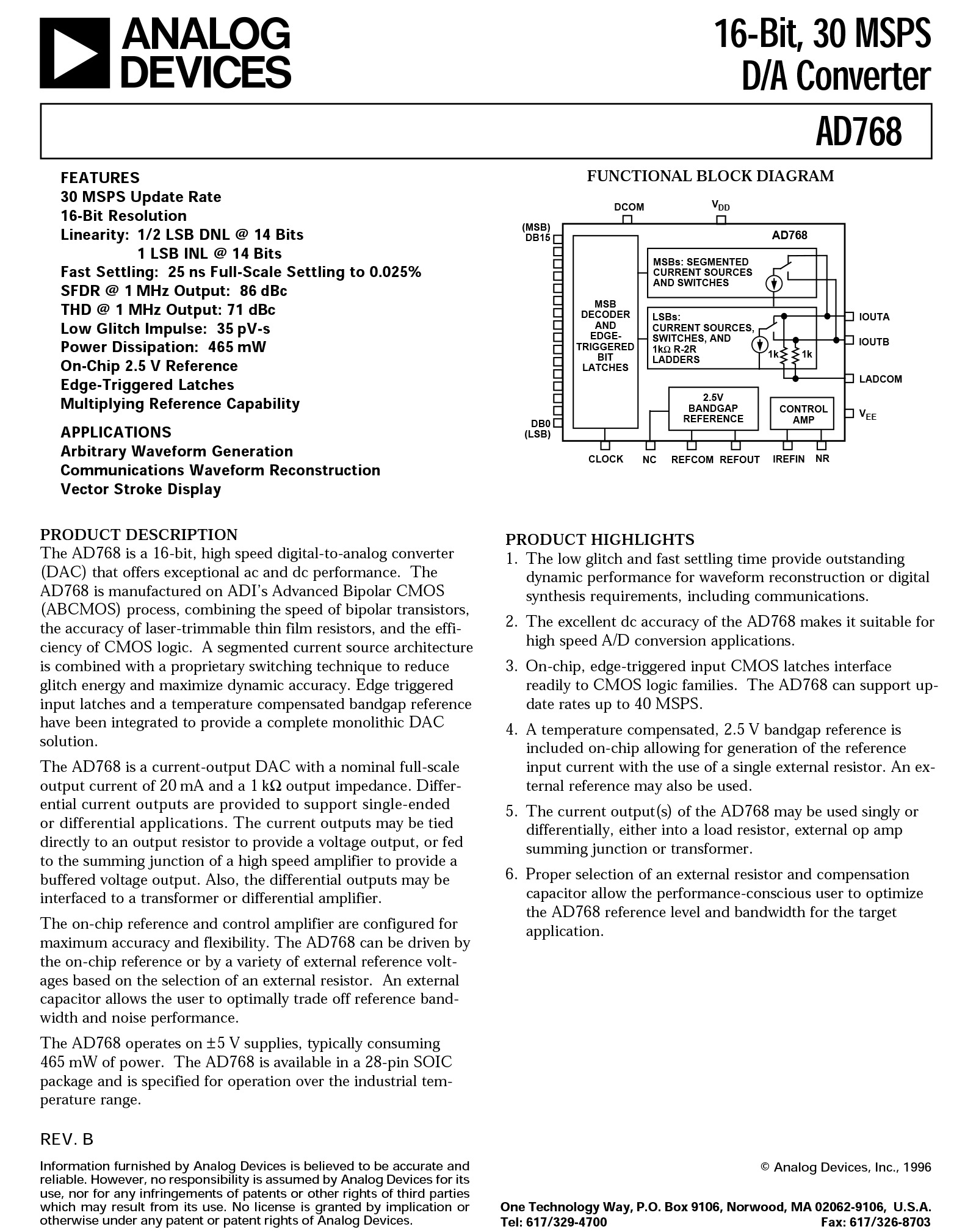

The 20mA output current is a lot higher than typical audio DACs but there is plenty of output compliance available, given one suggested application is with passive I/V.

After studying the AD768 datasheet it occurred to me that in many ways it was just like a 16-bit audio DAC, and the chips are available very cheap from China, so my interest was piqued.

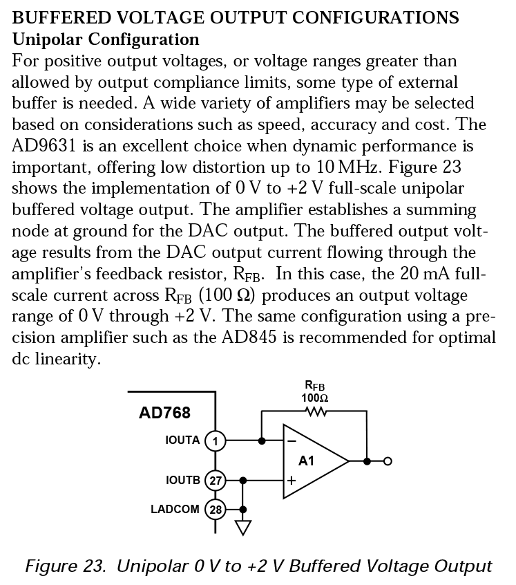

The example in the AD768 datasheet of using an opamp to turn the differential current outputs into a unipolar 0-2V reminds me of how audio DAC outputs are often used and 0-2v is basically what we would be aiming for with audio, right?

Use my schematic for the I2S to PCM splitting (16-Bits)
https://www.diyaudio.com/forums/dig...862-tht-i2s-input-nos-2r-148.html#post6533922
DB15 is the MSB, therefore change your schematic slightly 😉
It seems, like the QA on the 595's is the latch (LE) ... hard to say 😕
Cheers Miro, spotting that mistake in the bit order is immensely useful.
I shall go and study your splitting schematic, again, that is immensely useful and is exactly what I need, so I am most grateful.

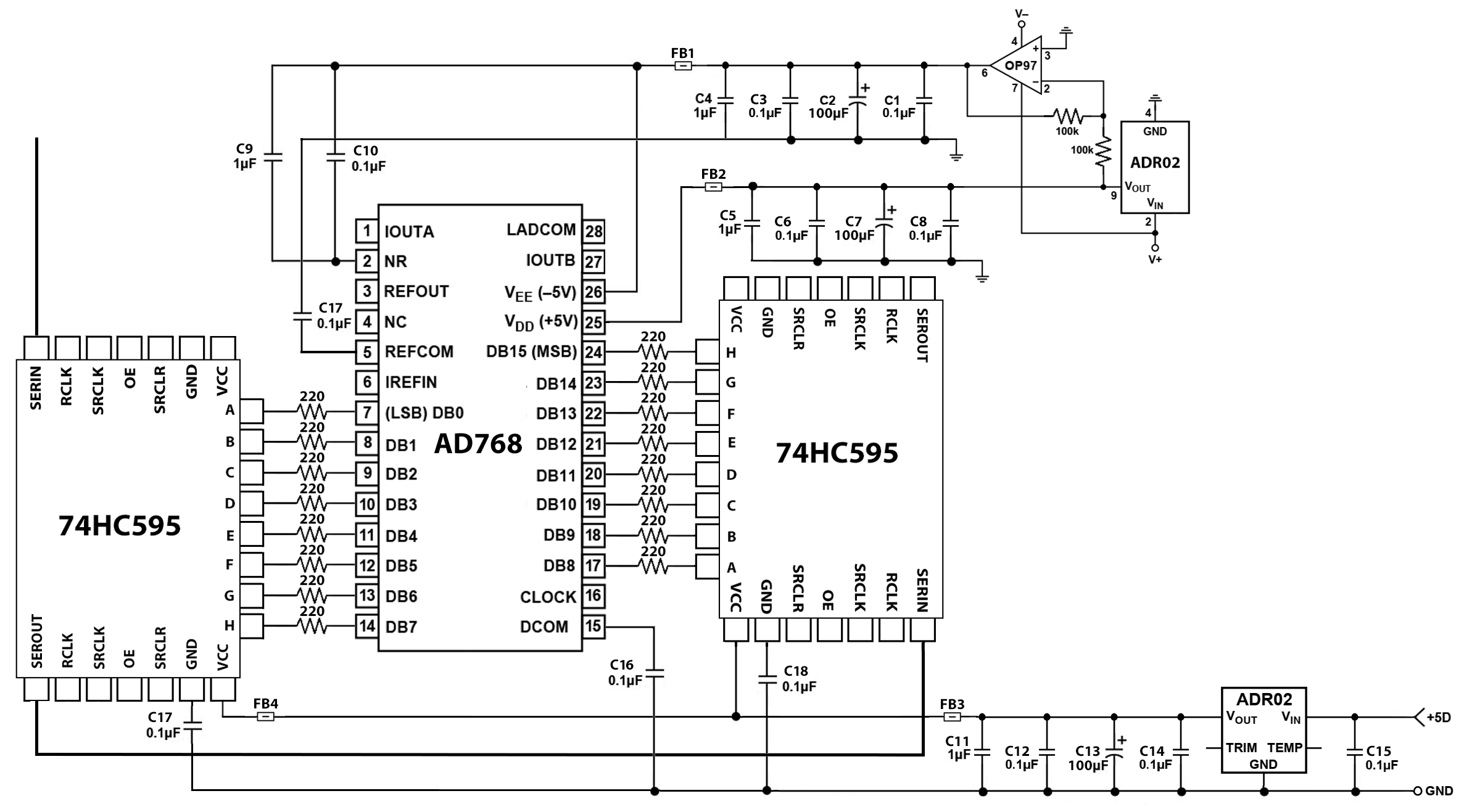

In the meantime, I have redrawn the schematic, correcting the mistake Miro spotted and added the power supply circuits. I'm using ADR02 precision 5v references instead of the good old 7805. Any thoughts, comments or suggestions most welcome. I took the power supply circuitry from the datasheets for the AD768 and the REF02 voltage reference.
@rfbrw has helpfully pointed out that this DAC works on straight binary (unipolar) whereas audio DACs get given a bipolar (twos complement) input signal. So you'll want to invert the MSB between the HC595 and the AD768.

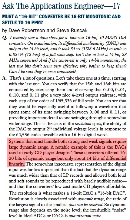

On the linearity, here's a quote from an Analog Devices publication:
So the linearity of AD768 is about the same as the earlier 16-bit audio DACs.

Do you not think sending bipolar data to a unipolar device might be an issue ?
Not at all, one AD768 per channel, I've only shown one channel in the schematics as it goes without saying that you need two channels for stereo sound.
In CD players, the bipolar data is split into right and left channels by the digital filter placed in front of the DAC(s).
Err, I don't think you understand me. The number format for audio is binary two's complement which centres the signal around zero yielding -32k 0 +32k. The number format for the AD768 is unipolar straight binary yielding 0 - 65k. I take it you can see the mismatch.
