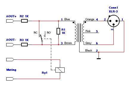

Glad you mentioned the AK4395. I am using the AK4393, its 96 kHz sister. This is a balanced voltage out DAC that can drive directly into 600 ohms: No need for a nifty I/V converter. I am driving directly a good output transformer with this tiny piece of plastic. This is sounding very good. And relaxed if you can say so.
Hi, do you have a picture of your DAC?
Not yet, I do not have a digital camera at hand. But when I have the occasion I will put up one.
It is a modified M-Audio Superdac. For 260 EU I could not make it myself. I am busy putting a x-tal locked low jitter clock in it a la Guido Tent’s tube DAC. The line transformers are type 3603 from Sowter.

hi Pjotr,
i'm very intrigued by your use of a X-former for the AKM DAC! i was just thinking about doing the same the last few weeks and just came across this thread.
i very much like the sound of the AKM DAC as used in cheap Sony DVD/SACD players, and would like to replace the whole opamp output stage of the Sony with a single transformer, followed perhaps by a JFET buffer. in this manner i can achieve buffering and low-pass filtering in one clean (and feedback-free!) stroke. what type of transformer are you using? i was thinking of getting a 10k:10k Jensen transformer, which has bandwidth of 2Hz to 80kHz or so, and a desirable Bessel function filtering effect above the passband. how does this idea sound to you?

Hi Vil,
I did not actually buy the AKM chips separately. I got a M-Audio Superdac that uses the AKM 4593. I got it from my musical instrument store for 260 EU. It is very neat build with a proper laid-out PCB. It has all the digital interfacing neatly build for me. Unfortunately M-Audio does not have it in their program anymore. But if you search the internet these are still plenty available for around $200 - $250.
Dorkus,
The Jensen transformers are for sure top of the line but these are huge expensive and overdone IMO. The transformers from Sowter are also excellent and the ones I choose will fit in the box of the Superdac. Be careful with selecting transformers. The ones you mentioned with 10K/10K impedance are intended as input transformers and are not suitable as output transformers. You need 600ohm/600ohm output/line transformers. Attached the schematic I have used. I did not implement a low pass filter. The 1K resistors lower the signal to acceptable levels for the transformer for low distortion. Also they are needed to protect the DAC chip. The relay performs the muting function and is steered by the signal that otherwise controls the muting transistors. It is a “normally closed” reed relay. It also protects the transformer for DC currents at power on and off.
Dorkus,

looks great Pjotr, thanks very much for the info - it's just what i was looking for. do you find it performs ok w/o any sort of buffering after the transformer? assumming of course we use reasonable length/capacitance cables, etc. the Sowter xformers sound interesting, do you know offhand how much they are? i'm wondering if after international shipping they'll still be much cheaper than the Jensens.
