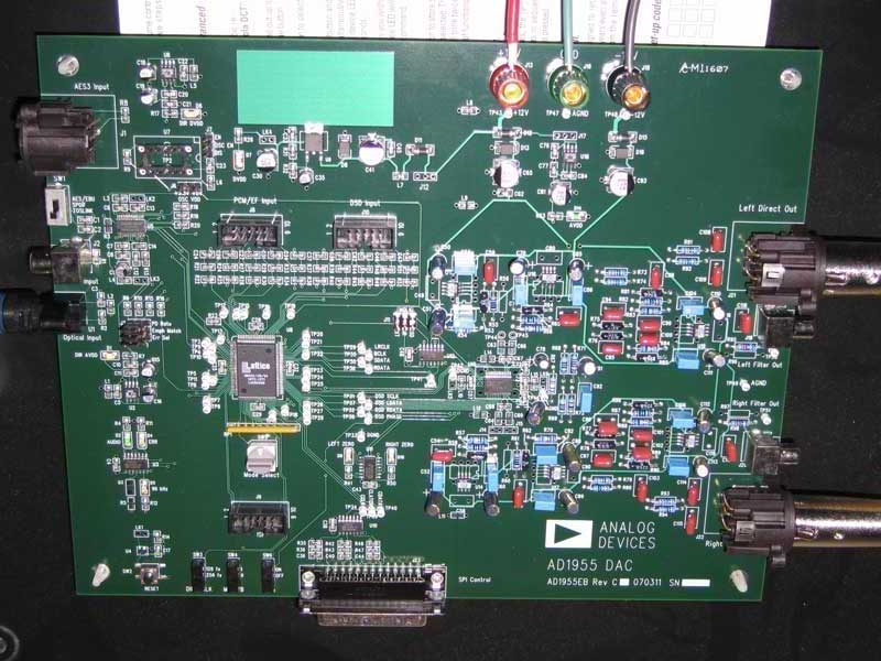

ad1955 evaluation board ad1955eb.pdf
Finaly got to pay for and order one, can take up to 4 weeks to get to Australia I was told by AD Australia
Here is a pic I found after much searching.
Circuit and Data sheet is in the first post of this thread.
Cheers George

Given that the bulk of the effort on the AD board has gone into the output stage, it does seem a rather expensive if you are going to bypass it all and use the zapfilter. Perhaps you could have commisioned a more suitable design.
I wanted the AD1955 because it's sacd ready as well, and I have no idea how to build from input that's aes/ebu or 75ohm spidf ready with all the other components that are involved before and including the dac chip, also it's all Cirrus Logic at the front were the HD970 is all AKM, this also will sound different.
To me the output analog stage is by far the least complex part of this eval board and I'm confident playing around in this area, but all the digital stage, I may as well be looking at Hieroglyphics.
Cheers George

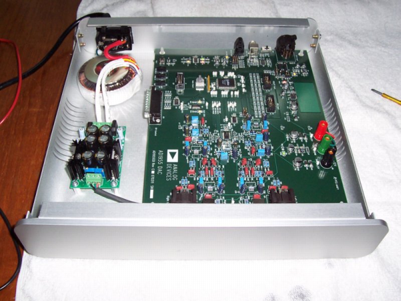

Mine arrived today, not bad 16days from payment to delivery, hope to find the time soon to mount in a nice case, and a separate case for 2x 12vdc recharable batteries with charging system. It's quite a big board, you do get your money worth, very nice quality components.

Hi George,
I'm gald you like your board as well. AD spared litte expense with the passive components. There might be opportunities to upgrade the PSU regulation, but it's quite good as is.
A prior post mentioned batteries. TNT audio did a very interesting evaluation of batteries and found them noiser than well regulated supplies. The AD3303 LDO regulators after the LM3xx's on the AD1955 eval board are very nice and they come mounted on the board. Just a thought to consider.
I wish the other DAC vendors took this much care in building eval boards.
-David

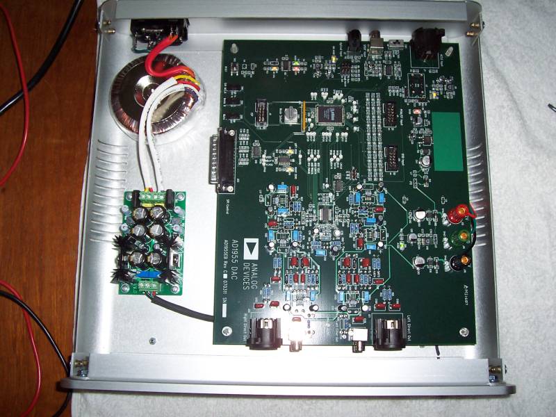

AD-1955 Evaluation Board
Finally found the time to get it together with a supply, and it does sound very very good.
It beats my favorite standard non modded Harman HD-970 (also a AD1955 with discrete class A output). It sounds just as detailed and as smooth, but with a little more drive and dynamics.
But it still can't match my benchmark a Harman HD-970 with a discrete transimpedance I/V stage and a discrete class A transistor output stage, powered by a shunt regulated supply, this Harman is almost scary to listen to, it has all the smoothness of the standard HD970 and the AD1955 Eval Board but when the crescendos build or drums get hit hard it is very scary to listen to, it's as though it has a DBX (dynamic range enhancer) built into it, yet still stays smooth and airy when needed.
I really believe now that a transimpedance amps as I/V stages who's input represents a short to output of current output dacs such as the AD-1955, is the only way to go, it is a massive change to my ear for the better, especially dynamically, that said on some systems that have problems with slight hardness's or harshness it could be detrimental to those systems.
I'll post 3 pics of the AD-1955 with it's power supply and box.
Cheers George
