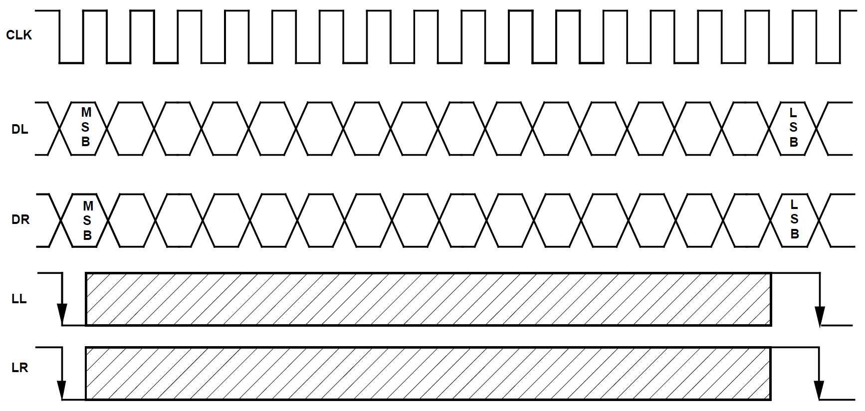

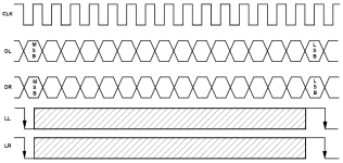

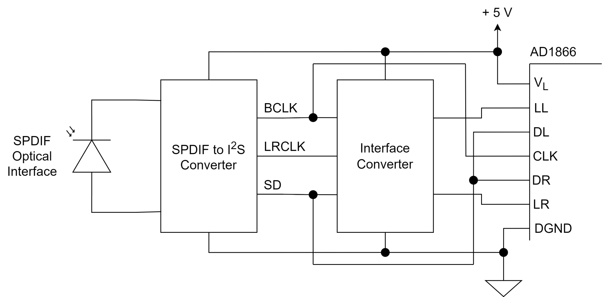

Any ideas about how to convert optical SPDIF to the AD1866 interface format?

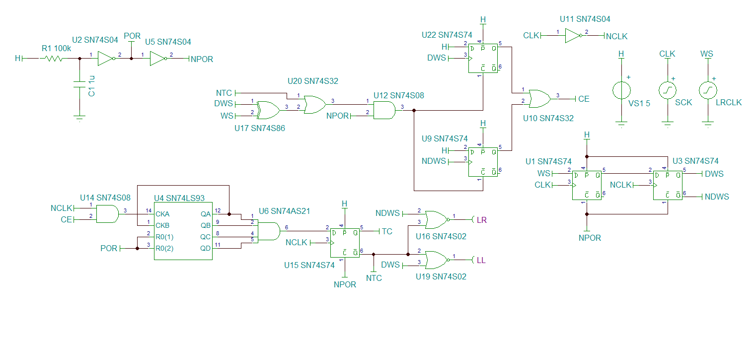

I was thinking about using a SPDIF to I2S converter, similar to this and then converting the signal to the AD1866 format, in this case only the latch signals need to be modified (LL and LR). Do you know if any board with this functionality is currently available for purchase in europe?

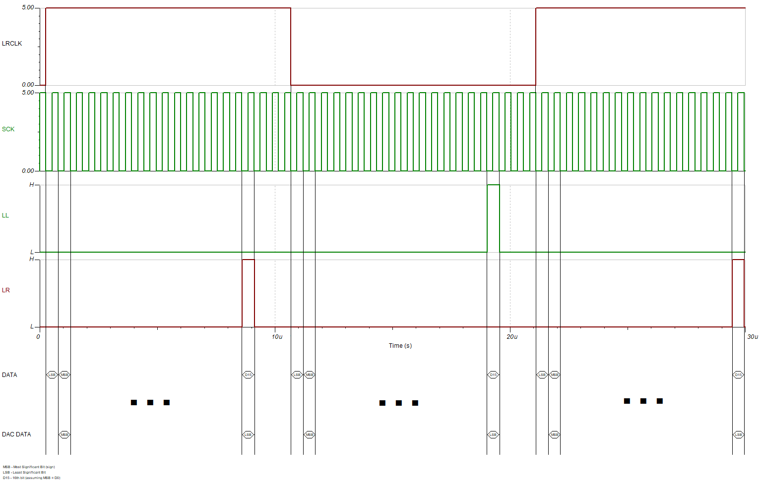

To produce the LL and LR signals I have designed a circuit using the 74 series logic family, it seems to work on simulation, but I don't have a clue if it actually works in practice, also, this circuit is a bit complex and requires a lot of ICs. Only faster digital devices 74FXX or 74SXX seem to be quick enough for sample rates of 88.2 kHz and over, 74HCXX and 74LSXX, only work for 48 kHz or less. I also have an Arduino Due board, do you know if it can be used for the format conversion? Is there any simple way to convert optical SPDIF or I2S to the AD1866 format, using only one or two ICs?
I have attached a few pictures of the block diagram, interface conversion logic circuit, timing diagrams and a TINA SPICE simulation file.

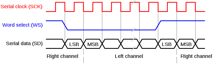

Given that AD1866, like most R2R style DACs uses a right-justified data format it would probably be a simpler solution not to go via I2S. All modern S/PDIF decoder chips that I've met have the capability to output various formats besides I2S, I would choose an output format closer to what the DAC's expecting. That'd normally be some kind of right-justified format - at least then the WS/LRCK signal would start out in the right place relative to the data, unlike with I2S.
Thank you very much for your reply abraxalito.
Maybe I can use a S/PDIF converter board, based on the DIR9001, for example, and then I can set the format to 16 bit MSB first right-justified. LR can be directly connected to LRCLK, LL requires an inverter gate.
Do you know where I can get a clone of the eval board of the DIR9001 or a chip with similar funcionalities for a lower price, do you know any supplier that delivers such boards in europe?

For the latch signals I still need an inverter gate, for the left channel. Do you think a 74HC04 is quick enough, or I need a 74F04 or something even faster?
I will try to order this board or a similar one.
I think HC04 (or a single gate version) is going to be plenty fast enough when run on 5V. The quickest inverters are the unbuffered ones so if you worry about speed, go for 74HCU04 but I think the plain one will work fine.
