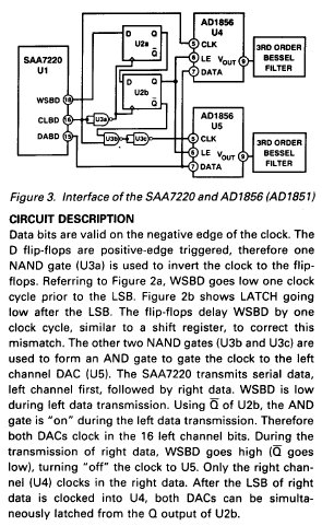

Hi Friend,
I have founded on the internet who i make a 2S output from IS2. But I don't KNOW hor is the interface of the AD1865. Do you KNOW?
http://www.homestead.com/whaan/files/44k1_dac.html

Steady on. To quote maxlorenz, "I was only trying to help". There is no need to shout. Yes I have some ideas about what to do but that is all they are, ideas. They are people in the forum with a lot more experience with the PCM USB chips and the AD1865 than I. If you start a thread with PCM2707 in the title you are far more likely to attract their attention.
