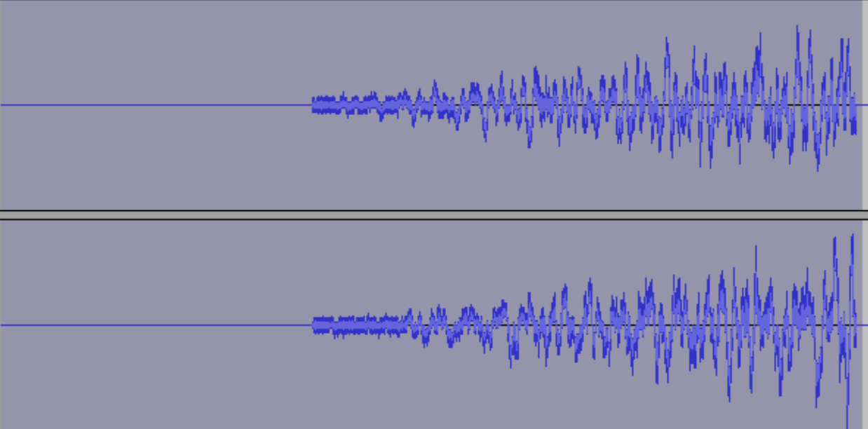

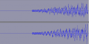

As I don't have that particular CD on this computer, here's the first 4s of another classical CD - Rattle's Beethoven 2nd Symphony, Vienna Phil. Its had 50dB gain applied. The extent of the window (vertically) is the full scale.
The noise comes after the elapsed track time starts showing i.e. when the CD player is producing non-zero bits for my DAC but the performance has yet to start.
That's 4 seconds? You say that the DAC anticipates that the music will start playing in the next two seconds and raises the noise? That implies that it has some kind of time-delay line, buffer memory. Or has some other kind of time-travel device inside.
I took this to mean that the recording has started playing back, but the performance hasn't started so we're listening to the acoustic that the performance is about to take place in.
Some people will apply proper silence in periods like this whereas others will simply let us listen to the acoustic.
Certainly if with one CD this period is noisy and on another it is not, it implies that the noise is actually on the CD so we're not actually listening to zeros but a signal of some sort.

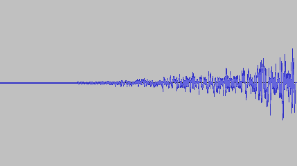

Here is an example of just that happening. This is the opening of of Strauss' 4 last songs as sung by Renee Fleming.
This is with 57dB of gain applied. The start is true digital silence and what follows it is the noise when the faders go up, the performance is still yet to begin.
If a recording didn't have true silence put in at the start you'd get noise playing as soon as the track starts playing.

Yes, the noise floor on those CDs is only ~60dB below maximum amplitude.
Please explain the steps you took to determine this from the waveform I posted?
Exactly! The DAC doesn't know when the music is about to start, but the mixing engineer knows. He raises the faders up right before that and we see the analog noise.ICertainly if with one CD this period is noisy and on another it is not, it implies that the noise is actually on the CD so we're not actually listening to zeros but a signal of some sort.
The 2 seconds "before" noise modulation is not happening in the DAC, is in the mixing console. DAC cannot hold that much data to anticipate for 2 seconds.
I think all the S-D DAC's do that - it is called "zero detect mute".One is that the DAC, when fed with digital zeros, actually holds the output in a muted state so that any noise the output stage of the DAC might intrinsically produce is not heard. However when fed with something less then zero, the output is engaged and the true noise floor is revealed. Here the encoded noise is below audibility, but the DACs own intrinsic noise dominates and you hear it.
Well determining the exact level of the noise it does not, but it does put you in the ball park range. I posted my own version of what you posted in post 33. The signal has been amplified by 57dB. The start shows no change as that's true digital zero, but then the noise gets boosted right up to 0dBfs as soon as the faders are brought up. The real noise floor of that environment is clearly around -60dB.
Of the wave-form you posted, you never mentioned if it is one of the CDs that hits you with noise as soon as the data stream starts. Regardless of if it does or doesn't, if your system really is playing back noise with some CDs and not with others, then you need to investigate exactly why this is so.
