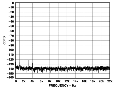

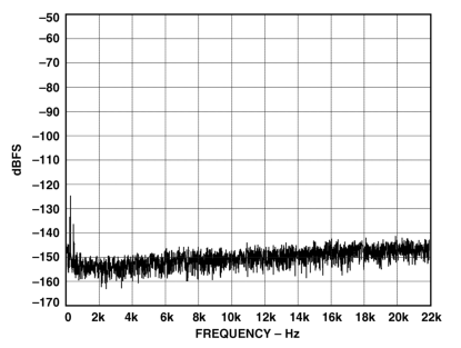

Ok here are the two plots I posted there - I realize now you have to sign up to see them.
What's hidden (because these are FFTs) is any short-term changes in the noise floor. FFT is just showing us the average noise over the acquisition window, but we know that the noise out of an S-D loop is instantaneous level dependent. ESS's Sabre datasheet shows that - the noise varies with DC level.
The noise spectrum is also dependent on the signal level - notice how it slopes upward with zero signal, but ostensibly remains flat with a full-scale sinewave present. Thus we can expect the timbre of the noise to be a dynamic thing.
If you think multibit has the same issue, then post up the plots to show it.

You're making the common misinterpretation of an FFT. The data points represent noise voltage into a very narrow bandwidth - much narrower than the critical bands in the ear.

Post up your data then to demonstrate that it can't be noise modulation. Further mis-readings of FFT data will attract ridicule. 😛

What we have is evidence that the noise floor is changing - between a full-scale signal and a very low level (or absent) signal. For 67% of the time the sinewave's (assuming its 0dBfs) instantaneous amplitude is at or above -6dB. Its spending almost no time at all down at the -100dB level. But music is quite a different beast - with much higher crest factor than a sine. It spends more time down at lower instantanous levels.
