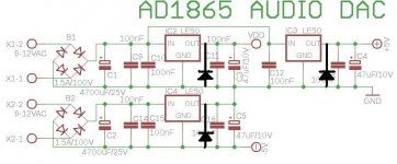

Im thinking of using Mic5207 regulators in adaptors instead of Salas regs, in order to keep the size of construction more compact. I was looking the datasheet (http://www.micrel.com/_PDF/mic5207.pdf) and saw this :
"Dual-supply operation.
When used in dual-supply systems where the regulator load is returned to a negative supply, the output voltage must be diode clamped to ground."
Is the orientation of the diodes correct in the attached picture?

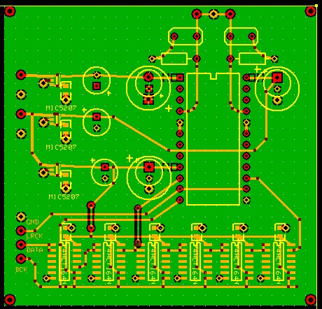

Creating a double sided version with a ground plane is a very interesting idea (and easy enough for my amateur level).

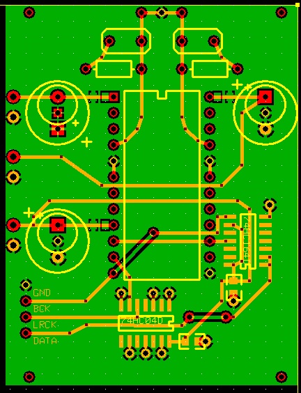

I created a ground plane version on ExpressPCB (havent etched it yet) but i am hesitant to post it here 😱
I will post it tomorrow so be gentle with my silly mistakes 😀

First thoughts:
power tracks could do with being a bit thicker, same width as signal traces.
The SMD caps next to the pins on the large IC could do with moving away from the pins a bit, this will ease assembly especially soldering.
Try and keep traces either 90 or 45 degree, a minor thing, keeps things looking tidy.
Vias look close to decoupling caps on chips on the bottom of the board.
Large capacitors cover SMD caps footprint on large chip, high frequency SMD decouplers need to go next to pins, larger ones can move away from pins.
Don't use thermal relief on Vias, it is not needed.
Other than these minor points well done for a first attempt.

Thank you marce for your kind words and suggestions. Really appreciate it
I will do modifications based on your suggestions.
The tracks have all the same thickness (0.51mm), maybe resizing the screen capture caused some distortion on the image presenting some tracks thinner.
