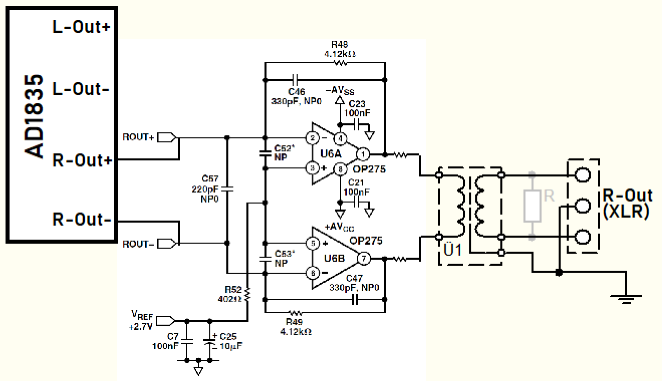

I'm stuck with an old DSP PreAmp (cannot afford a newer one...) which works well, but does D>A with AD1853 followed by OpAmp I>V conversion and OpAmp driven Cinch outputs.
I'd like to implement balanced outputs and noticed applications which "just" use a 1:1 (or 2:1) Transformer with the DAC Chip Out+ and Out- and connect the transformer secondary to the balanced Cables/XLR.
My question (for lack of DAC knowledge):
Could I just cut the existing I>V (i.e. just not use both the existing I>V and the buffers driving unneeded cinch outputs) and instead connect the AD1853 Out +/- pins (12/13 & 16/17) directly to e.g. Lundahl LL7401 or LL2811 transformers' primaries and have the respective secondaries drive the balanced cables to the (already) balanced PowerAmp inputs?
Which other things should I consider? (Note: Volume control ist done in the digital domain, the existing PGA2310 is disabled anyway).
Thanks for your suggestions!
Winfried
With a transformer output you need to implement the I/V conversion by a resistor either on the primary or on the secondary (or both).
But please note that the AD1853 needs an 1k load, and the balanced output transformers need a low impedance source drive, 10 ohms or so. The lower -3dB point can be calculated with the T=L/R formula, where T=1/ω, and ω=2 x π x f. Unfortunately L is not found in the data sheet, you need to measure it. L is the main inductance, measured with open secondary, in contrast to the leakage inductance which is mesured with shorted secondary.

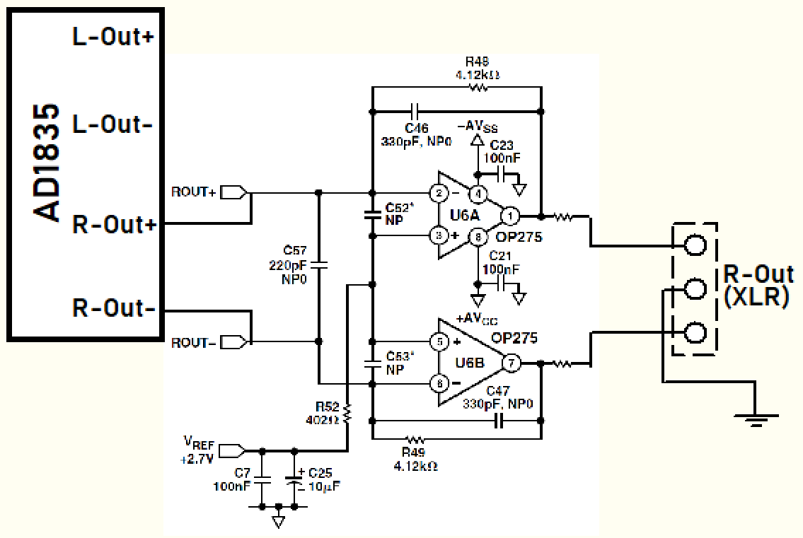

Well, looking at the App Fig. 29 it seems to me like that would provide reasonable decoupling of the DAC Outputs and may serve as balanced Output (if using appropriate Cable Drive capable OpAmps), maybe even replacing an output transformer:
attachment.php
attachment.php
What are your thoughts about these alternatives?

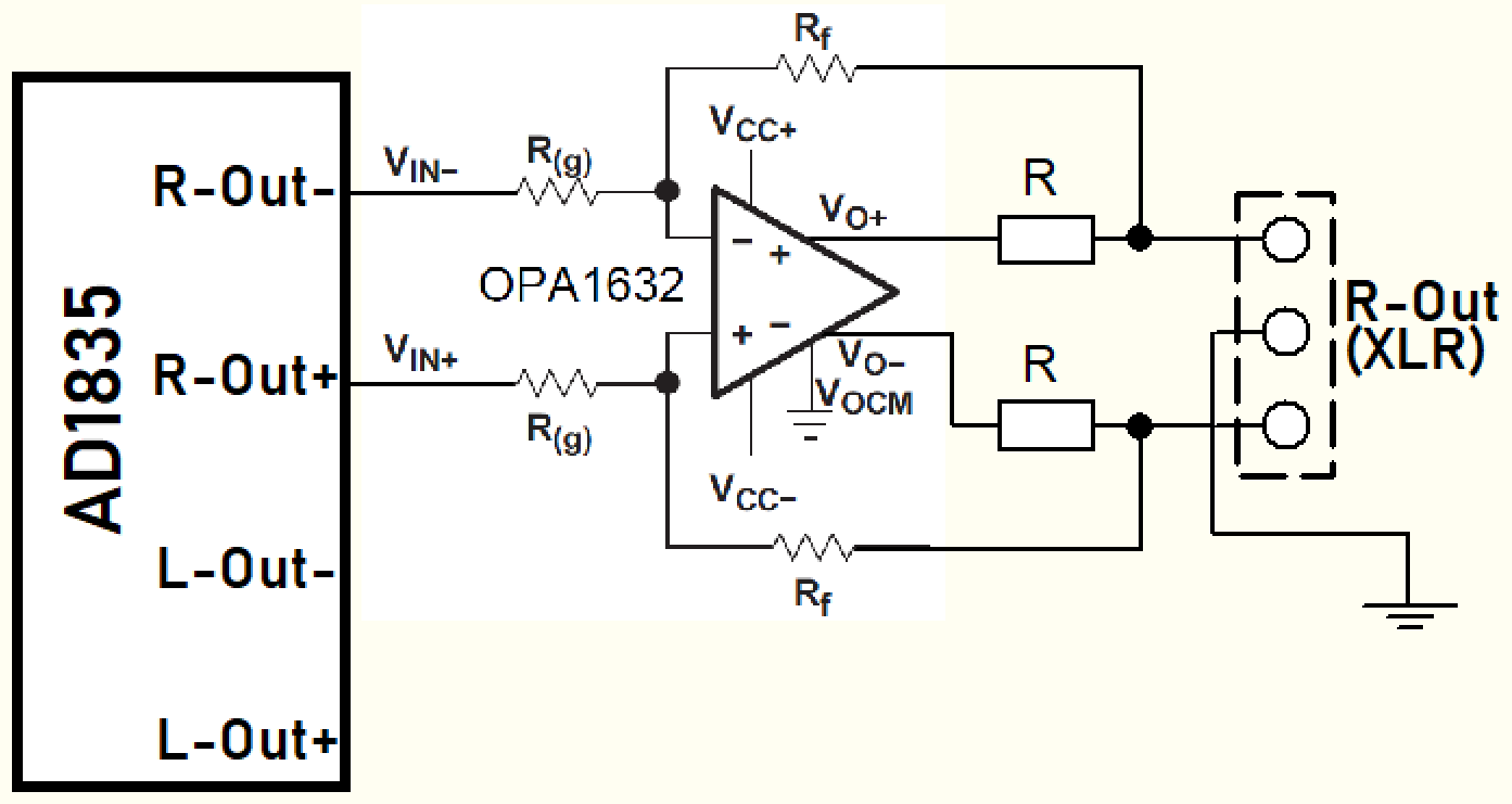

By way of some more research, another alternative came about: Usage of a dedicated Differential Line Driver. This seems quite simple, as this way the min. 1kOhm load for the DAC outputs can easily be implemented by matched R(g) and Gain with matched Rf, only one OPAmp per signal is employed and drive capability is inherent:
attachment.php
Looks almost too simple to be true (careful Vcc+ and Vcc- decoupling will obviously be added). Suggestions would be appreciated.

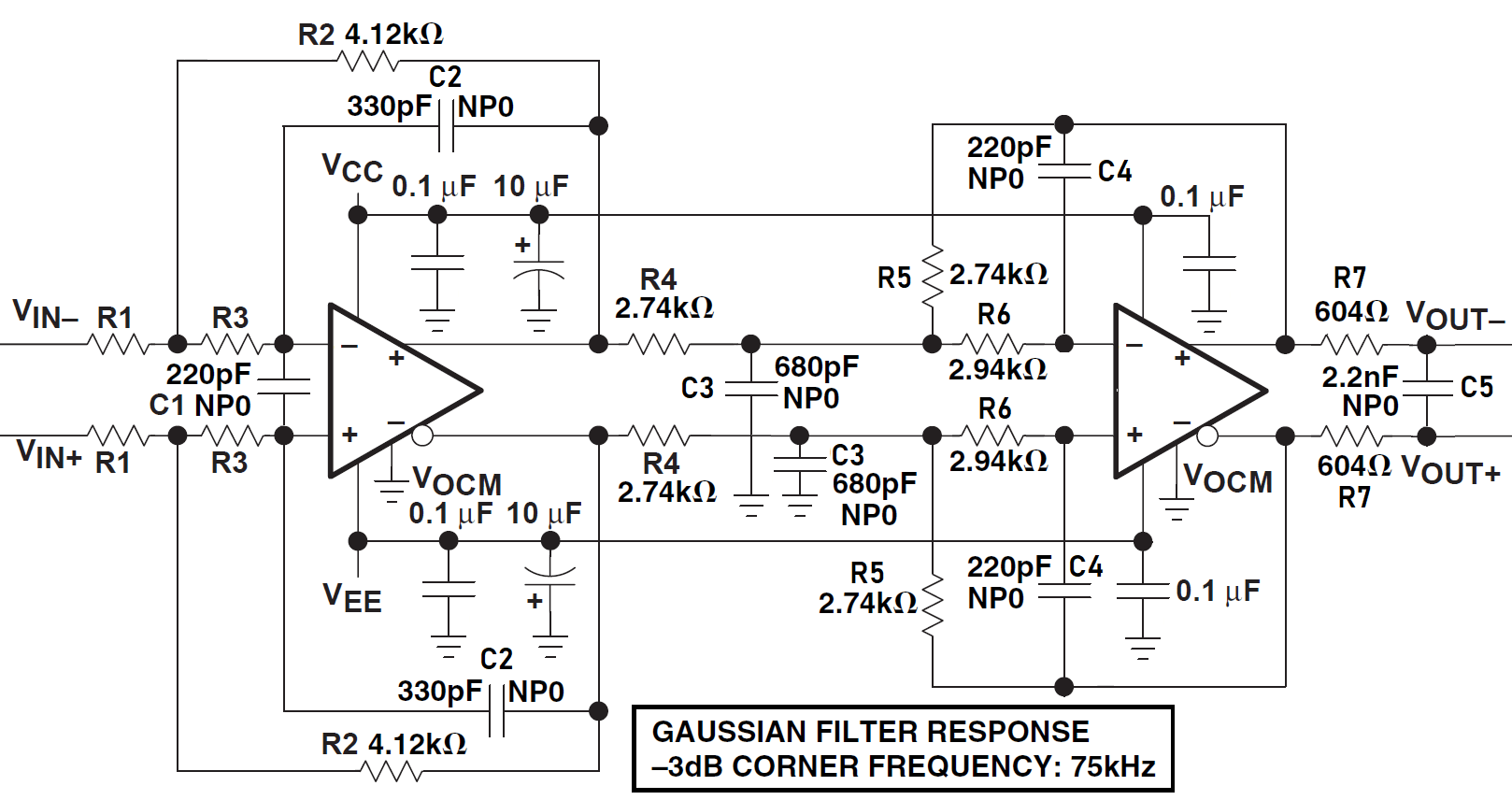

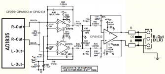

Hi Jean-Paul,
appreciate your comment! As I said, I'm not at all a DAC expert 😱 and was unsure about the necessary filtering. so, I have modiefied the schematic according to the AD1853 app notes:
attachment.php
Feedback is appreciated, so I can develop a final solution.
The feedback request is actually valid for the transformer approach as well, as it currently seems to me that a transformer solution may be technically equivalent, but at significantly higher cost!
Thanks and regards,
Winfried

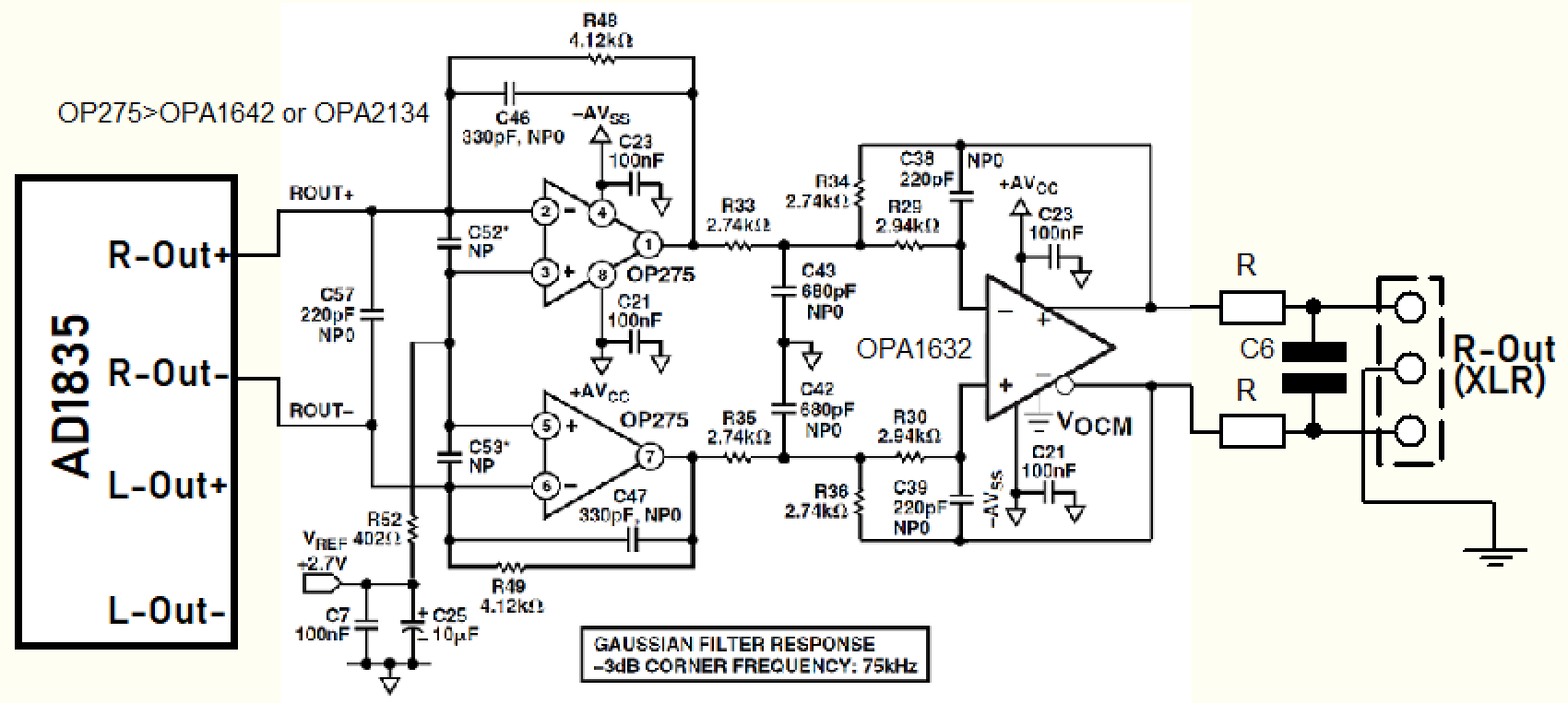

OK folks,
I've had a closer look at the IV Application in the AD1853 DAC Chip Datasheet and also found an IV Bufferproduct called "Zapfilter" made for CD Player modification from LC Audio in Denmark (supposedly compatible with AD1853).
Here's an impression derived from the LC Audio website:
This lead to the following implementation idea based on the AD1853 AppNote, but using 2x OPA1632 instead:
The question left for me are the values of R1 and R3. According to the Zapfilter a low value would be appropriate, but actually, I have no idea on this important detail...
Hoping for help here,
