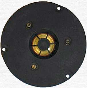

AD0161, AD0162, AD163 or leak tweeter
I have the philips 22rh480 skeapers
(22RH480)
i want to change 02 tweeter (5HH17SD-16Ohm = broken).
people help me to choose tweeter: AD0161, AD0162, AD163 or leak tweeter??
the shop near me have AD0162 T8 philips and leak 15 Ohm
So:
1, AD0161, AD0162 and AD0163: Which's better?, i should select AD0162 or find AD0161, AD0163?
2, tweeter philips and tweeter leak: Which's better? i should select AD0162 or leak 15 Ohm?
help me, plz .... (sory, my english is bad, hope people don't angry)
hi sjp,
The AD* tweeters you are reffering to are philips dome drivers from the late seventies / begin eighties, the 61 and 62 have mylar (yellow) domes and, when compared to more modern - danisch - tweeters, produce a relatively raw top end without much finesse. The 0163 employs a fabric dome and tends to sound slightly better, softer and more detailed. Make sure to adjust the series capacitor when swapping the old 16ohm tweeter for a 8 ohm model, these tweeters don't like anything under 3500 hz.

Thanks. So, if i dont want to change the capacitor, leak(15ohm) is best choose? is the sound of leak softer and detailed?

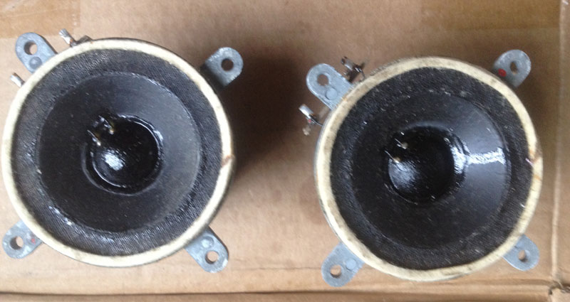

My tweeter 5HH17SD to be broken
(link: Kết quả tìm kiếm Google cho http://img5.blogs.yahoo.co.jp/ybi/1/07/bd/cfil0/folder/68551/img_68551_1441453_1%3F1320739425)
What do you think if I change it by “Sansui T-104 Horn"
link: Sansui T 104 Horn Tweeter Driver 14 Ohms 20 Watts SP 3500 SP Series | eBay
+ Same horn
+ Same made in japan
+ Same 20W
+ Same side
+ But one 16 Ohm, one 14 Ohm. If I choose 14 Ohm and don’t want to change the capacitor, the sound is bad????? I fear that. Some one say no problem, are you sure?
+ Sophistication: Sansui T-104 better than National 5HH17SD or else??
Who say me the true ... help me, plzzzzzzzzzzz
Hi sjp,
Swapping a 16ohm tweeter with a 14 ohm model while preserving the original filter values will slightly up the crossover freq. From a power perspective you're safe, the new tweeter will dissipate a fraction less power. From a listeners perspective the increased crossover frequency could cause a small dip but chances are you won't even notice.
I would advice against using dometweeters and definitly go for the sansui horn as both being horns will make them a better match sensitivity wise.
