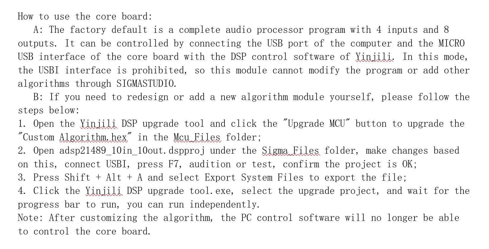

That certainly looks like a lot of HW for $100! If I read their listing correctly you can either use their GUI (miniDSP like) or use SigmaStudio to program directly via the USBi interface. Keep us posted!

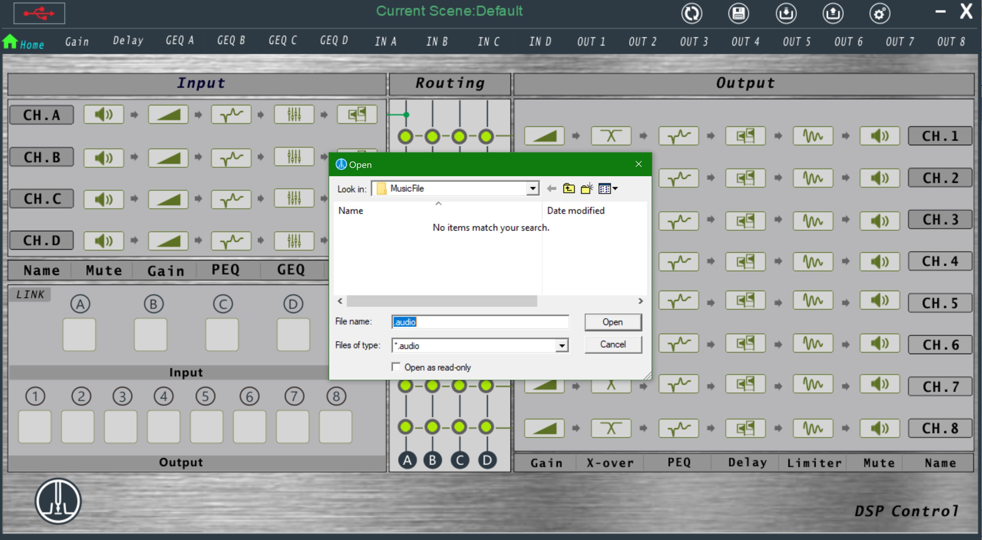

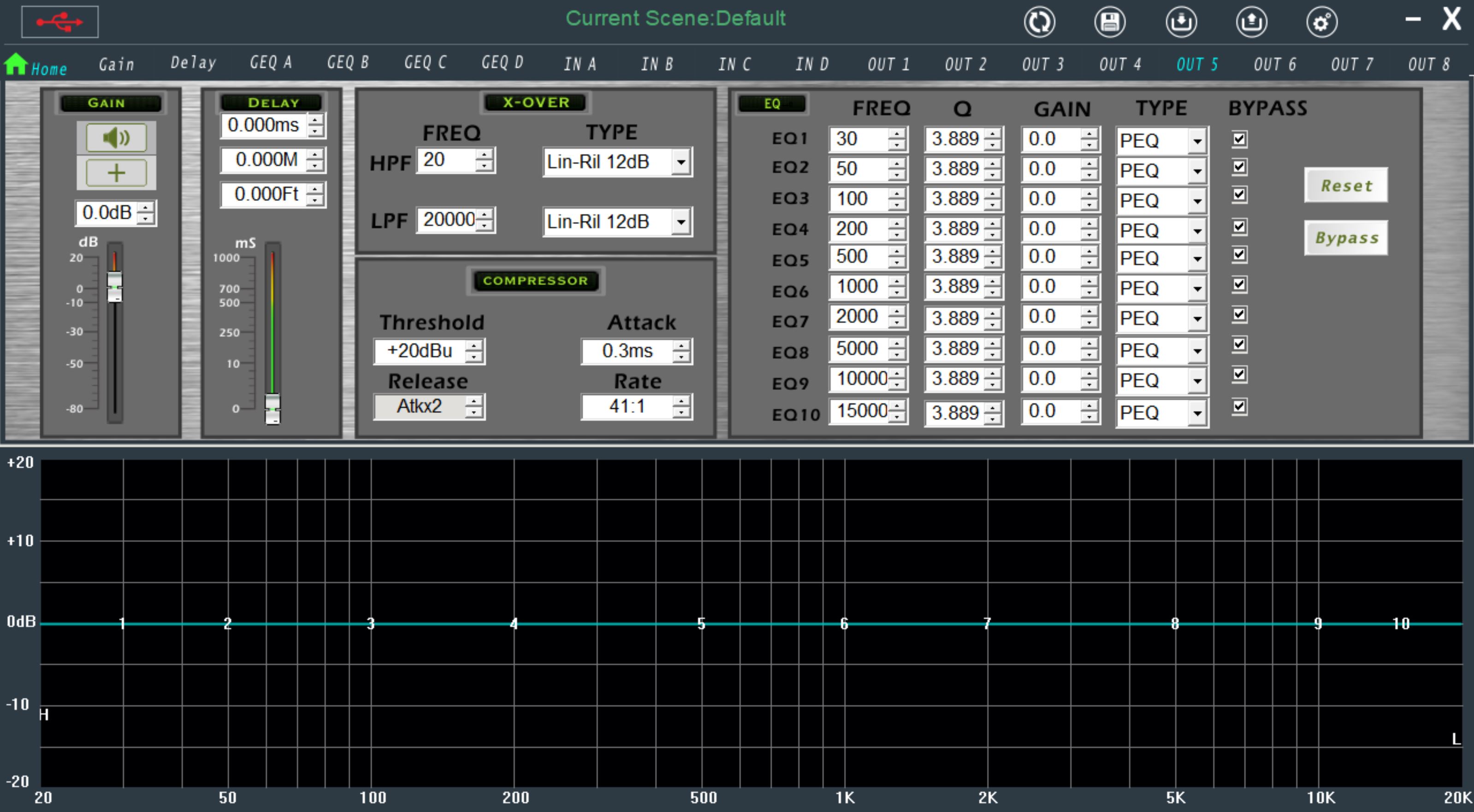

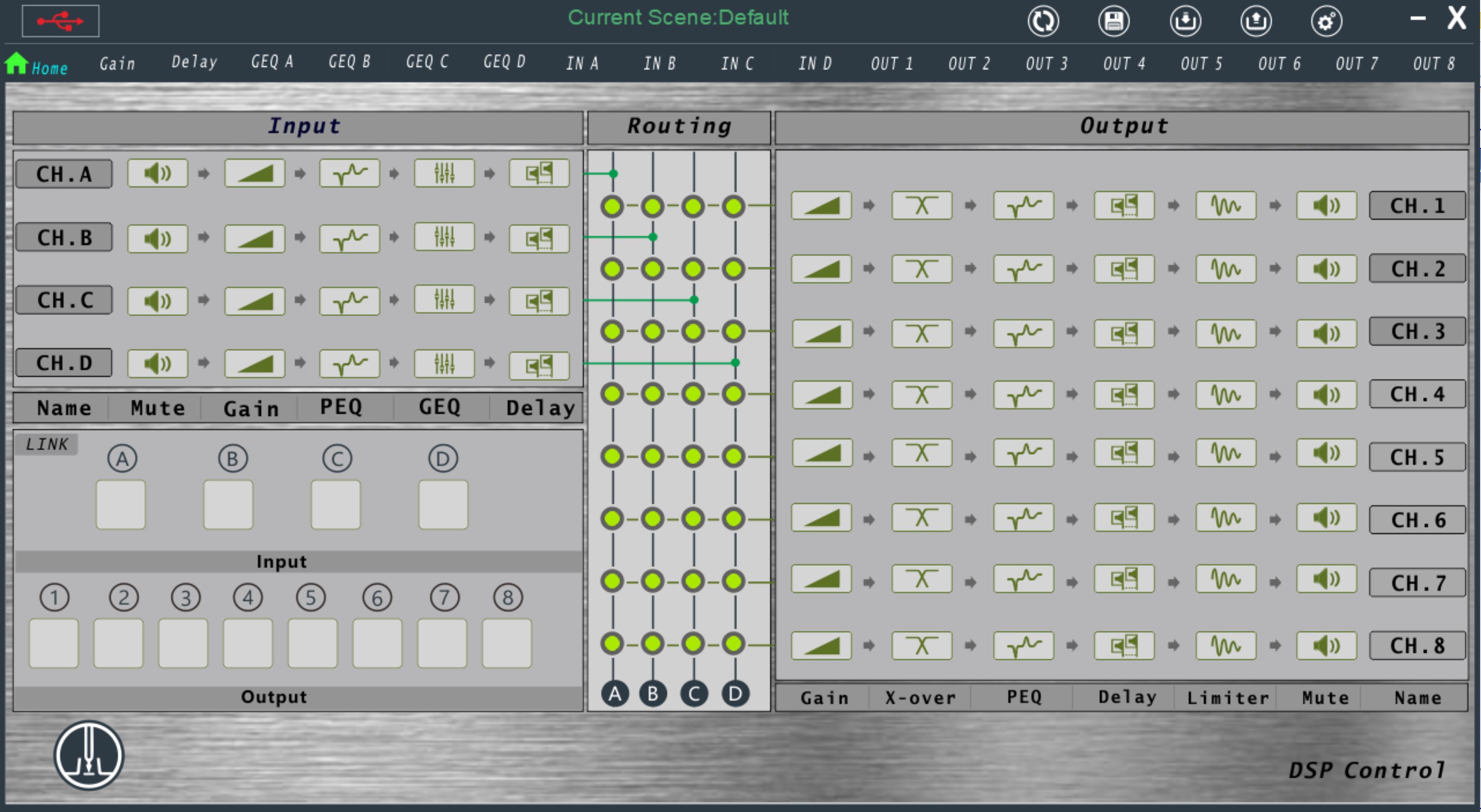

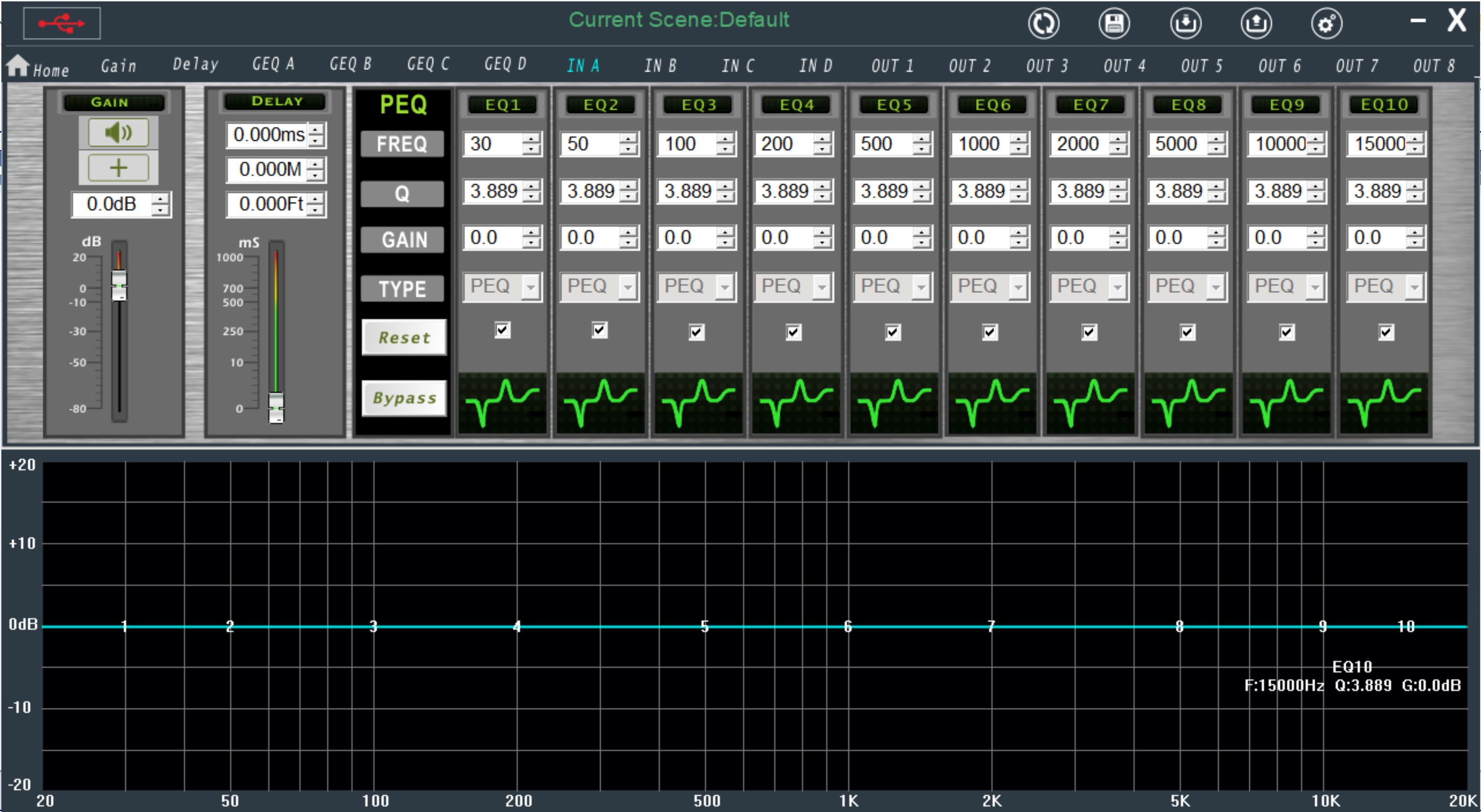

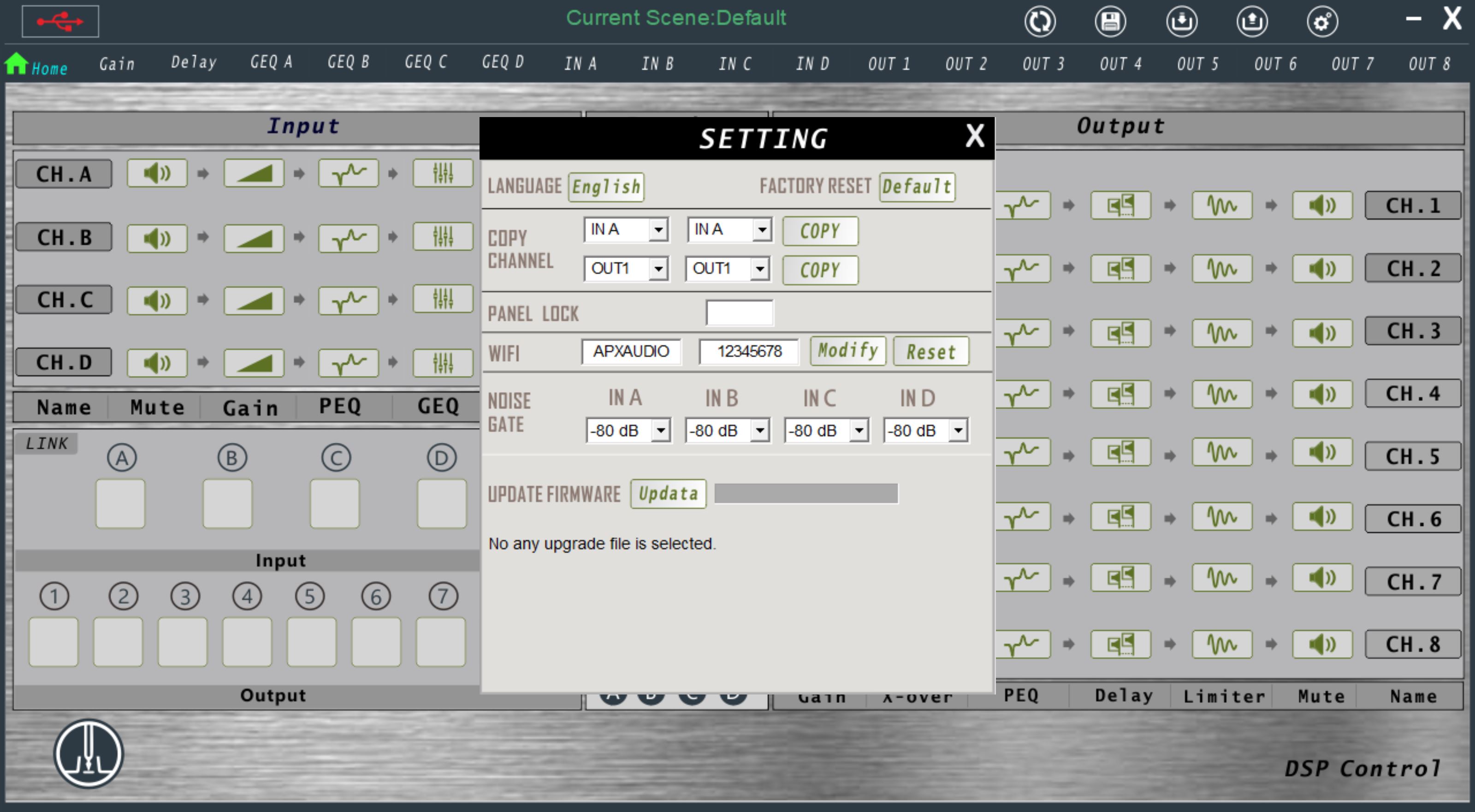

Thanks for your reply. I checked some of the files they sent me and tried the software, which it seems quite complete. Also, it seems that it is possible to switch to "Sigma Studio Mode" and also go back to the "Factory Software".
I leave some pictures of the software.
I requested more information on the specs, like output and input sensitivity, SNR, balanced or single ended, etc.
The board comes with 2 ADC boards (4 channels) and 3 DAC boards (6 channels) but it have space for another DAC board for a total of 8 channel output.

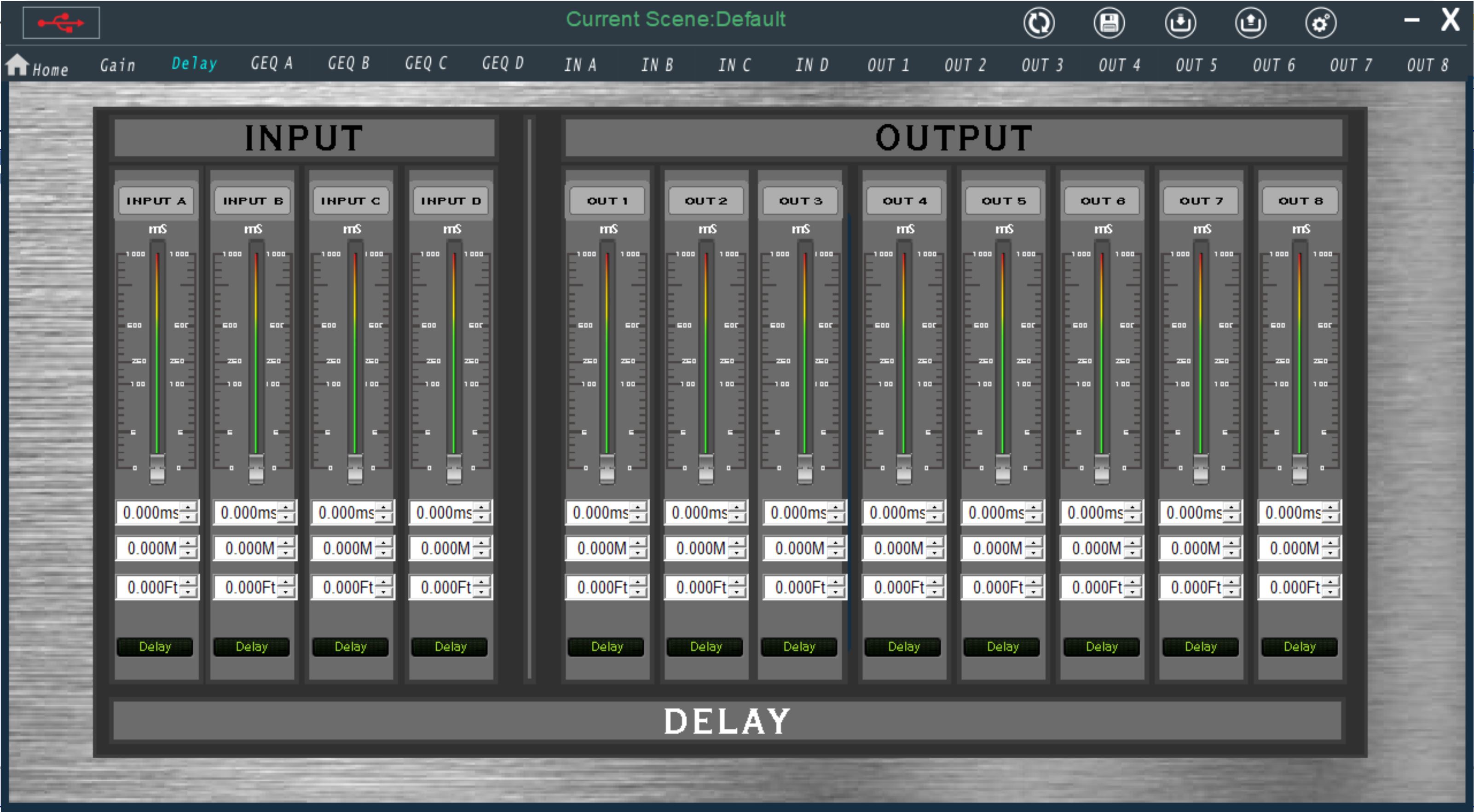

I forgot to mention that I could NOT find any way to input FIR filters on the factory APP. With this kind of processing power it is really a shame. You probably need to switch to Sigma Studio to integrate them.
Also, there is no way for phase shift the signal.
I'm not sure what you mean by "phase shift the signal", but you typically use a delay to change the phase relationship between drivers (e.g. to account for acoustic offset differences between drivers).
You are correct, but I thought sometimes DSP came with a more simple phase shift option, like the controls that generally comes with a powered subwoofer, to use when you dont have the proper measuring instruments.
In this case, only delay is available, and no possibility to implement FIR filters unless you switch to SIGMA STUDIO-compatible firmware. Also, the extra DAC board cost around USD$20 so you have a 4x8 last gen DSP for around USD$120, almost as twice as the ADAU1452 and trice as the ADAU1701.

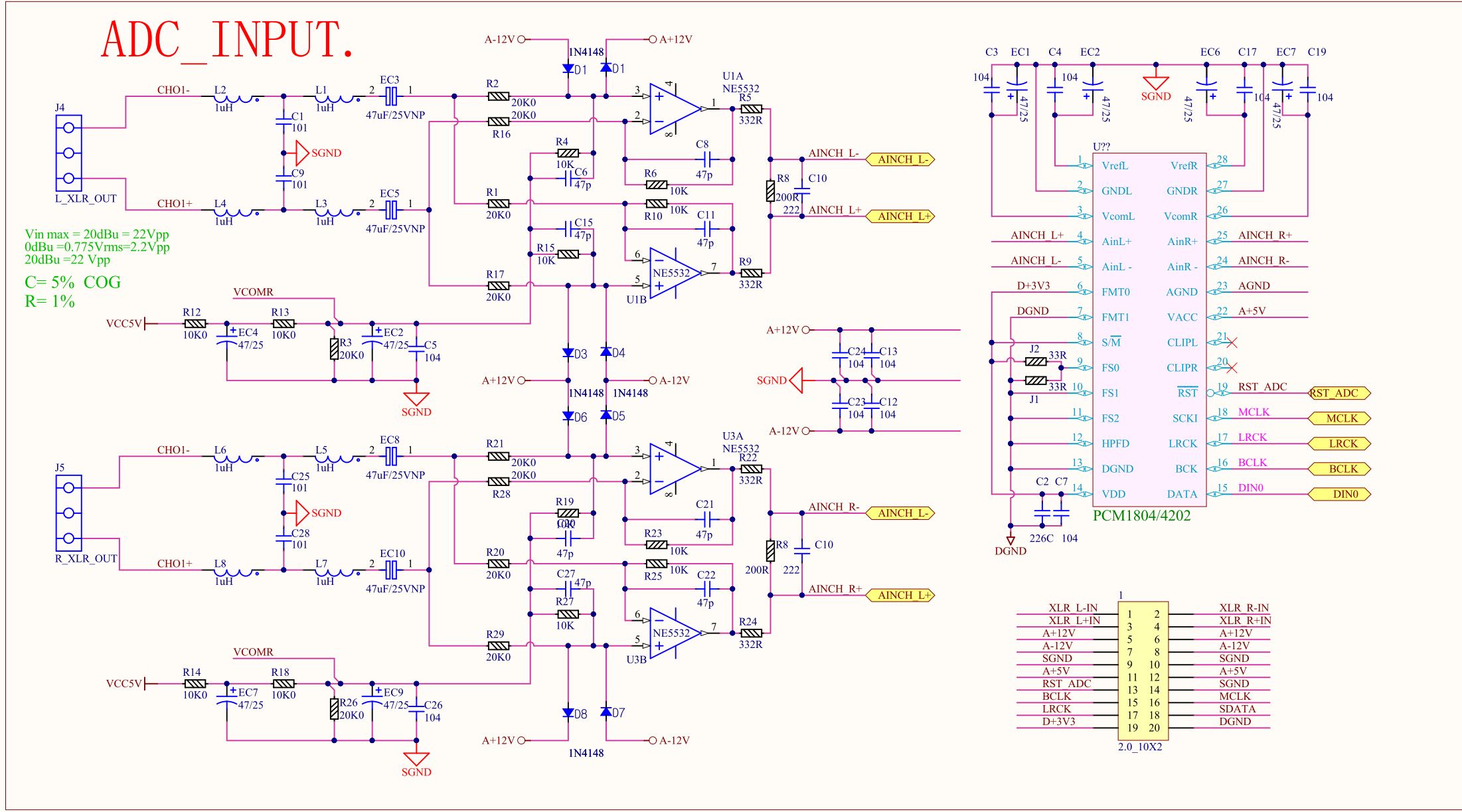

A bit hard to see on the pictures, but wondering if it could be they're using MC33078 op amps.
More concerned about the input boards, PCM1804 is not "bad" but they might be the weakest link here. Would rather have digital in. Seeing as the design is modular, and they do mention SPDIF and I2S, perhaps it would be possible to use this for DI?

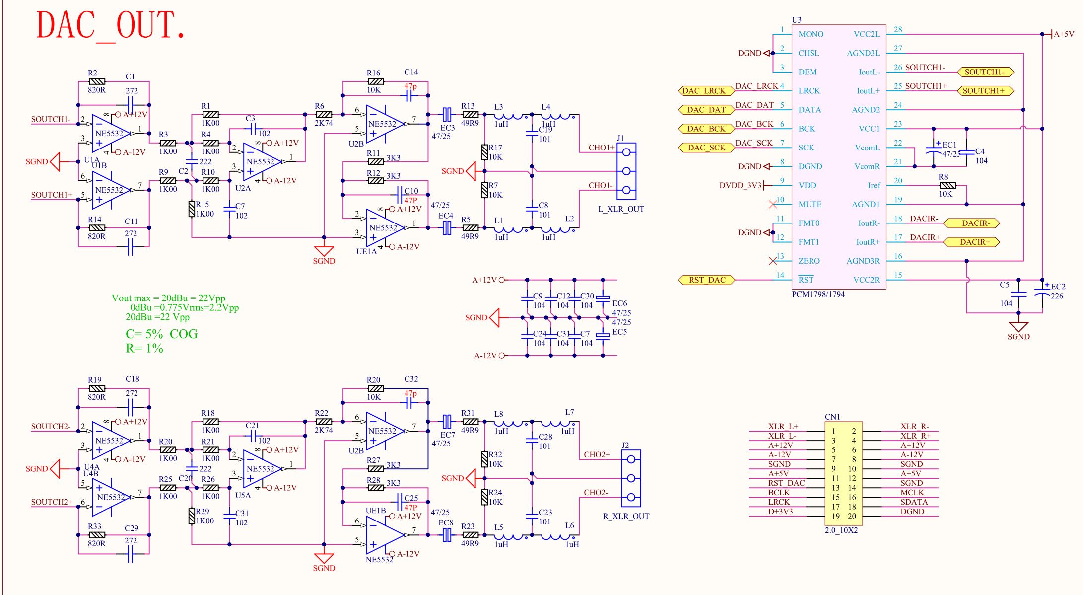

These are the schematics they sent me.
The thing is that my source is analog, in fact its the pre out of my receiver... from there y want to split the signal to go with active XO.
I think that if my source would be digital, specifically PC based, I would just process the audio with EqualizerAPO and rePhase.

Yeah, for the inputs the 5532's are a good match for the PCM1804.
Was just looking at the output boards and trying to decipher the bits on there. Wondering if they're using the MC33078 on the outputs.
