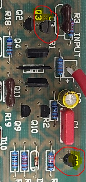

Looking at your picture, I highlighted two small transistors that appear to be cracked. Leads me to ask if you have you diode tested the transistors to see if any are shorted, measure faulty? That is where I would start.

that's the manufacturing marks, not cracked. this amp does not have protection. I've only ever dealt with output transistor replacement. I'm not familiar on low side drivers!
