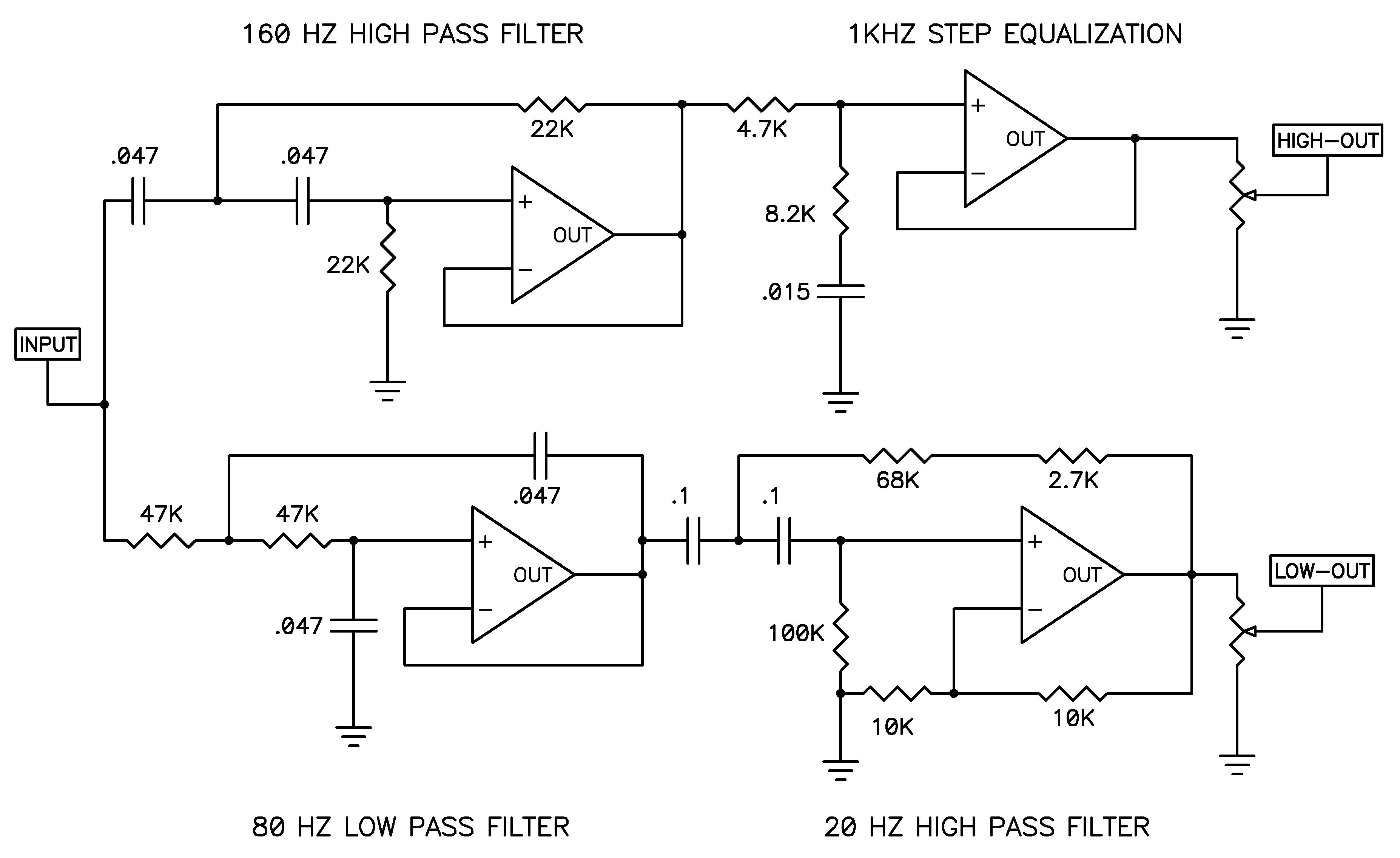

OP amp , drawn as in sch isn't symbol for OP amp , but buffer
The 20H high pass needs to be an op amp, or at least have some gain.
Nice jfet LTP driving bjt like in your op amp article would do nicely. Could double as a buffer if you make feedback 100%.
Thanks for diagram

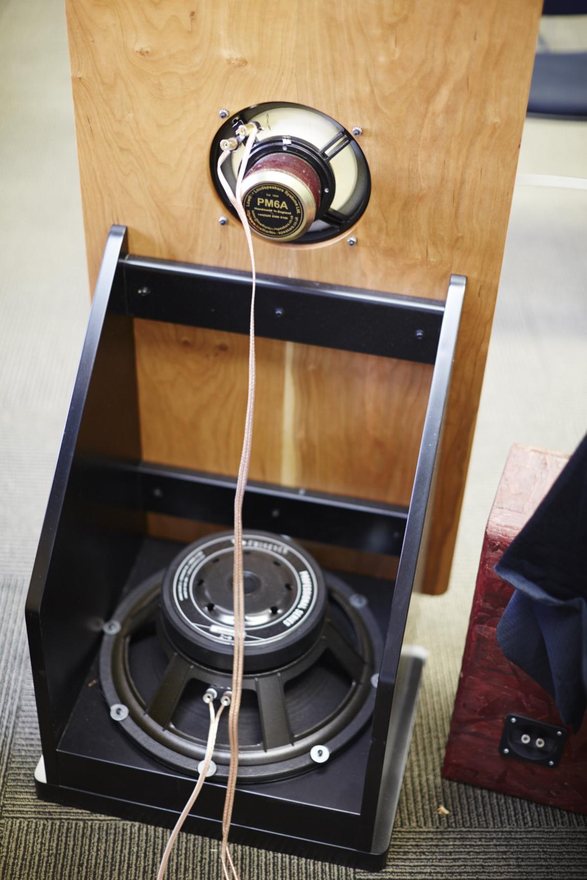

I had been reverse engineering the Open Baffle with bottom Slot Loaded Woofer from the picture. I got pretty close on most of the dimensions. I could not be sure about the rake, I thought there was, but was not sure.
I'm going to take some cardboard and do a size mock up to see if a pair would fit in my 9.5 x 14 foot room. My current speakers are 12 inch square.

Will be good to know the slot size... "Sd for the slot area 30% which Nelson Pass suggested"

It would be cool if someone can comment in the slot sound vs OB bass. I really like an OB bass, what are the advantages apart from sizes of the speaker...

Specifically, the difference between bi-amped baffle mounted woofer, and bi-amped slot loaded woofer. I am sure there is much better bass than with baffle mounted woofer with one amp and passive crossover.
H and slot baffle load the speaker with air this can lower the f3 5/10hz , second more compact the size rispect plain baffle ,trade off you lose some db for H or U baffle, for slot read http://www.diyaudio.com/forums/multi-way/195734-nelson-pass-slot-loaded-open-baffle-project-11.html

I heard the Pass speaker at BAF 2013 and was impressed. I have a question about "slot loading." From what I have read, including the SLOB article, it appears that the area of the slot opening should be about 1/3 of the area of the speaker cone. If I cut a round hole in a board with an area of about 1/3 that of the cone of my woofer, and mount the woofer behind that hole, have I effectively loaded the woofer in the same way as the woofer in the Pass speaker? I realize that the absence of "floor bounce" might affect the sound, but otherwise does this subject the woofer to the same conditions?
Interestingly, I tried that experiment, and it did not work as well. It appears
that the slot arrangement as shown imparts more directionality to the
momentum of the air, and puts more pressure toward a listener in front of
the speaker.
