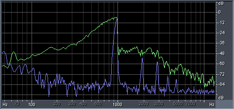

Continuing with burst testing, the brick wall 1kHz low pass test signal is filtered with Linkwitz-Riley 1kHz 24dB/Oct high pass, and also with 1kHz 1024 point FFT. Equal normalization is done to both and a response recording is made. Referencing for displayed results is -6dB at just below 1kHz for LR4 response:
The LR4 high pass crossover filter results in generation of harmonic distortion and intermodulation distortion components, and in reality extend <1kHz. All of these show up as sum and difference side bands to desired pass band components.
FIR crossover results in lower level, well defined harmonic distortion generation.
The difference when crossover is implemented with LR4 v 1024 point FIR for my Pluto type speaker is night and day. Transient performance is truly cleaner. Sustained high levels are truly cleaner.

Barleywater,Some details:
Square driver flange is milled round for mounting into end of 2" ID PVC pipe that is 12" long. Pipe is stuffed with Dacron, and other end is left open.
From recorded terminal voltage peaks (+/-) at center of waveform, -3.4dB is seen, corresponding to +/- 60.37 volts. Extrapolating this as true sine, this is divided by 2^0.5 for RMS voltage of 42.69 volts. Squaring this and dividing by 4ohms yields power of 456 watts.
I did not reference acoustic response for 1watt input, but driver specification is 82dB/1watt. This is horrible compromise made for size, cost, and intended applications. Nonetheless, at 388 watts this is 2^8.6 over 1watt or 6dB x 8.6 + 82db = 133dB estimated SPL.
I don't own any compression drivers, but have down loaded mp3 results from your previously posted links, and what I see is not impressive for domestic settings/critical listening, and is stock and trade performance for PA sound.
The maximal voltage swing is –46v to 60v. Sound is short, loud, and produces sensation similar to slapping palm of hand against ear. Ouch.

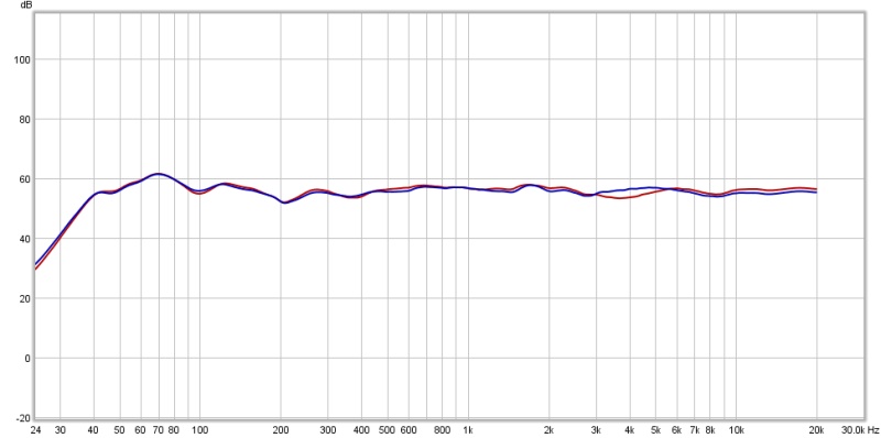

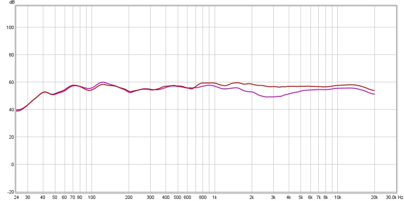

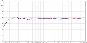

In case anyone is interested, here are a couple of basic measurements of speakers before and after conversion to active (passing cables in through the ports!). My regret is that I didn't do anything to measure the insertion loss of the passive crossover. I'll do it when I convert them back.
In both cases the measurement is of a single speaker at about 1m in the listening room, traces averaged with 1/3 octave smoothing, using Room EQ Wizard and a WM61a mic with cal file off the WWW. The active crossover is your basic Butterworth-style linear phase done by a PC, without any phase or delay tweaking of any kind. 'Voicing' was highly involved and took almost 5 minutes. (I merely set the amp volume controls to get similar-ish traces between passive/active.)
The B&W DS2, is a two way, and I used an active crossover frequency of 2800 Hz 6th order. Passive is the red trace, and active the blue. Not a lot of difference!
The Tannoy R2 is a three way, and I used active crossover frequencies of 200 Hz and 2800 Hz, both 9th order. Passive is the magenta trace and red the active.
I've had a bit of a speaker-measuring, tweaking and listening binge this last couple of days, including writing my own software to correct individual drivers in various ways. What seems clear is that the basic character of the speaker comes through the passive-to-active conversion, and that a flat frequency and phase response does nothing to help a truly crap speaker!
Anyway, the Tannoys are sounding rather wonderful, now.

1/3 octave smoothing is not revealing, and graph scale is tiny. What of reverse null response of crossovers? And what forms of waveform temporal distortions are revealed with burst testing? Distortion?
Phase response of your DSP crossovers may be flat, but what does REW show for acoustic response? Phase mayhem starts with coupling capacitors, including active capacitance of speaker diaphragms along with capacitors found in coupling between amplifier stages, as well voice coil behavior.
