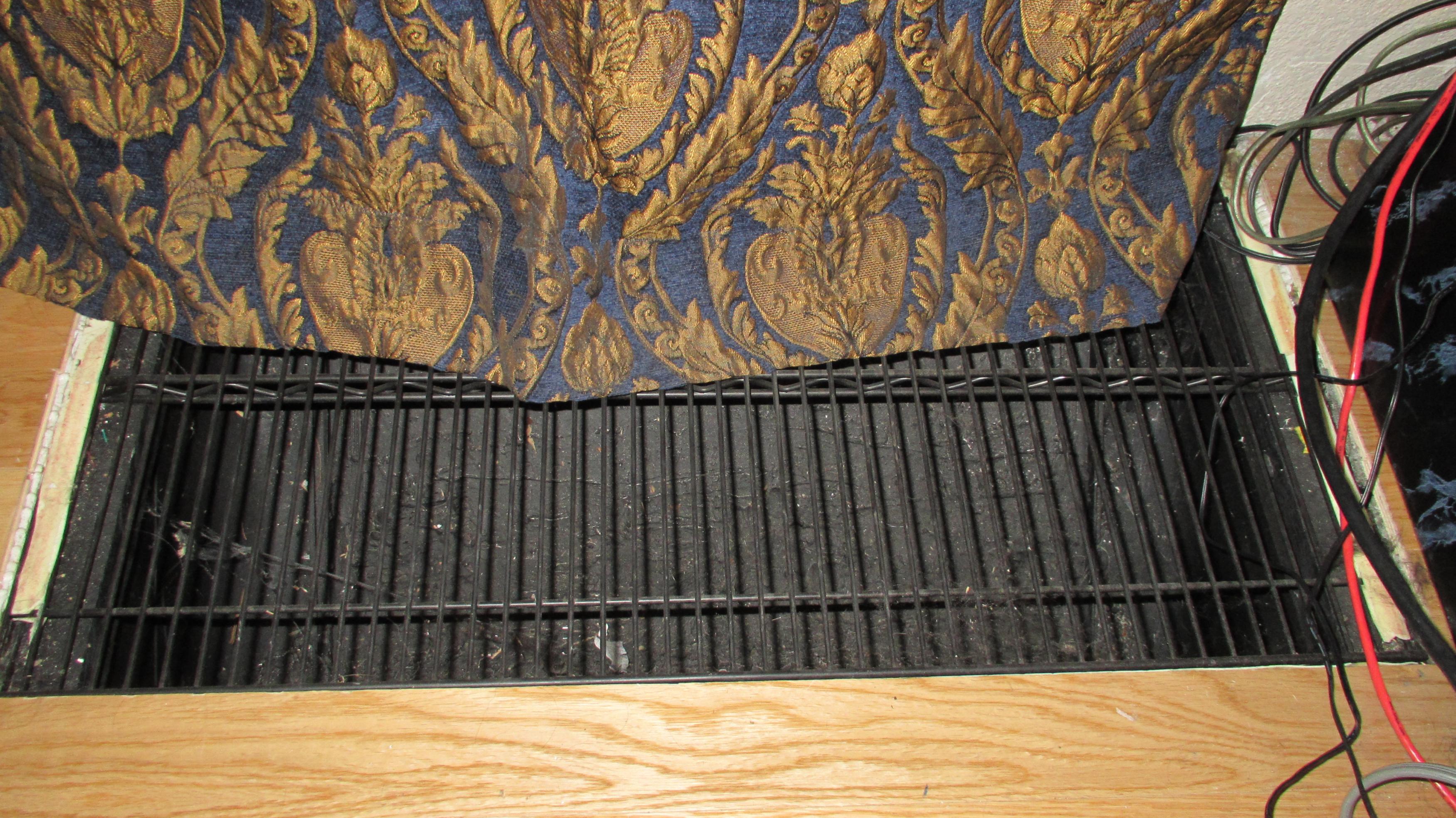

...this one is active, my concrete horn subwoofer under the floor. Though, it's passive prototype was pictured on my previous message. 😀
But this "active" thingy sounds much more natural than that "passive" and organic one. 😀
