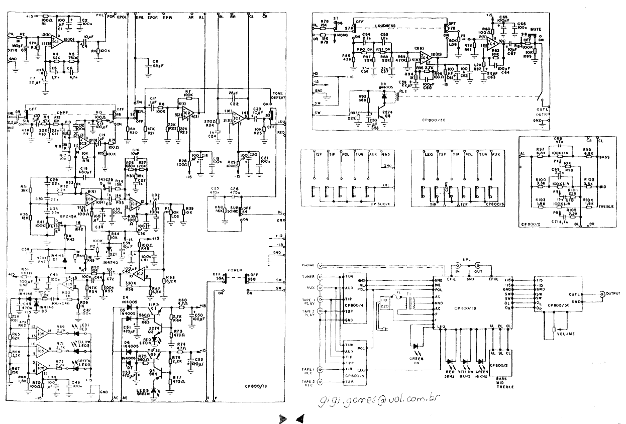

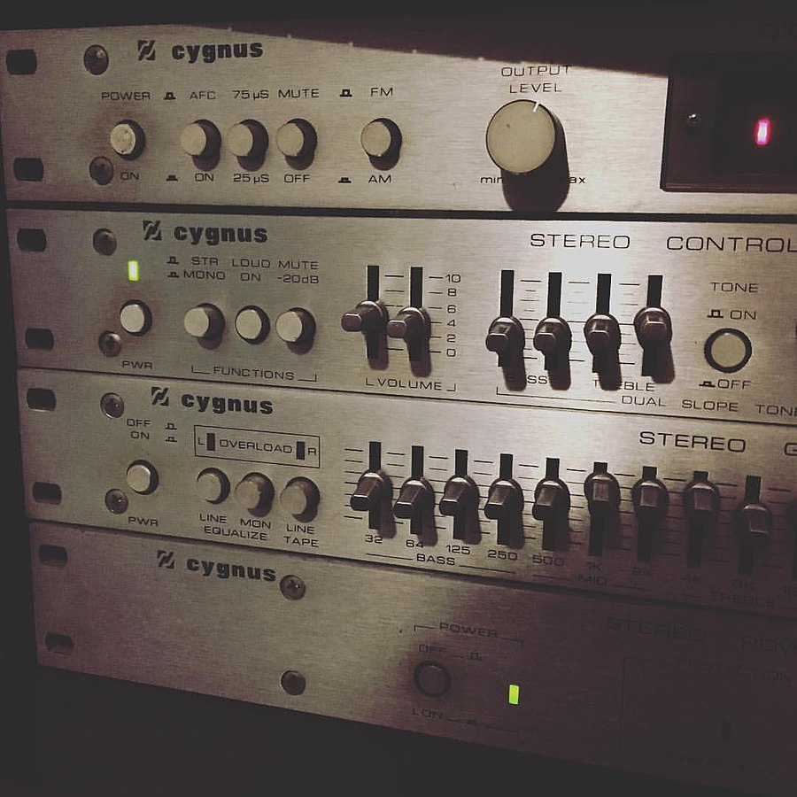

How did we get this far without saying WHAT this preamp is? The more we know the fewer wrong guesses we make.
At first I wondered if this thing was even worth working on. Dual SHORT sliders is, as you say, very un-friendly to the user. It reminds me of very cheap mass-market junk.
Well, it turns out this is part of the Cygnus "system". Tuner, preamp, EQ, power amp.
YouTube
File:Cygnus 400 series audio set - TU-800 Digital AM-FM Stereo Tuner, CP-400 Stereo Control Preamplifier, GE-400 Stereo Graphic Equalizer, PA-400 Stereo Power Amplifier - left half (2015-09-26 by .v1ctor Casale.).jpg - Wikimedia Commons
And Electrotanya has a schematic.
And it is really a pretty sophisticated box of audio, with good basic design (and many frills).
In particular: it has "EPL", external processor loop. Put your ganged stereo pot on this loop. A 50k pot will work fine. (Active is not magic.) And this is absolutely the least effort and least chance of trouble. If you don't like it, switch EPL off and unplug it.
The stock volume control is a little further on and IS a 50k passive potentiometer with a buffer/gain-stage behind it. If you wanted to saw and weld a plate to hold a nice ALPS rotary pot, it would wire the same way.
