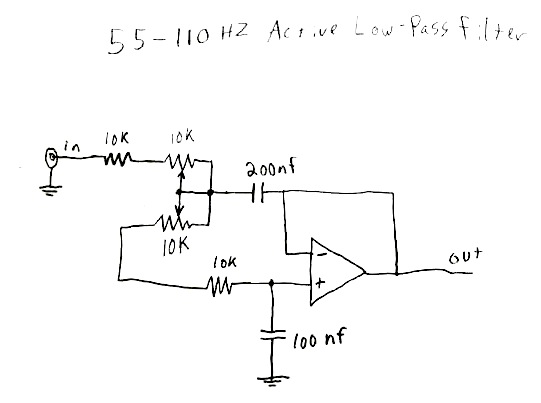

Active variable Low-Pass Filter 55-110 Hz
Did a little tinkering with a calculator and came up with this schematic based on it.. Based on the calculator it should work, Thoughts?
This should provide a variable selection of 55-110Hz if it works right. The pot is a 10k Dual Linear.
Reference: Pronine Electronics Design - Sallen-Key Active Low Pass Filter Calculator
I have a MC1458P dual OP-Amp laying around that I could use. Do you think that would be an OK part to use?

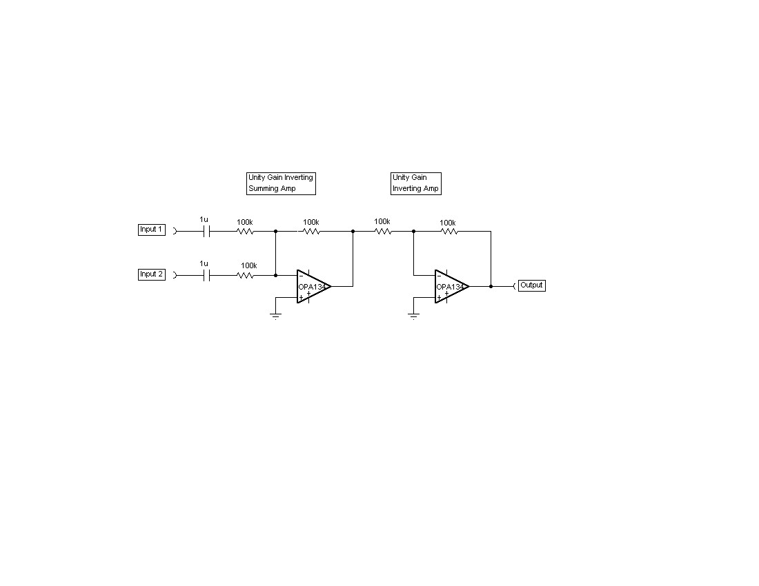

Last question.. Does anyone have a reference to a simple way to mix L and R channels for a mono subwoofer application and still keep them isolated?

As for the summing amp, I can see how it would combine the signals but will any of the sound from say the left just go through both resistors and back out the right? The signal going into the combiner/mixer also connects to a stereo amplifier to do everything above 80Hz or so. Maybe so little would get back that it wouldn't be noticeable, but thats why I'm asking. 😀
No, there is no feed-through from one output back to the other. Due to the way opamp feedback works and because the non-inverting input is grounded, the junction where the input resistors and the feedback resistor meet at the inverting input is a virtual ground. Therefore anything connected to one input is totally isolated from anything connected to the other input.
Mike
That would be a good choice for this application. You can eliminate one of the opamps by not using the second stage inverting amplifier and simply connecting the sub-woofer to the amp with the terminals reversed, that will "un-invert" the signal and achieve the same thing. You might want to post your final design here before you build it to make sure it's alright.
