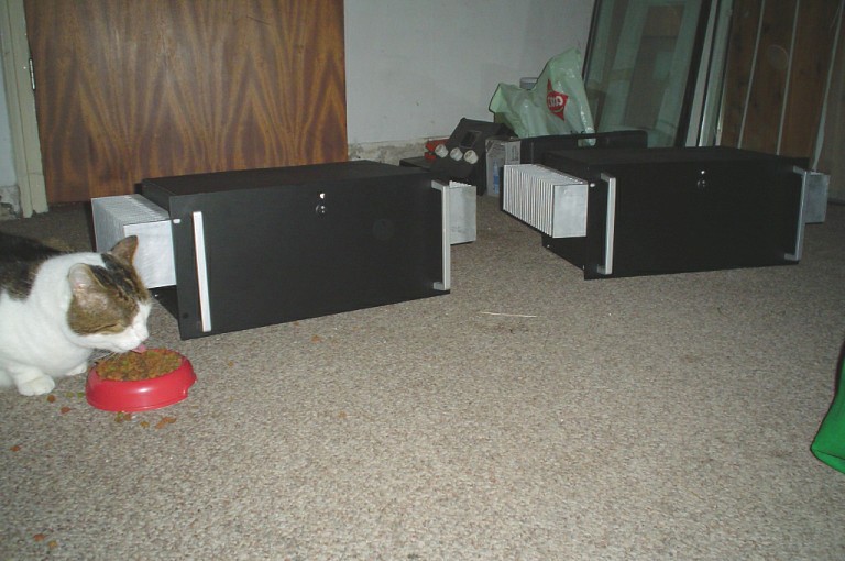

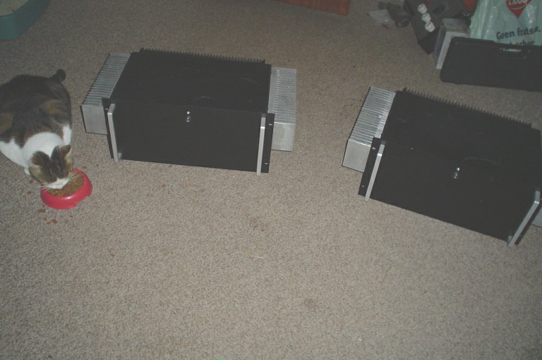

Yes!!! they are finished!!
Had a lot of trouble with groundloops (after closing the case) because 4 toroids were used in one amp. Also had some mechanical hum because I placed a big copper plate on the 4 toroid-bolts, wrong!! The groundplate and two bolts and the copperplate work as one dead winding (on each toroid) so a lot of energy is used to heat up the bolt
and move everything up and down (hummm😎 )
But now there is perfect silence
Measured 800 Watt total so no big issue on that one.
Total costs; around 950 euro
here is a picture

Gefeliciteerd, Aaron.
They look like grand cat heaters, your pet will have a ball this winter.
For the obvious reasons i am very anxious for you to plug 'm in and give me(sorry, us) the verbal description.

Dank je Jacco!
I thing a real good desciption of the complete set will take a while.
The active-filter/preamp is next and then the speakers themselfs.
Maybe I will test them on a friends passive high-end speakers this weekend although a very nice lady will keep me busy this sunday (sounds nice too doesn't it?😀 pardon the pun 🙄 )

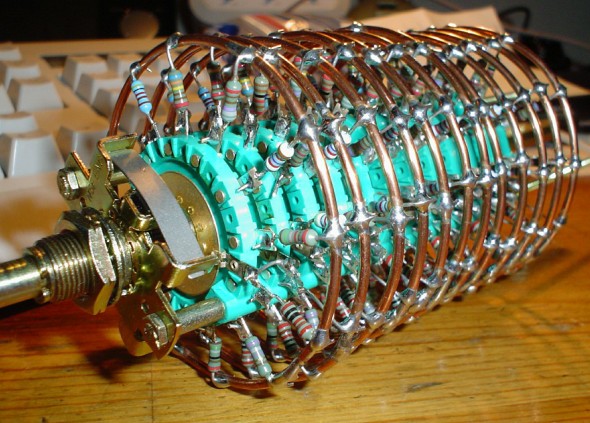

Thats a lot of decks, Aaronboumans😀 Great work🙂 I see some Phillips resistors in there, I hope the rest are BC's? BC took over the Phillips production😀
Steen😎
Steen😎
Thanks steenoe,
Yes I believe they are philips or vishay metal resistors? Dunno for shure , dunno if it is really significant?
